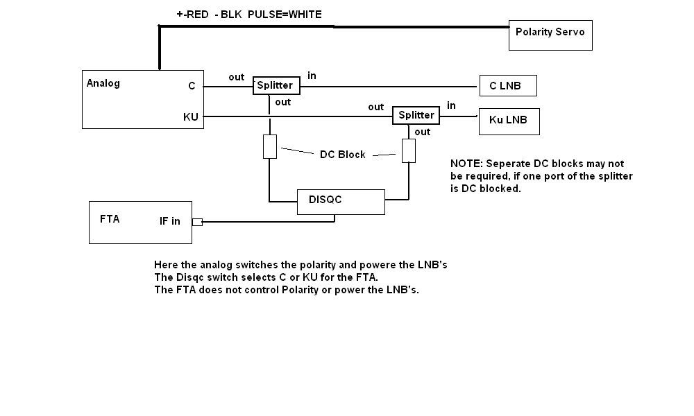

Could you draw a diagram of how your system is wired, and attach it to your next post? Connections of your disqc, fta/ analog receiver/lnb's. Use MSPaint for this. (Save As: jpg or jpeg) There is something funny going on here because if you can get Classic Arts analog sparkle free, you should have no problem getting it via FTA/Digital. see attached of a typical setup using basically what you have there.
Brain storm here- - what kind of feed LNB setup was on your previous dish? Was it a C/Ku setup, or was it two C band lnb's?

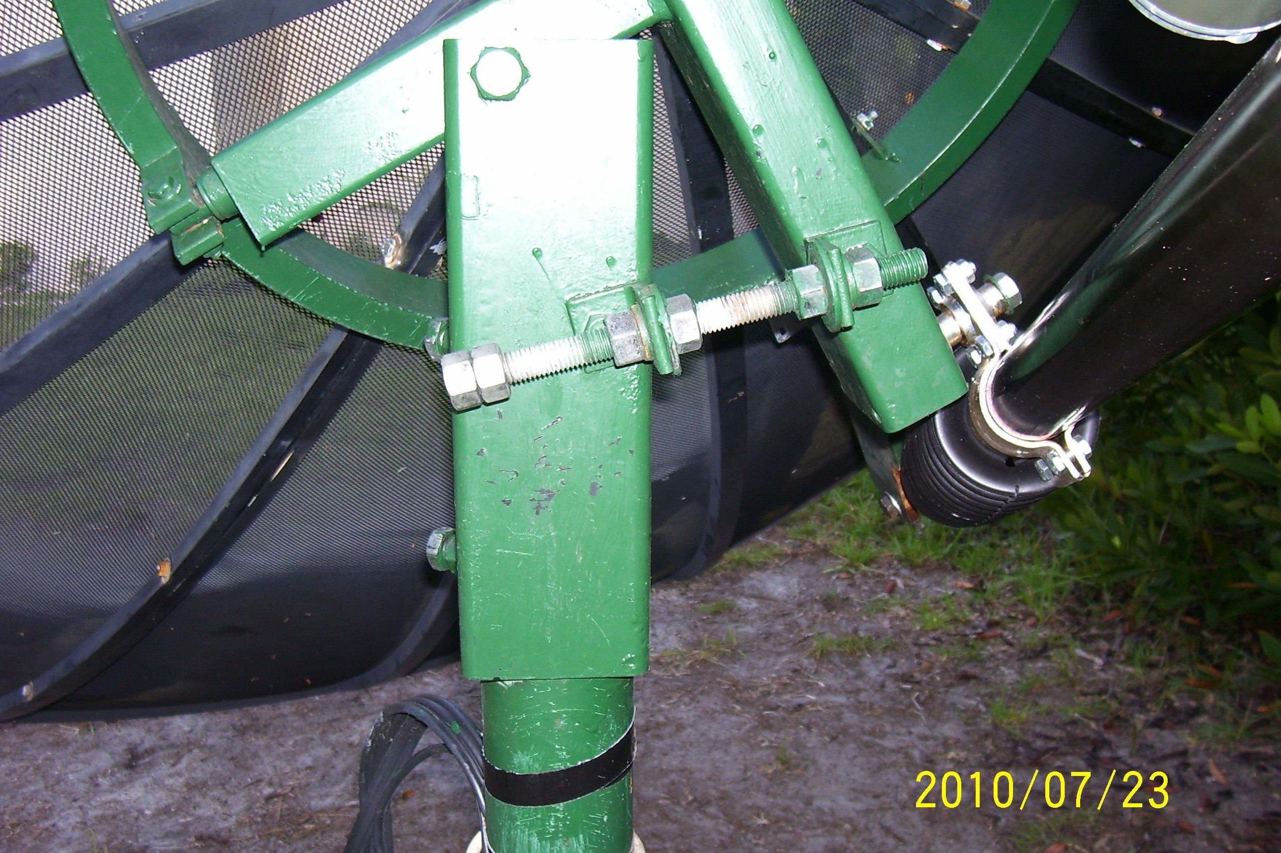

the bolts to change the Azmuth I noticed the face of the dish dropping.
When I got the Classic Arts Showcase tuned in nicely, I tightened the
bolts and don't you know the face of the dish raised. This is what's causing
my problem IMHO. The round pole with a SQUARE mount. Makes for very
difficult adjustment. To difficult for me.
Solution (there are 2 that I can think of) more ideas are welcome.
1. Most expensive - junk dish, buy new one with round mount.
2. Take the dish down and cut the pole so that a sleeve of about 20" or so
will fit over the bottom pole and over the end of the top part. Have holes drilled
and threaded for the Azmuth bolts. Might have to drill a hole at the bottom
part to keep it from sliding to the ground. Then I will have a round pole
and a round sleeve. Leave the original one tightened and never touch it.
Making the sleeve the full length of the pole minus the square part of the mount
would give more stability and could be supported on the concrete.
I wouldnt go with getting a new dish!it looks fine to me.what you can do is look for a new polar mount that would fit your dish and fit snug over the round base pole.These days v or g boxes are cheap!May be a good idea to upgrade and get rid of that rats nest of wires you now have.
My polar mount is also square, on a round pole. If I were to really loosen my azimuth bolts, it would sag probably 3 to 5 degrees. When i loosen it to adjust azimuth, I only loosen the bolts maybe 1 turn from tight. It's still fairly snug, and only drops a fraction of a degree, but a bump on the edge of the dish will move it that 1/2 degree east or west to see if Q is affected. I leave it that snug, at the end of the arc, so that while driving the dish with the actuator, to look for a Q improvement, it doesn't move the polar azimuth(rotation).
Because you said that you had Classic Arts sparkle free, but nothing when you tried FTA/digital, tells me there is something amiss in your switching set-up. I do believe you didn't do anything at the dish when that was tried in your earlier post. That said -
I would be very helpful to know how your system is wired, to know how H/V and C/Ku switching and selection is accomplished. I think it may point to an obvious thing to check.

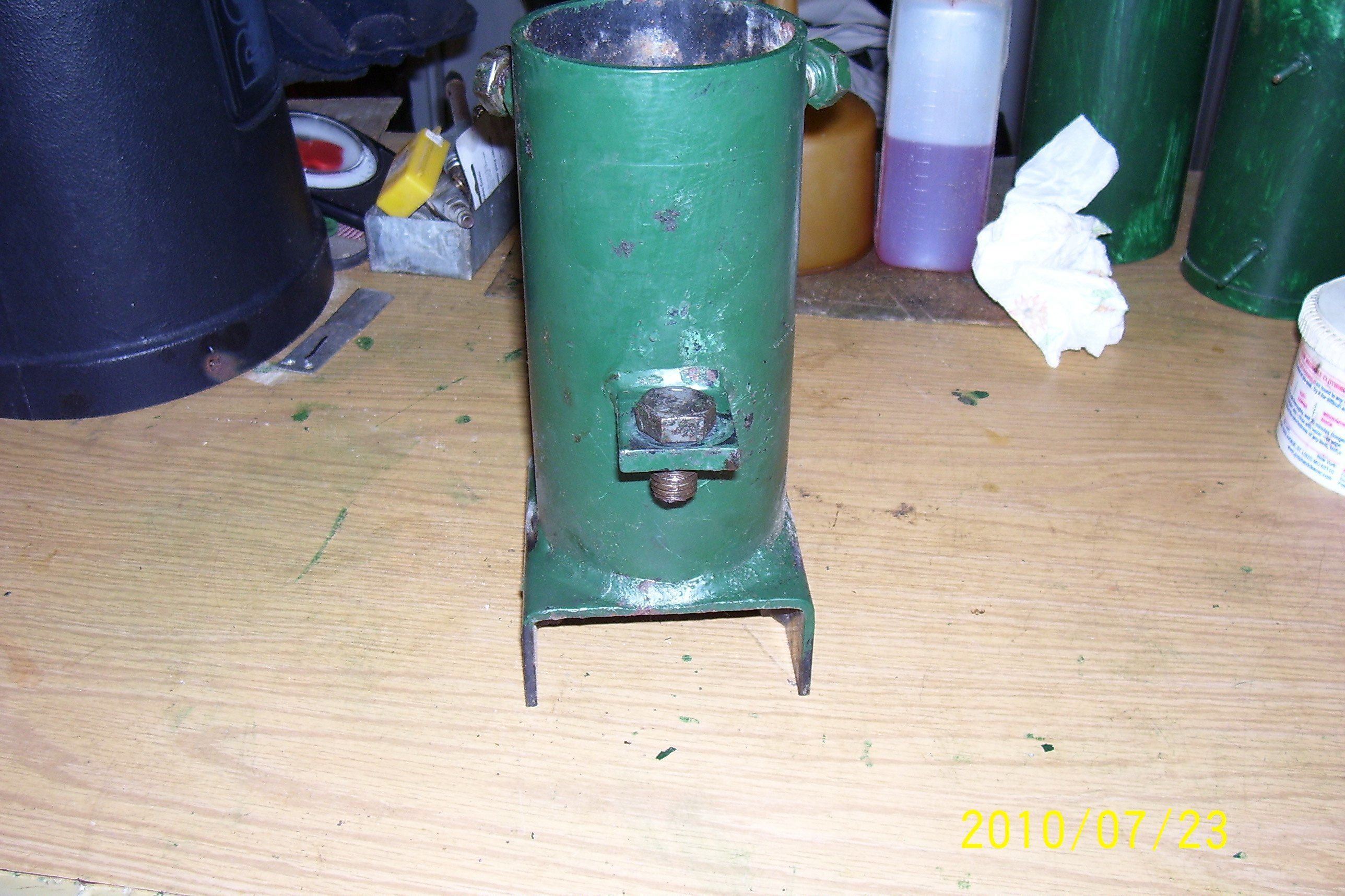

1. I have the polar mount from the dish that was destroyed.
It was an Orbitron and had a round polar mount. Why not weld a 1/2 inch
plate on the bottom of the square polar mount and weld the round part to it from the Orbitron?

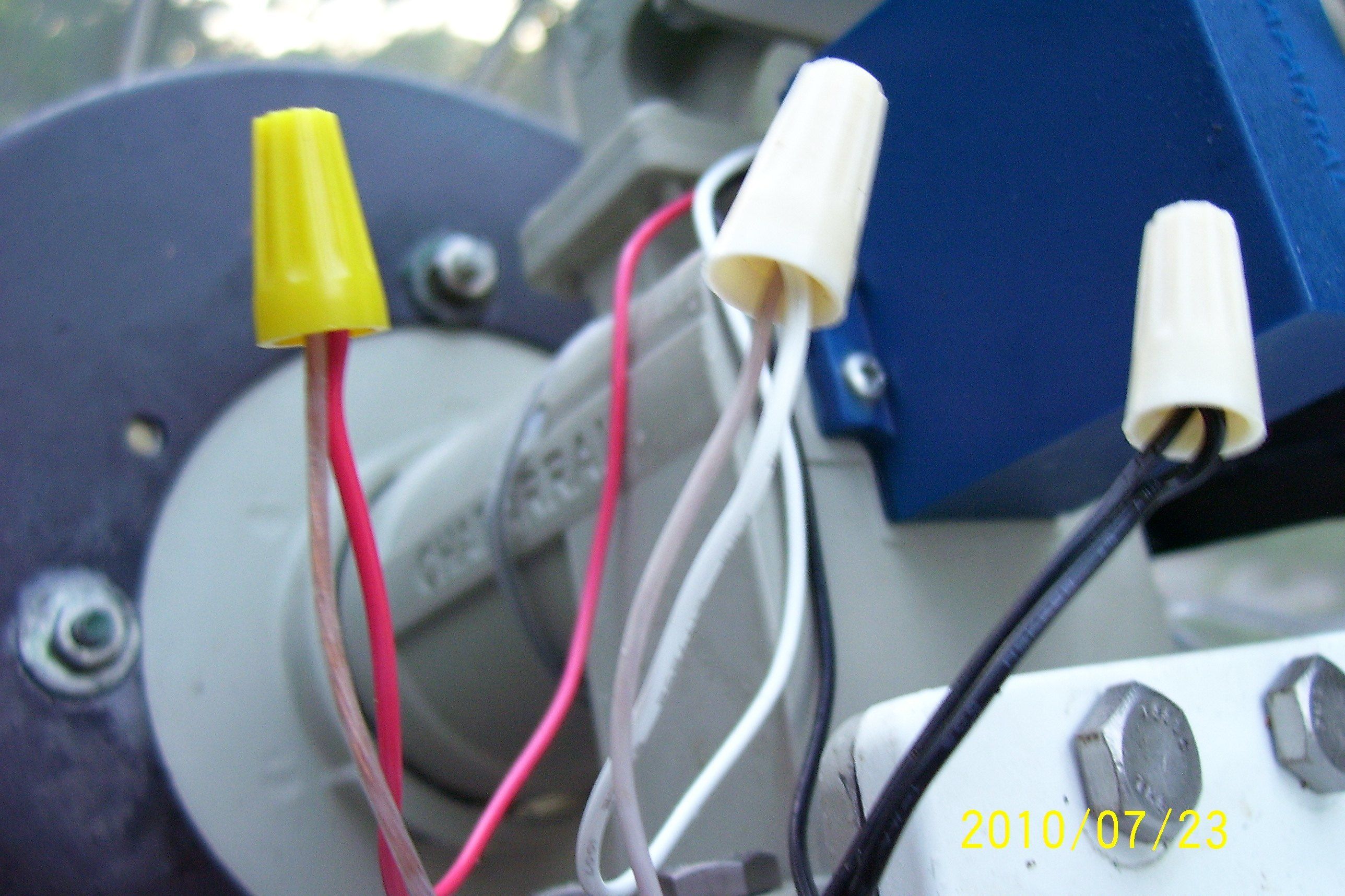

2. Like I said I haven't touched the wires inside the house. However I
had to connect the wires from the blue box on the Chaparral Corotor
ll Plus. The colors were different and the directions from Chaparral
were bad. Might have it wired wrong.
I will send pictures of the wires on the Chaparral feedhorn when the
sun comes up.

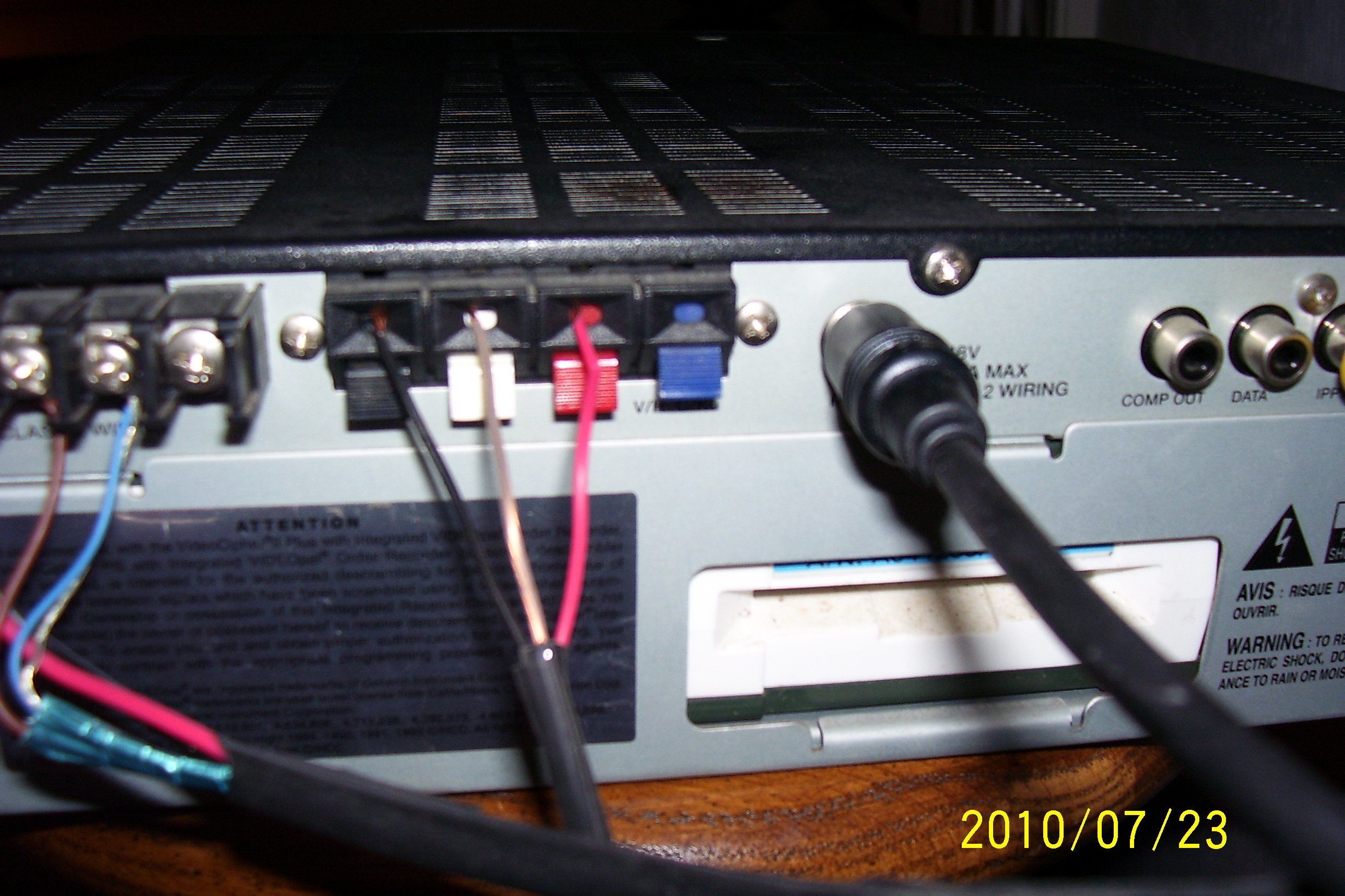

Here are the pictures I promised from the previous mesg.
one is of the back of the Uniden that connects to the blus box on the Chaparral Corotor ll PLus.
Another is of the wires and they seem to be done right.
Another is of the piece from the Orbitron that I might be able to use on
the bottom of the square mount.

On that last pic i can see how it might be a pain when making adjustments!Mine is round to round and even with that when i tighten the bolts it can effect the Q somewhat.The secret is to tighten each bolt alittle at a time!not one at a time.Sounds like you got some good ideas on what to do next.Catch you later!hope its a good day.

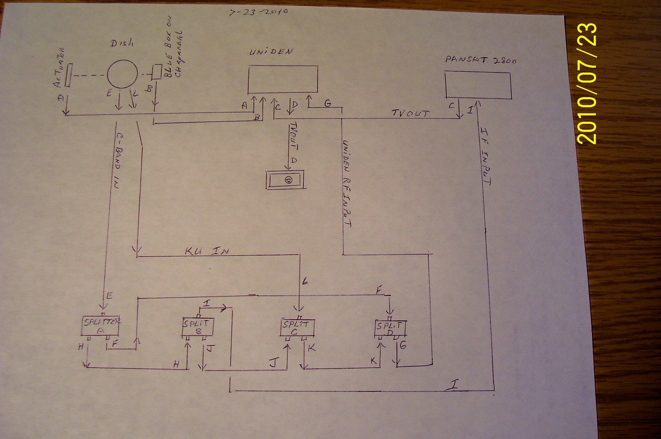

To FaT Air,
Here is the diagram of my wiring that you requested:
See Attached diagram
A. - Actuator motor & Sensors
B. - Grnd, Pulse, Dc6v from the Chaparral Corotor ll Plus
C. - from the Pansat 2800 to the Uniden Ant IN
D. - from the Uniden TV OUT to the Television
E. - C-Band IN to Splitter A
F. - Splitter A to Splitter D
G. - Splitter D to Uniden RF INPUT
H. - Splitter A to Splitter B
I. - Splitter B to Pansat 2800 IF INPUT
J. - Splitter B to Splitter C
K. - Splitter C to Splitter D
L. - KU IN to Splitter C
I may be wrong but i think you would do better using a v box instead of that Uniden!since you say that you use that for moving the dish only.Every time you go threw a splitter you can expect some signal loss and it looks like your doing alot of splitting.You can get a 2x1 Diseqc 22k switch to go from c to ku and a v box can be bought for under $50.Less wires,less sig loss due to no more splitters.Im sure the way you have it did work in the past but i think a upgrade will give you better results.
Update!I know electronics but this satellite stuff is still new to me.What is the blue box on the LNB used for? Power?? If so looks like 6 v which would require a power source not from the receiver or v box and throw all i said above out the window:(

I'm really tempted to dismantle the dish and have the part welded to the base
of the polar mount. As a side benefit it would get me about 12" more off the ground. Also I can then center the feedhorn more accurately with the guy wires
from the ground. Paint a few bolts and pretty it up a bit.
