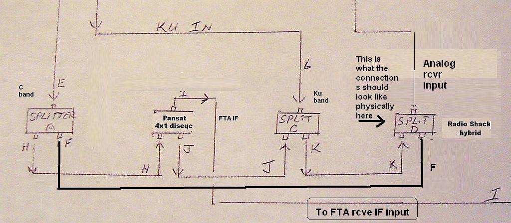

Are the, what you have labeled as splitters, just splitters, and not disqc or 22khz switches? Any ID numbers on them?

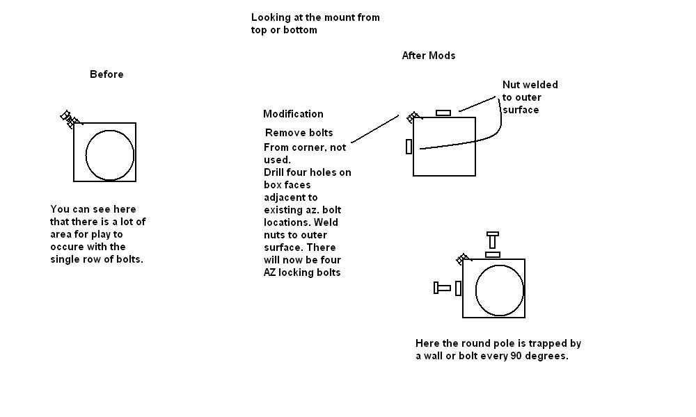

On the square az mount, are there only 2 bolts at the corner of the "box"?
If so, I/ve seen that before, and yes, troublesome, But then, I have to draw something for your mount. Quick and EZ fix I've done on a couple. Just requires a trip to the welding shop.
shankle, are, what you have labeled, splitters, just that, and not some other sort of switch? any numbers to ID them?
As for the mount, If that is just 2 AZ locking bolts on athe "corner" of that mount, I feel your pain. They do wobble excessively when loosened. BUT there is a Quick and EZ fix. I've done it on a few. Just requires a trip to the welding shop. See the attached.

Now I'm just asking not questioning. I have a round item shown in a previous
post from an old Orbitron. It only needs one hole bored in it and welded to the existing mount. Is your method better, easier or less expensive? Or are both about the same?
The AZ locking bolts in the current mount are in the corner on the same side. Two of them.
Splitters -
splitter A is made in China and is only labeled with a number.
splitter B is a Pansat 4x1 diseqc switch super mini.
splitter C is made in China and is only labeled with a number.
splitter D a Radio Shack hybrid splitter combination.
The only concern I have about welding the orb mount to this one is, are you going to be able to keep everything straight? Because if an angle is introduced, it could cause pains in alignment.
Another way, Could the orb mount be modified to accept your present polar pivot piece?
Thank You for the splitter info, I will look over the wiring, but will have to leave for work soon, and may not be back here till around noon tomorrow. I think you'll be busy with that mount till then anyway.

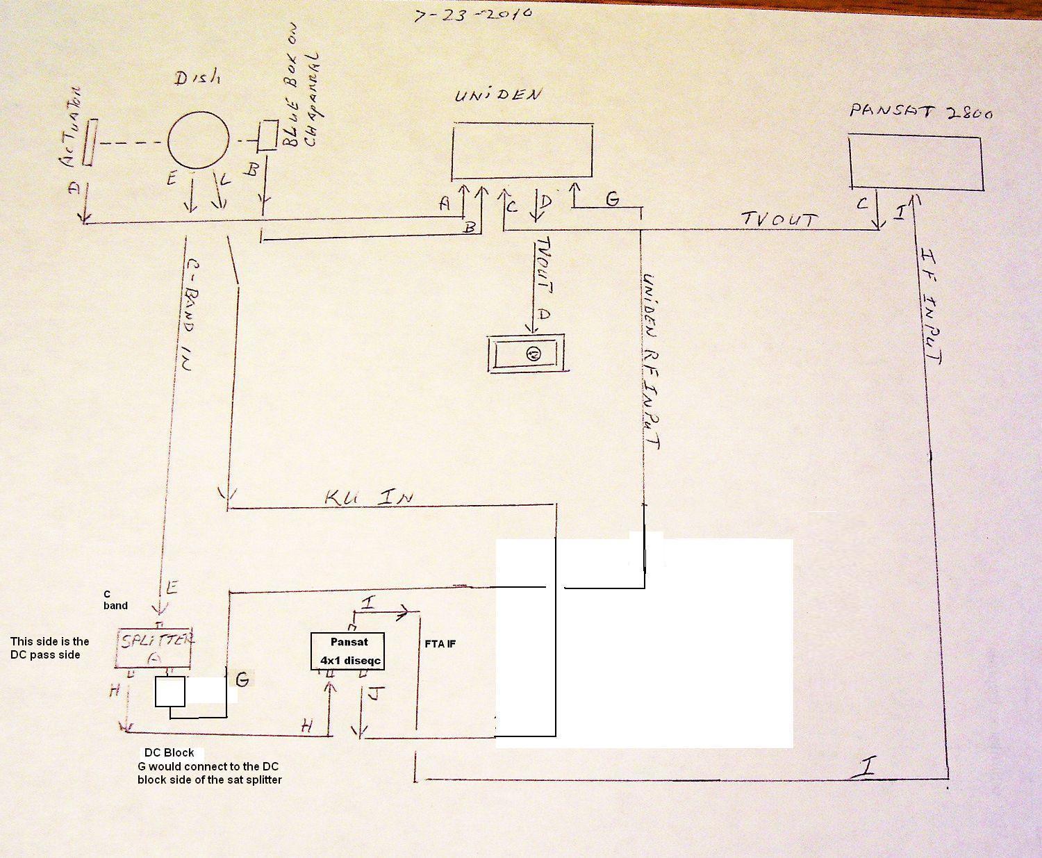

Ok, I think 2 wires got interchnaged- see attached. Then another Question, How did you accomplish C - Ku selection with the analog receiver? I don't see it possible as wired.

Thank you FaT Air,
Back when I got the Uniden Receiver I had a 12' Paraclipse.
The mount wore out and I had to junk it. Of course it was only C-band.
I never used the Uniden to get ku Analog.
The next dish was the Orbitron which was C/KU.
That's when I got the 2 Norsat LNBs. Ku was never very good and the Q was always zero.
I guess you want me to change F and G on splitter D.
It's done.
Don't know when I can get to a welding shop. It might not be until Monday.

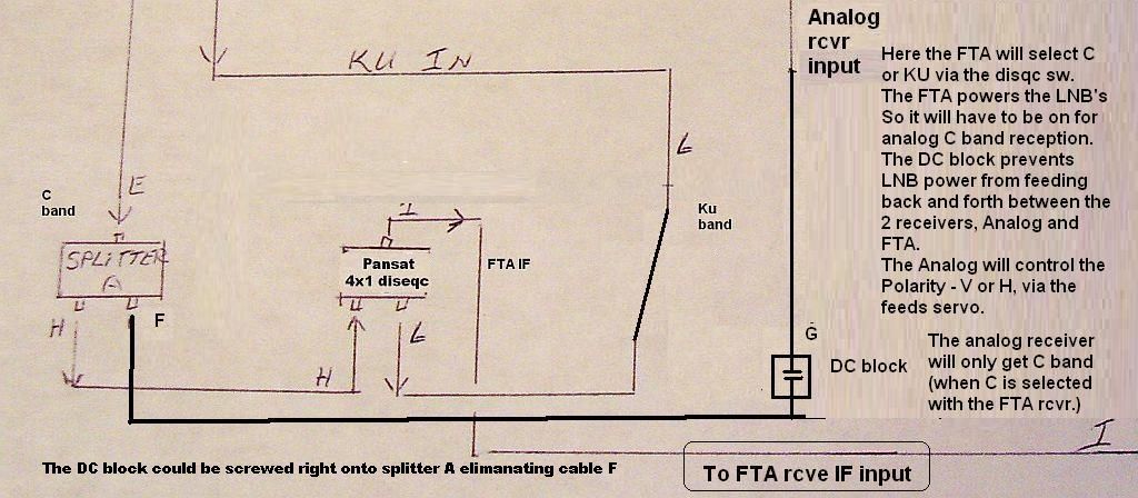

Till then, take a look at a simplified diagram that will work. It uses 2 less splitters, therefore we don't have the associated loss of signal. Which could be 10db or more per splitter. This alone could be a factor with the zero Q. The 2800 will select C-Ku via Disqc (analog on C band will be active while the FTA selects C band)
The Analog will select Polarity and Dish position.
The DC block will protect the receivers from each others LNB power. Without it, we could expect that something may get fried. (poof! - - soot! Don't want that.)

This rewiring is way out of my pervue. Please be very precise with me and
I will try to follow your instructions. Only the lower half of my sketch is coming
through. If I am going to eliminate cable "F", how does any signal get to the
Uniden? You have shown cable "F" going into cable "G".
Could I ask that a new drawing be made with all the changes as you see them?
Right now I am a tad confused.

Wire F can be eliminated because the DC block will screw directly onto the splitter, then G (the uniden input goes to the DC Block)
Better than that, would be to use a splitter made for sat IF (lnb output) splitting. One port passes DC, the other is DC blocked. S8231D Sadoun 2_way Satellite CATV splitter
If you can't locate a DC Block locally, I would order the Sadoun_2_Way_Satellite-Splitter instead of the DC Block. (same price)

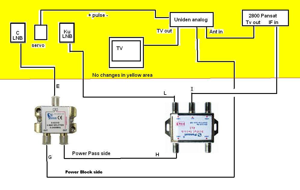

Thanks for the nice sketch FaT Air.
Just two things for clarification:
1. +Pulse replaces my "A" and "B" right?
2. Can't read the fine print on the Pansat Diseqc switch. The one I have is the Pansat 4x1 Diseqc Switch Supermini. Is that one OK?
A is your actuator wires B is the red white and black to servo.
I see I didn't include the actuator wire (A), but, there are no changes there., nor to B
Only changes are made to the coax disqc switch and splitter connections.

Your dissqc switch is fine, actually, just use the ports you are using now. The picture I used is from the pansat site, so thought it may be the same.
