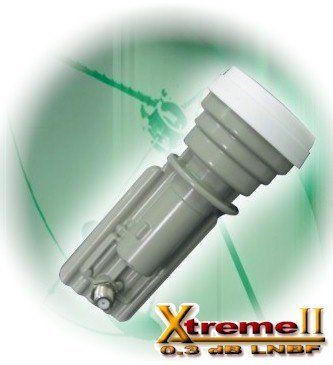

One question on the Xtreme...is it the Xtreme I or Xtreme II?
Xtreme II has a different way to set up the LNB for a fixed dish

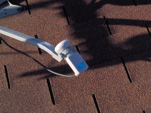

I think it's Xtreme 1? the box just says "Xtreme 0.3 db LNBF" The specs on the box are RF:11.7-12.2GHz IF:950-1450MHz L.O:10.75GHz NF.:0.3db. I only thought to change it out since all the reviews I've read about the Invacom where so great. Somebody else asked be if I had trees in the way and I DO NOT. I useed a lazer range finder and the closest tree is 2018 feet. The tallest tree in my path is about 60 feet tall but thats beyond 3000 feet. The main problem I'm having now is that I can get "great" Signal quality from G10 / Or at least my traxis 3500 says I'm on G10 but when I skip through 121 I realize I'm not on G10 at all! I'v never got more than 11% signal quality on TP 6 , 11805 H 4580! But TP20, 12087 V 20003 I get over 70% S/Q. But 121 has a TP35 which is the same as G10's TP 20 except that the Freq. is one higher (12088 as apposed to 12087) I think I'm thinking about trying avg1joe's suggestion and deleting all the TP's exept TP6 and see what happens. Actually I might just delete all the sats since I only want G10 anyway!
Xtreme I has a plastic case around it and is the left pic
Xtreme II is metal and is the right pic

It's plastic, Bought it from a DMSI dealer here in Michigan. I took some vaca time this week-end so Friday "weather permitting" I'll climb back up there and give it another go! Did I understand you right when you said if I have the test card from 121 then all I have to do is blind scan 123? Or do I have to drop the elevation 1/2 degree and go 1/8 or so west?
