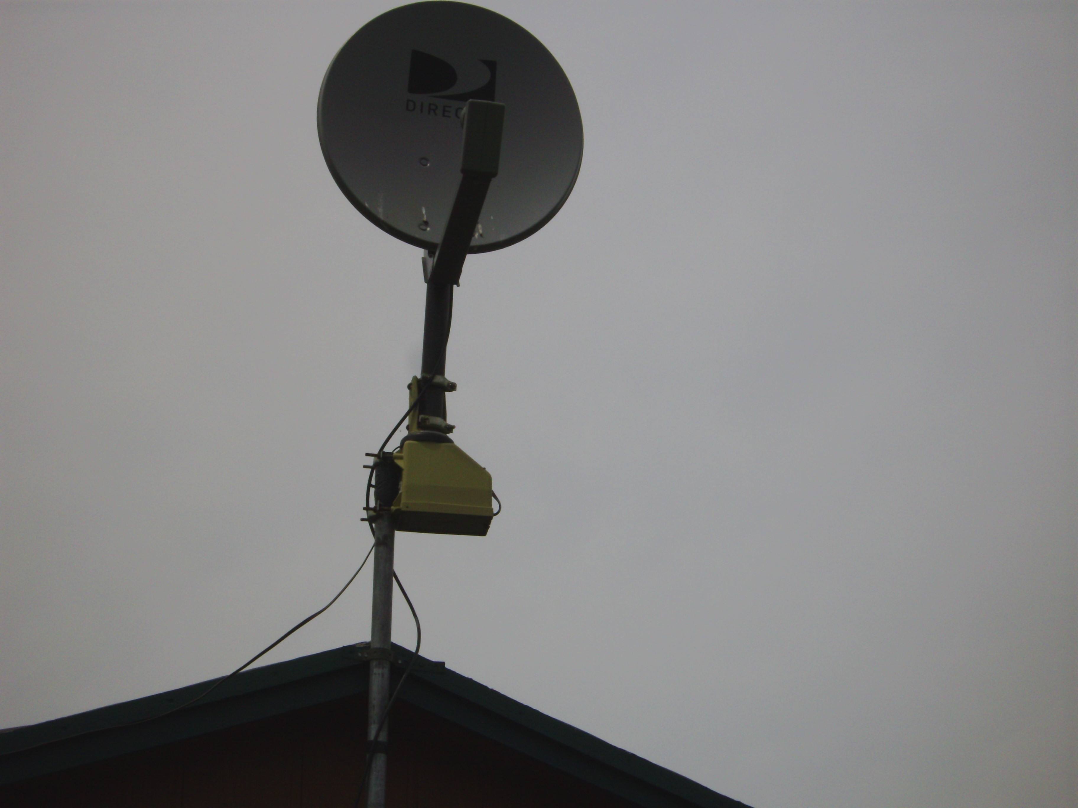

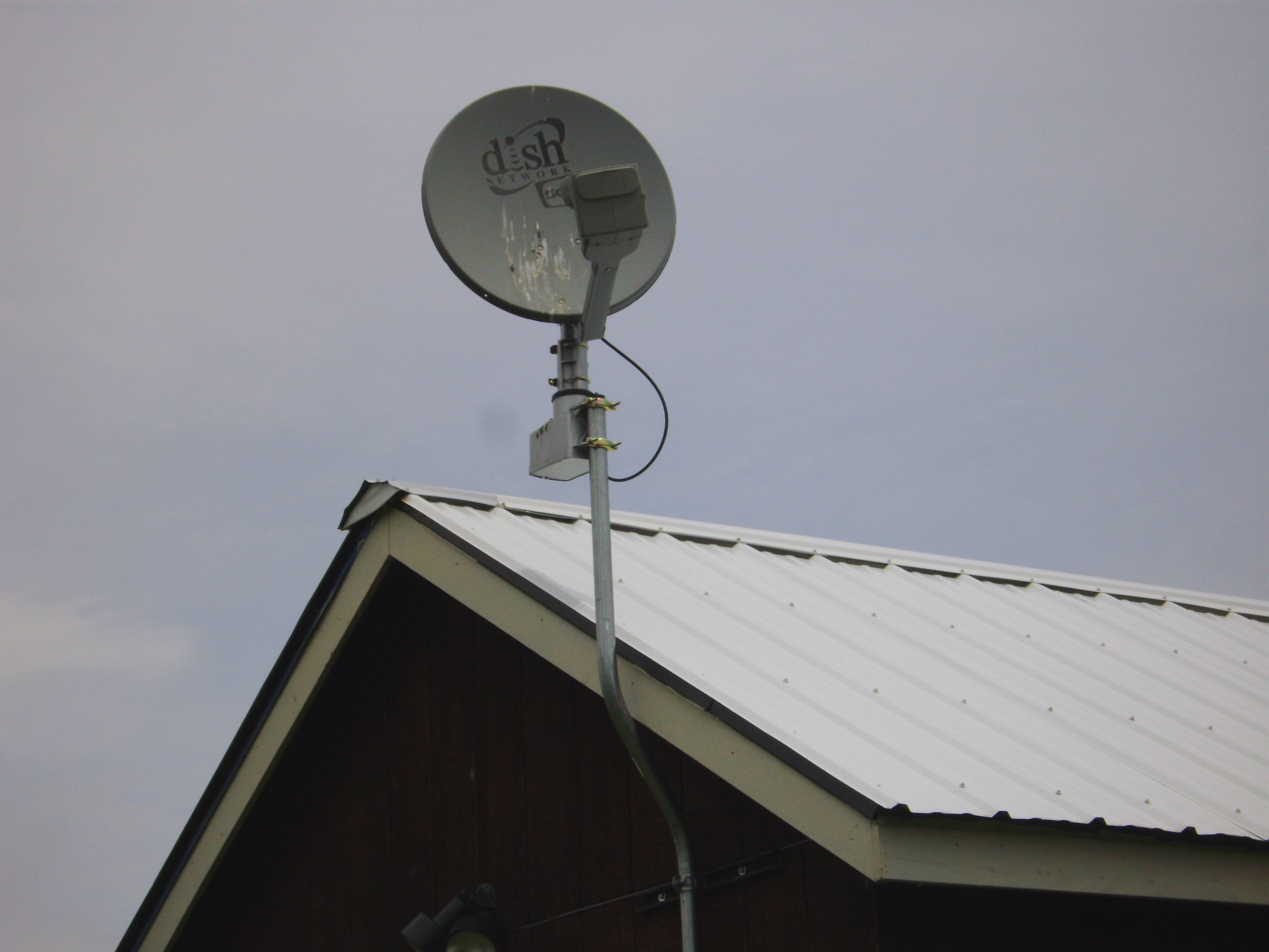

By the way here are some inventive ways to move a dish that folks have done on Mille Lacs. They use an old antenna rotor
Since the elevation on a multi satellite dish doesnt change when you're on the lake (just azimuth) they use that. But your single LNB dish needs to change elevation for the different satellties
