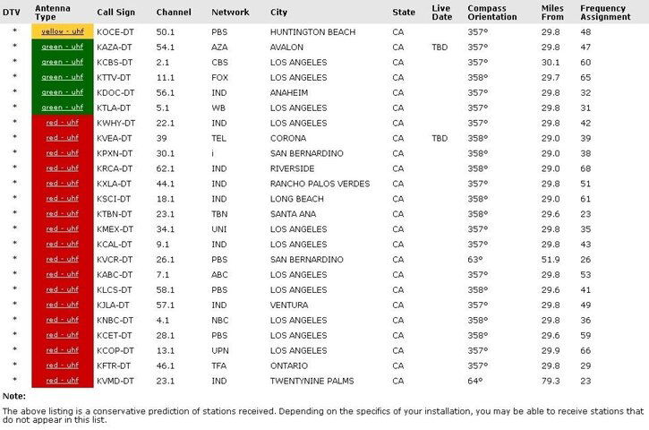

Attached is you area's DT info (I had to make up an actual zip as yours was missing a digit) I would look into one of these antennas as a replacement and make sure to aim toward the correct heading.
Channel Master CM 4228
Antennas Direct DB8
Winegard PR 8800

You probably need a better antenna. The tv should automatically list the digital channels with their analog channel number. Look at the attachment charper1 posted in post#3 at the end it says frequency assignment, that is the digital channel number for each of those stations. You might try a zenith silver sensor a lot of people have had good luck it. Most of your stations are uhf and within 30 miles. The terk clip on is not a very good antenna. I tried it at a rental while my house was being built and I couldn't get anything and I was only 15 miles from the transmitters.

2) Your list of available local channels was posted here already, the .1 channels are where they would appear on your tuner.
http://www.satelliteguys.us/showpost.php?p=604765&postcount=3
