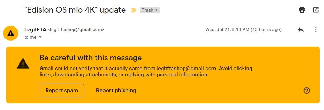

Gmail sends through the LegitFTA emails as they are on my Filter list as real, however, it tags them as "Phishing" emails. Here's the header:
I use a Yahoo email account and the notifications don't even get delivered to Spam. I had to PM the admin to verify my account. To date, I have not received a single email from that forum!
