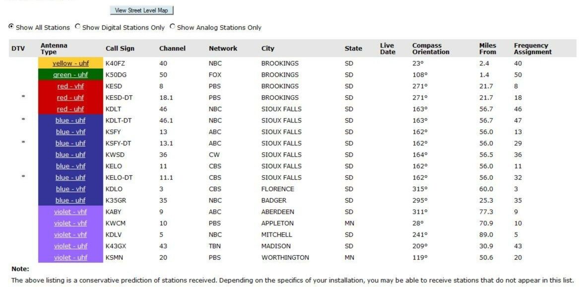

The antenna you would need would likely NOT be provided by DirecTV. I would look into maybe a Channel Master CM4228 aimed at 162.5°
I see you have no FOX digital if this is up to date, and FOX is provided by a translator/repeater. K50DG from Brookings. Do you have 2 NBC channels?
No Fox station listed at all, thats bizarre ...

He has FOX analog provided by a repeater tower basically right in his backyard; I don't think repeaters/translators provide any digital.
Oh, Ok,
I do not have to deal with repeaters so I have no idea if it's digital capable or not, glad I'm not in that situation.
