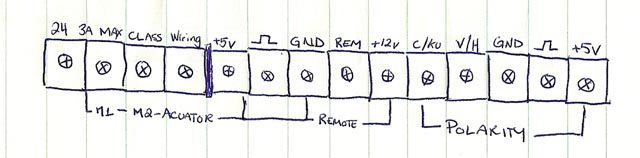

Hey guys i could not take a decent picture of the back of receiver but a drew out the portion of the receiver where i assume the cables from the actuator should hook up.
The cables coming from my actuator is 4 cables.
1 is Red
1 is Orange
1 is White
1 is Green
If any one could hook at the diagram i drew and instruct me where i should screw them in please let me know.
I using a Star*Trak 500 Analog receiver.

All right let me take a stab at trying to help you out.
Are the Red and White wires bigger than the Orange and Green?
If so, the Red and White should be hooked to the M1 and M2 spots on your diagram.
Moving to the next section to the right of the M1/M2 spots, I see a +5v, a top hat, and Grnd.
Hook the orange to the Gnd, and the green to the top hat symbol.
Give that a shot and see if it won't take off for you.
Thanks the red and white are the bigger ones.... I'll try moving it tomorrow and let you know..

thanks guys , the actuator actually works still... I put the cables in wrong... Thanks
Congratulations slim! I haven't been on since Sunday night and as I was reading this I was fixing to say Fred (Linuxman) was right and the Top Hat Symbol is the Pulse and the Green and Orange wires should go to the Pulse and Ground connections in the middle section of your drawing. That is a Good drawing by the way, easy to understand.
