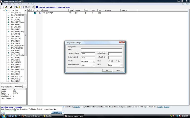

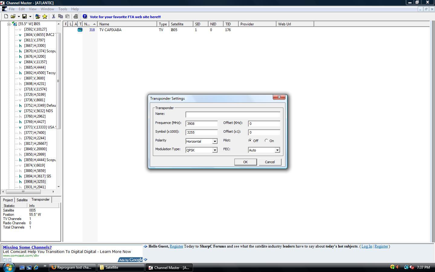

The transponder you provided on Lyngsat is 3932 V 3255 not H polarity
on thelist it shows as 3908 and I can vouch for that as I was the one who provided that info...see attached pic below.
so you need to program in the transponder as 3908 H 3255 then it should work
