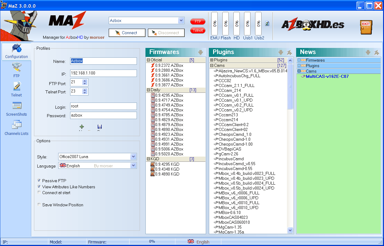

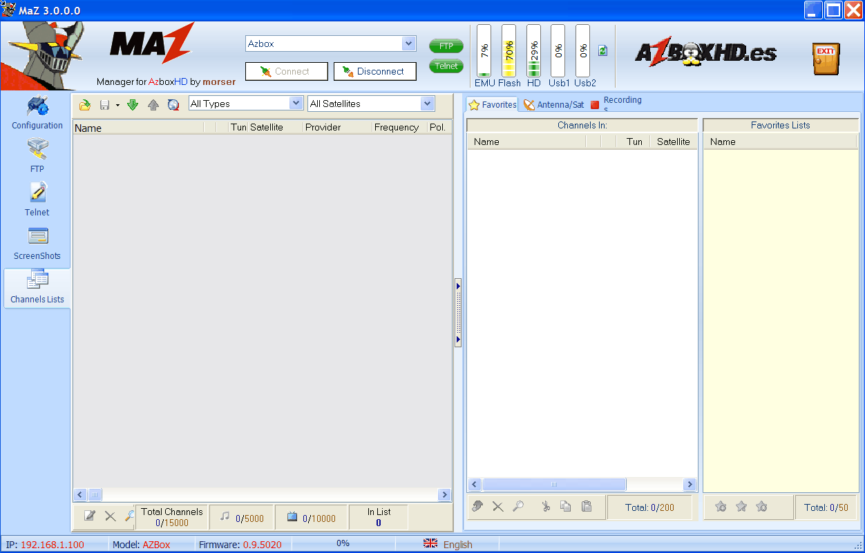

OPEN THE MAZ EDIT APPLICATION
First, you must have an operational application file for MaZEdit and your dish (and motor if used) must be aligned and channels scanned in. Your WiFi or wired internet/network connection must also be configured prior to this adventure.
The first picture attached is of the main configuration page for MaZEdit.
The second picture is of the configuration page after connecting to the AZBox.

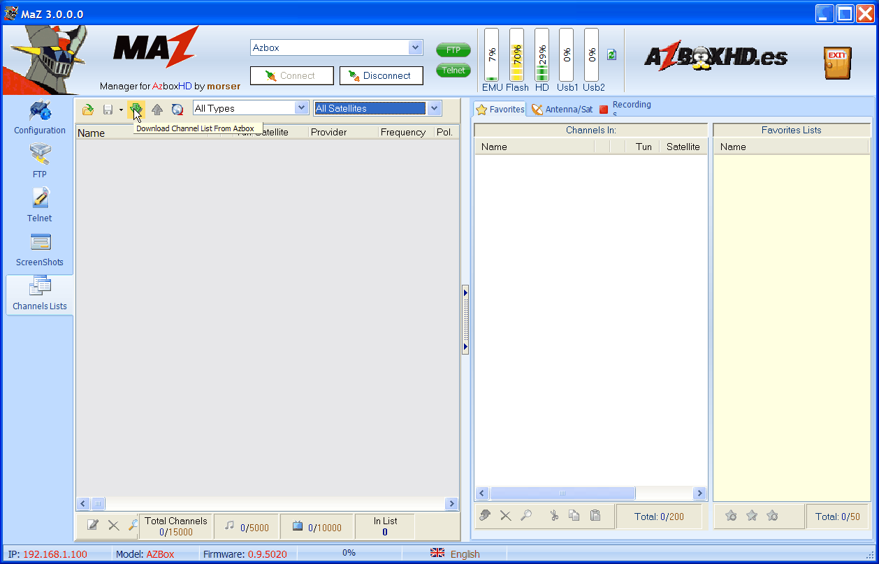

DOWNLOADING CHANNEL LIST FROM AZBOX
The next step is to download your channel list from the AZBox to the MaZEdit application.
PLEASE NOTE: The upload of the pictures I attached are not in order. I tried many times to upload them in sequence and the new changes to the "manage attachments" won't allow me to put them in order. I have named the files properly in their order (from 1 to 7) so look at the title of the picture and NOT the order that they are presented below.
1] Select the CHANNELS LISTS menu in MaZEdit.
Refer to "ch list page 1" in the attachments.
2] Click on the DOWNLOAD button.
Refer to "ch list page 2" in the attachments.

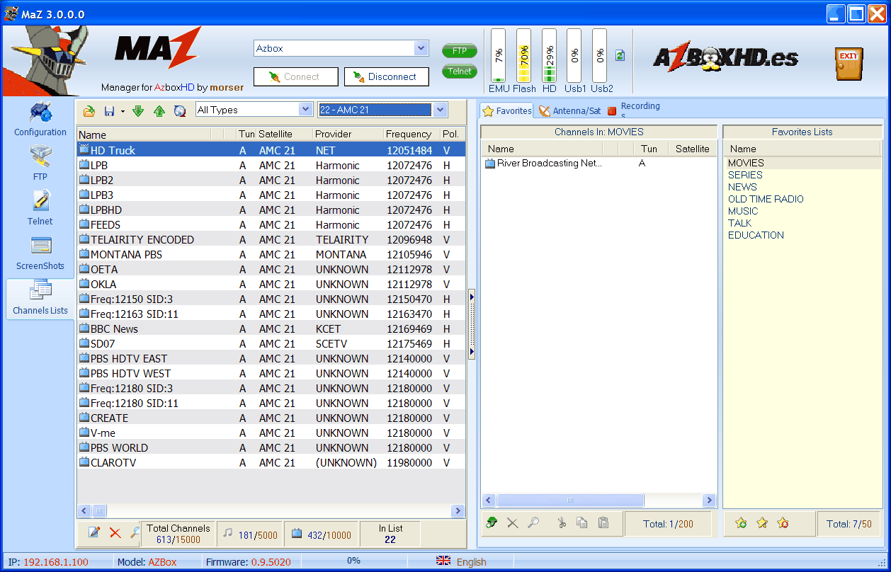

3] The entire list of channels (for all satellites) will be displayed.
Refer to "ch list page 3" in the attachments.

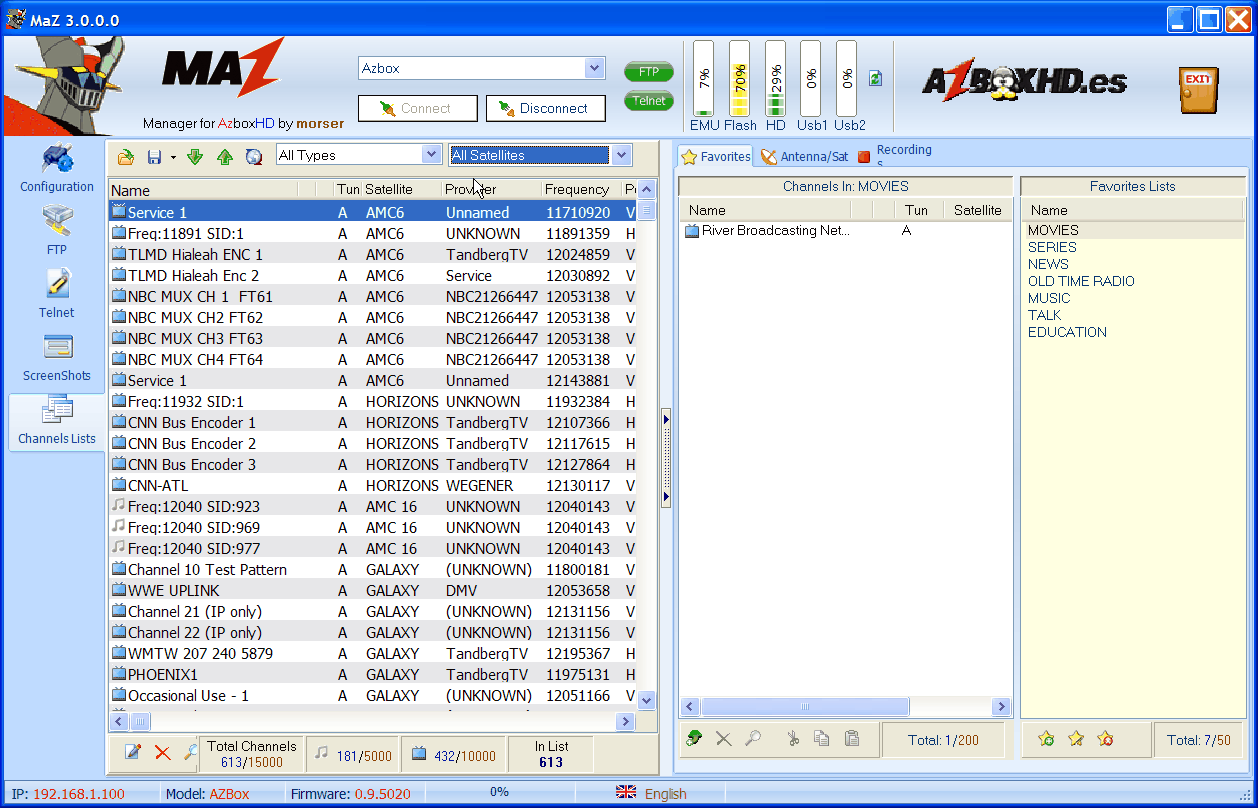

4] Select the satellite you desire to to record from. In this case, AMC 21 @ 125.0°W.
Refer to "ch list page 4" in the attachments".
5] The list of channels on AMC 21 will be displayed.
Refer to "ch list page 5" in the attachments.
6] Select the channel to record from. In this example, OETA HD.
Refer to "ch list page 6" in the attachments.

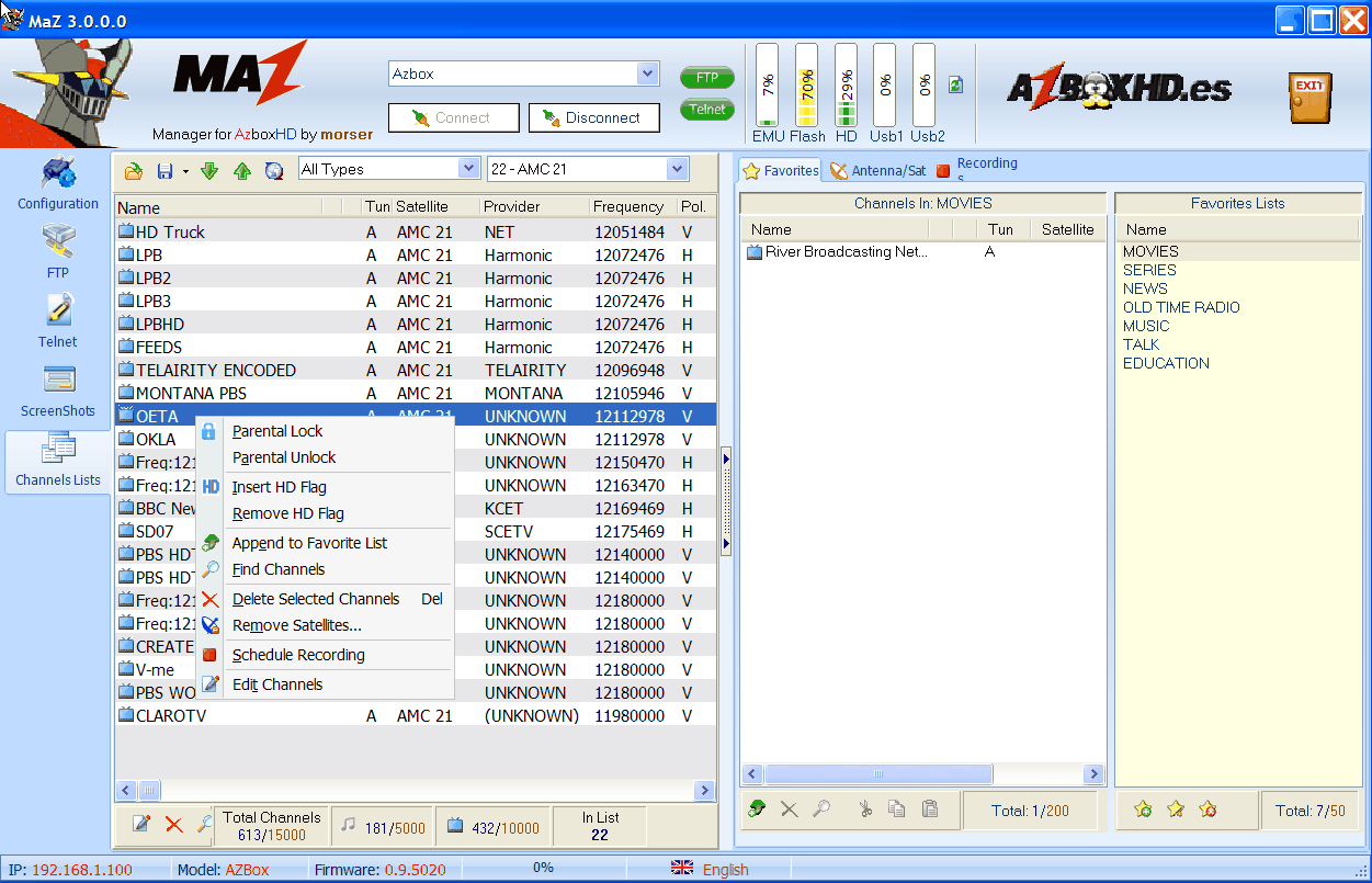

7] The submenu option page will be displayed.
Refer to "ch list page 7" in the attachments.
8] Note the SCHEDULE RECORDING option with the square, red icon. Highlight this option and LEFT click on it.
We will proceed to the next post from this point.

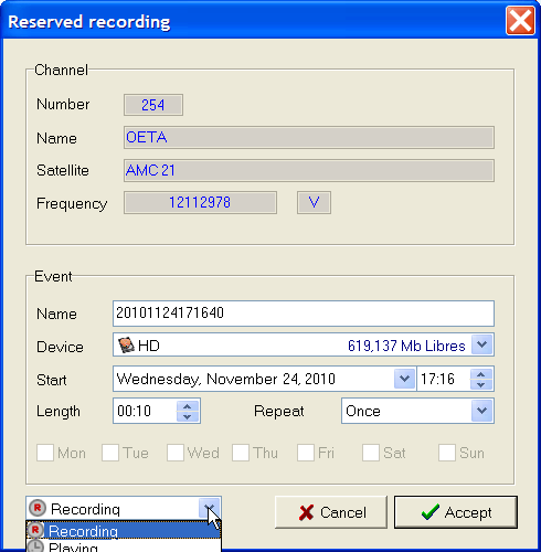

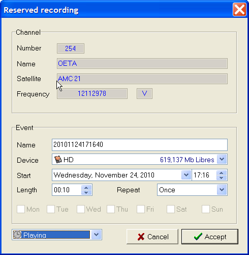

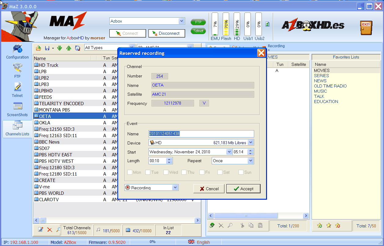

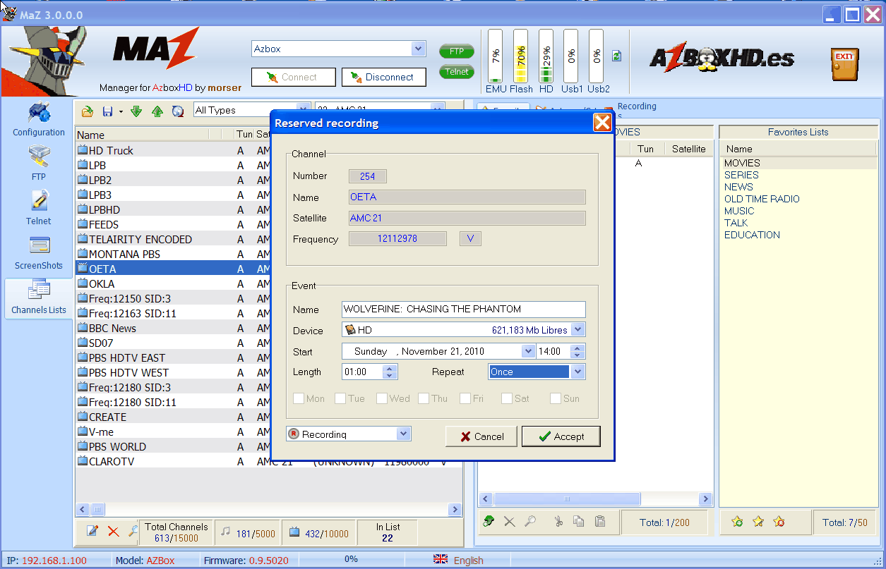

FILLING OUT THE RECORD EVENT FORM
After you have clicked on the square, red ICON to SCHEDULE RECORDING, a new submenu will appear. This is the "RECORD EVENT" menu. Refer to "RECORD EVENT MENU page 1"
You can enter the program title here (NAME)
Select where to record the program to, (DEVICE)
Start date and time
Duration (TIME) and user selectable day or days of week recording (REPEAT)
Days of week for customizing
Option to RECORD or just PLAY and CANCEL or ACCEPT
Lets peek at the virgin menu as it would appear before you filled anything in. Refer to RESERVED RECORD DEFAULT MENU. in the attachments.
Then, look at how it appears after we have entered our own customized data for the record event. Refer to RESERVED RECORD FORM COMPLETED in the attachments.

SAVING YOUR RECORD EVENT IN MAZEDIT
The next step is simply to save or ACCEPT the record event that you just created.
Make sure you use 24 hour clock time format for your record event as there is no am / pm option. When you are satified that all lines of the timer schedule are completed accurately, click on ACCEPT.

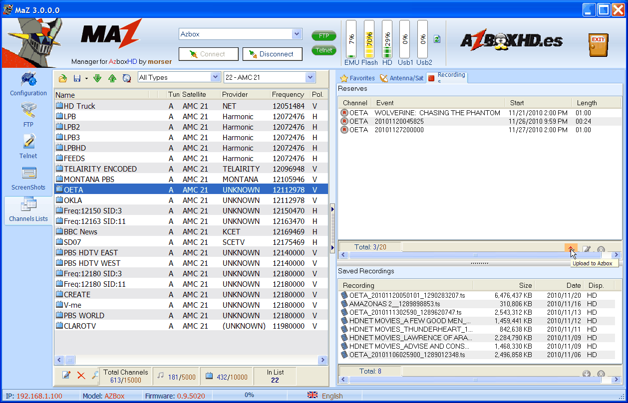

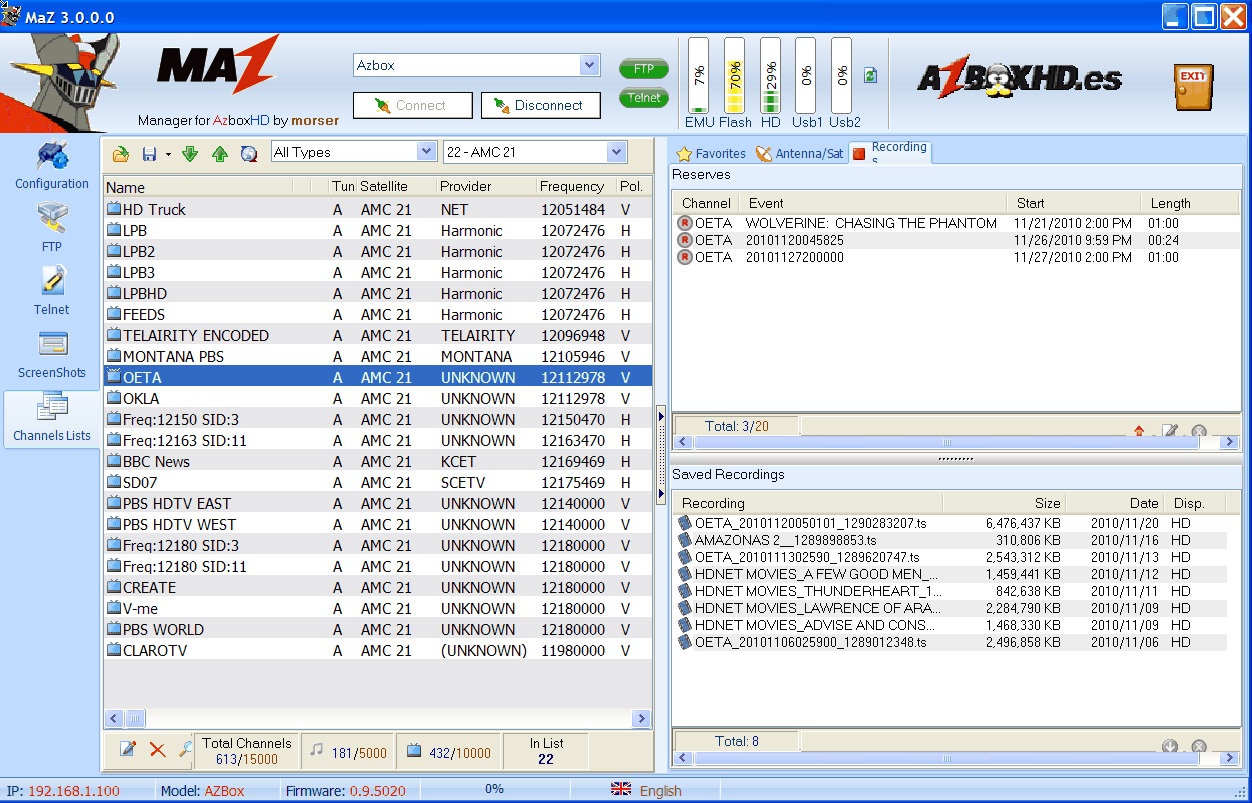

UPLOAD YOUR EVENT TIMER TO THE AZBOX
When you click on the ACCEPT button, that only stores the event in MaZEdit and does not upload it to the AZBox. You are still allowed to adjust the parameters through one last step.

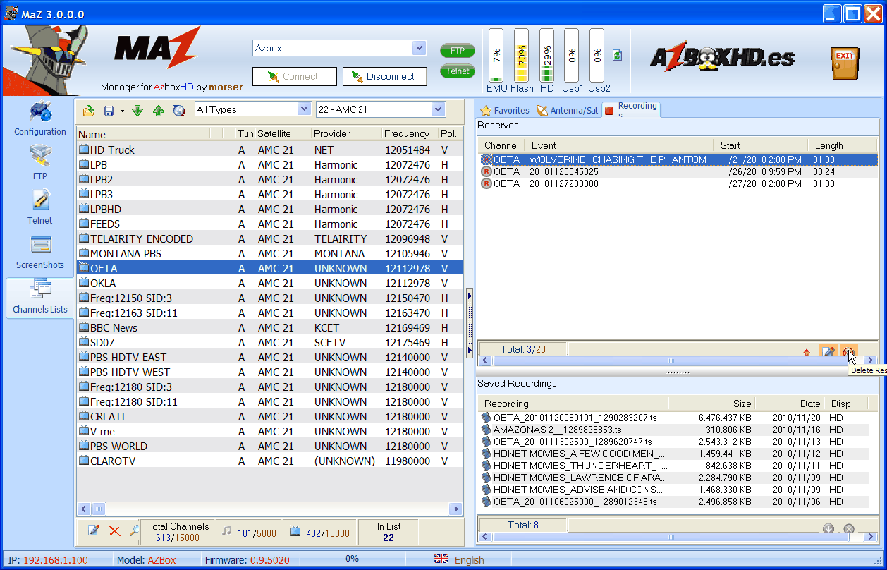

After you have clicked on the ACCEPT button, look over to the right panel and you will observe three TABS. FAVORITES - ANTENNA/SAT - RECORDING.
Click on RECORDING. This will then display the record timers already approved (ACCEPTED) but may or may not have been uploaded to the AZBox, yet.
You have the option to EDIT, DELETE or UPLOAD the RECORD SCHEDULES that you created earlier here.
Refer to the attached pictures below. Once you have selected to UPLOAD TO THE AZBOX, your information regarding the scheduled event will be transmitted to the AZBox and you will be prompted to agree to reboot the receiver to install the record event.
You can then use the remote to view the event timer in the ZBox directly if you desire.
You can edit or add or omit the timer feature using MaZEdit anytime before the program begins.
That is all there is to it. Enjoy! :)

UPLOADING TIMERS FROM MAZEDIT TO AZBOX
Here is a special instructional note:
When you create a new RESERVED RECORD event, before you upload it to the AZBox, ensure that the event is "HIGHLIGHTED" or that you have all the events highlighted if there are more than one.
It appears that if you do not highlight the events you created, they will not be uploaded so you must inform MaZEdit which timer events you want installed in the AZBox by clicking on them to highlight them.
I found this oddity through experimentation. Good thing I was checking. To check your results, after the AZBox reboots, use the remote and click on MENU and scroll down to RESERVED PROGRAM option and press OK. Verify that the event you created is listed here.
RADAR

OPTIONAL WORK AROUND FOR TIMER EVENTS
If you would like to ensure that the scheduled record event begins preceisely on cue without any missing program time or additional recorded information that is not part of the program, you can do this:
Set up a RESERVED PLAY event timer. Follow the same procedures for setting up a RESERVED RECORD event timer, but in MaZEdit, select PLAY instead of RECORD. Schedule this PLAY event at sometime before your desired RECORD event. Select the same sat and same channel that you are going to record from. Then proceed to set up your RECORD TIMER.
This will wake up the receiver and move the dish to the appropriate satellite and channel, but it will not record anything. When the RECORD EVENT begins, the system will already be at the appropriate sat and channel. In doing this, you will not be required to add additional time to the RECORD event start or duration time.
It may seem a bit cumbersome to do this, but it is just as cumbersome to add the extra time to the record event to obtain nearly the same result.
It would be nice if the AZBox could learn or if there were a way to tell it to wake up and move to a new satellite in advance of the recording schedule, but we simply do not have that luxury.
