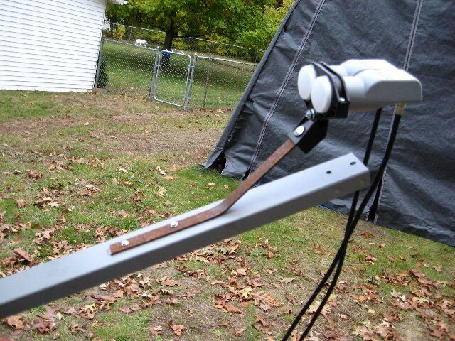

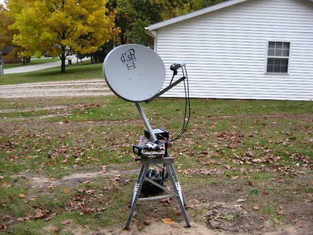

Can you cut both arms and blend them together so that you have the proper opening in the arm. Basically what I did to get a single LNB to mount on a Superdish. I cut the end off of a Dish 300, then cut the end of off the superdish then bolted them together.
You may have to get inventive, but if there is a will there is a way. I just did this the other day.
