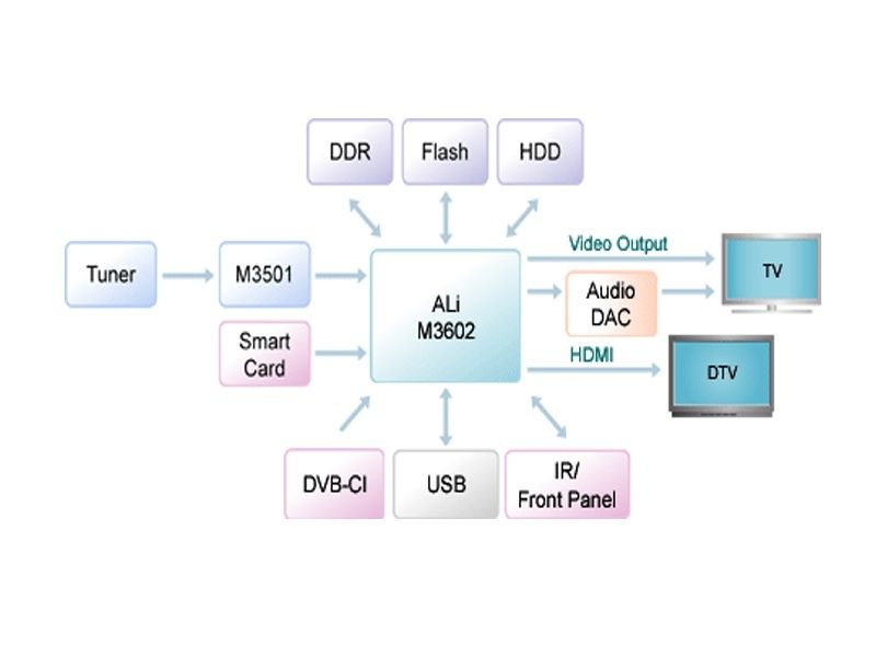

The solomend uses this exact block design. cc from the Ali website.
Hey Crackt, Ya I know where are all thes freelance coders when you need them!!.
Sanjap, Thanks for the block diagram but that doesnt cut it. Here is an example of a datasheet for specific part from a 8-bit arch of microcontrollers.
xxx.microchip.com/downloads/en/devicedoc/35007b.pdf
You would figure datasheets/white papers and arch. manuals would be available online for this stuff but nada. I was looking for info on some Broadcom and ST DVB SoC's about a month ago and didnt have any luck either. Im used to Mchp and and Atmel, where you have access to all info and tools right from the get-go.
Anyway if anybody out there stumbled on anything useful while researching the Solomend, please let me know.
