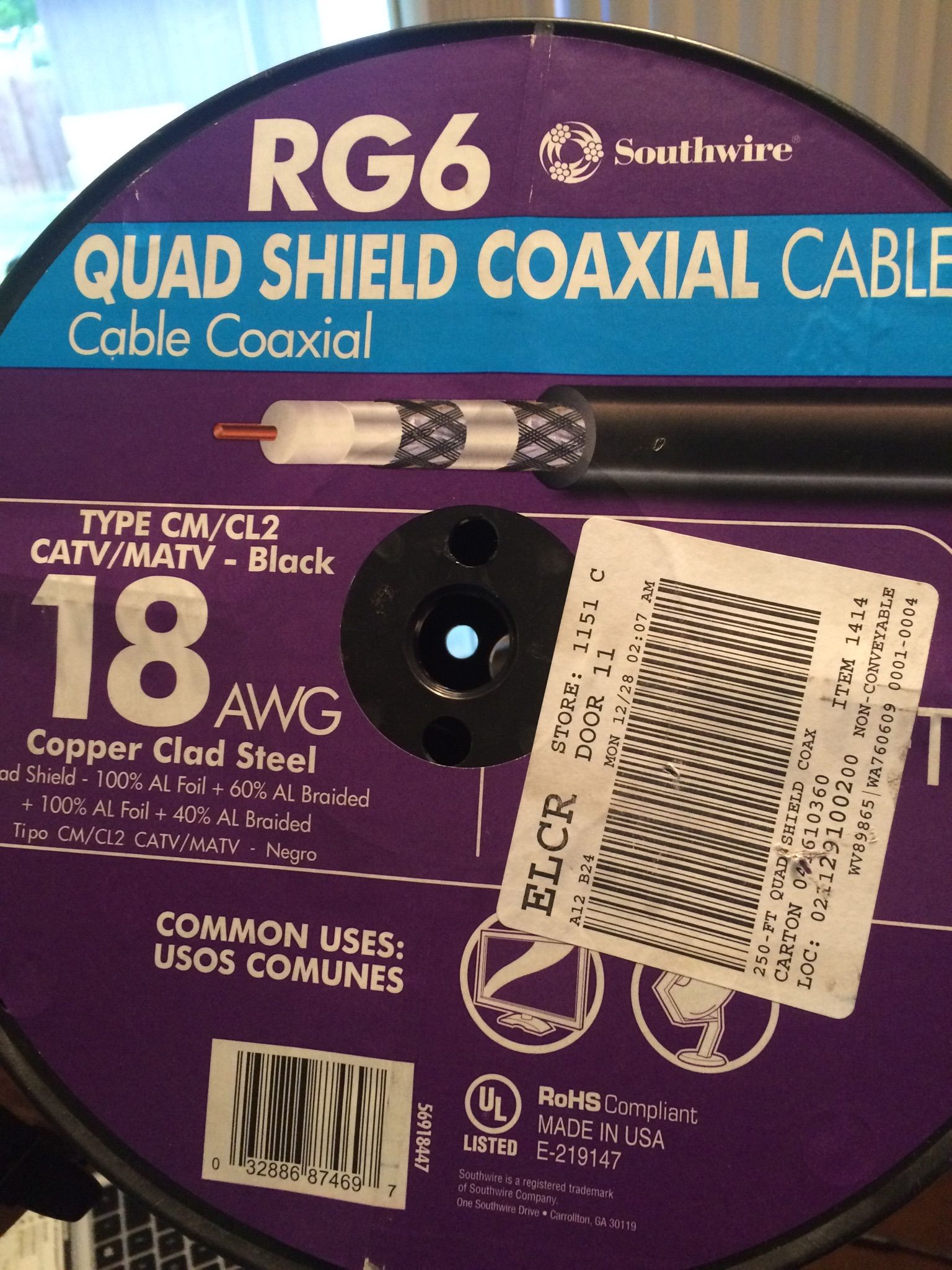

I ran RG6 quad shield to my garage for 4 tvs. 75ft underground to a 1x4 splitter, homerun cables to 3 tvs, split last one on a 1x2 splitter. DTV came to hookup, added wholehome, ran regular receiver for last tv. He used my home dvr as master. Picture would intermitting drop on each of these tvs. DTV came out and said the cable I used was the problem. I attached the reel I used, Has anyone had this problem before? any help would be appreciated. swm3 lnb.
Looks like the coax is from Lowes?
It's not bad cable.
I've used the Non Quad shield .
It should be fine as long as it's 3GHz which I'm sure it is.

Yes, its from Lowes. I think the tech didn't know what to do. I asked him to mount another dish on the garage to shorten the run, that's when he complained about the cable.

The tech who did an install for me noted the existing quad shield cable from outside into my house. He said they don't use it for new installs but he just needed to take extra time with his compression tool to make sure the connector was attached correctly.

I think that's just it, the Compression fittings are a pain in the ass with Quad shield.
The F connectors are tight, takes a lot of force and twists.
That's the reason I didn't buy quad.
But there is nothing wrong with that cable.
But I've used just a touch of vasolene , and that helps.
Just don't get it on your fingers, or you won't be able to twist on the F connector.[emoji2]
Samsung Galaxy S6 Active
The installer likely didn't have the correct fitting that matched the coax type. Sounds like you landed a newbie installer and not an experienced technician.
Regular RG6 fittings are too small of diameter opening to fit on RG6 quad shield or RG6 flooded coax cable types.
For RG6 quad shield coax, use the proper RG6Q compression fitting designed for the larger diameter and it will slip right on. :)
If the fit is still tight when using the proper fitting on the matching coax type, heating the jacket will help the compression fitting to be easily installed.
