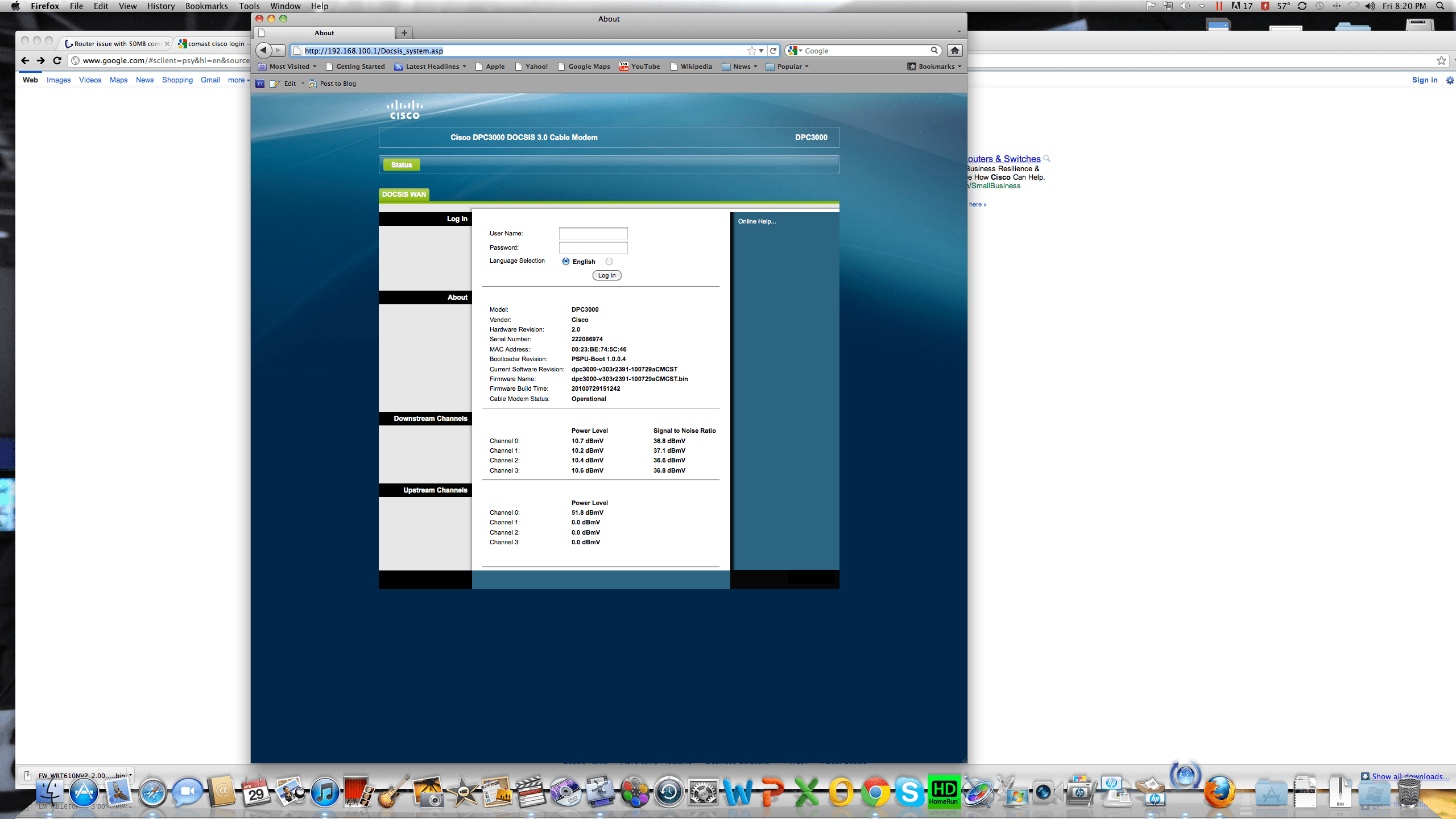

I have my DNS set to google's 8.8.8.8 and 4.4.4.4 vallues. Also, Comast doesn't pony up logins. When you go to 192.168.100.1, you can see the screen of the modem... any configuration beyond that screen your sol!
I use Open DNS instead of google as it filters stuff from my kid. My desktop is on google. But I have tested on various DNS to see if there is a difference, and there does not appear to be.
I looked at the Motorola modem screen, it is showing lower power levels, say 3 and 2 dbmV, with 36 for signal to noise. But the Motorola seems to have absolutely NO configurable things.
