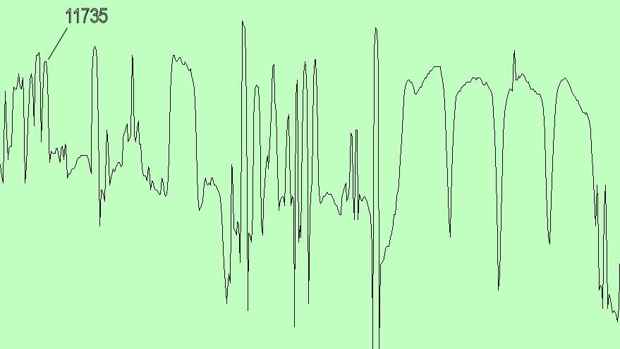

I really have a hard time believing that what you're seeing is coming from the sat, and I'm having a harder time believing that anything is wiping out RTN. I've been reading complaints about the RTN signal for months, and each time, I go check it out and the signals are there, and nothing looks unusual. The only variable seems to be a slight variation in the relative strengths of the 11729 and 11735 peaks. I am still convinced that all the problems observed are due to different receivers having difficulty with narrow signals that are close to each other.
Attached is a scan I did a couple days ago when people were having problems, and it looks pretty much the same as scans I did a week ago or a month ago, or 2 months ago. Only problems I've had with the signal is with my Fortec Ultra, ie a blind scan with a loose tuner. My other receivers don't have any problem with the channel.
Is it possible that what you're seeing is something local. perhaps even a diseqC signal coming though that's altering the starting trigger point of your SA, so that you're really not even looking at the same area of the spectrum when you're seeing the strange behavior?

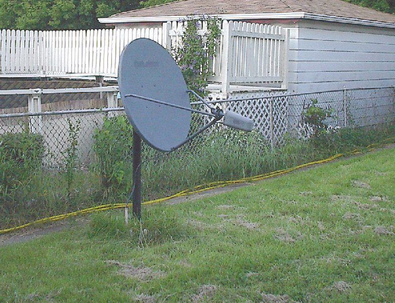

I guess the Satellite God's are mad at you ;) Honestly it has to do probably with your location, which makes no sense since as long as your in the footprint a larger dish will help. This throws all the textbook theory out the window.
Could you be getting local TI or a harmonic causing RTN to go down? Need to check your location for offending microwave traffic. That what I would do next.
Attached is the dish I use for RTN (no issues here) BTW theres a house for sale a few doors down you could always move here :rolleyes:
