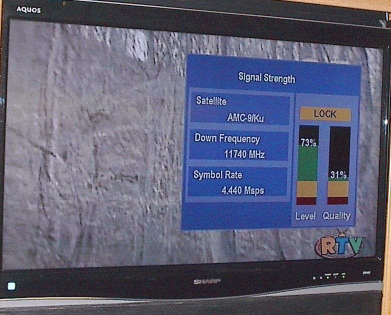

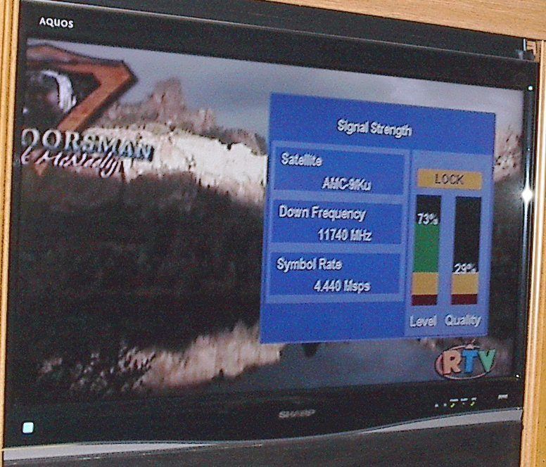

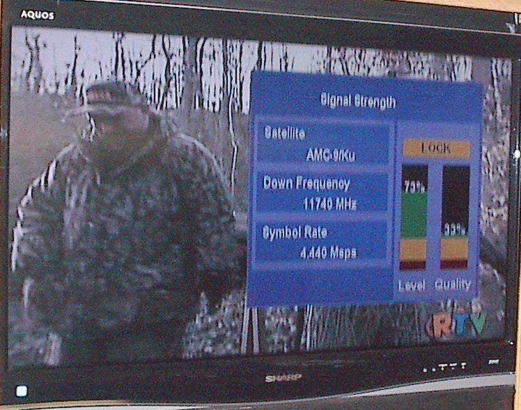

It's stable on my 90 most of the time but rides on the border lately. There signal is way down. The Pansat does a good job holding on to it though. I look at the quality and can't believe it's working that low in the high 20's to low 30's.
pedro, surprised to see another kazoo member on here. See lots of people close, but never anyone else from kalamazoo.
The only dish I can reliably lock RTN on now is my 1.2m dish.
It is also stable on my 75e, and I'm getting similar results on my Pansat. Low 30s now seems to be its standard level, whereas it use to be low-mid 40s with drops to the 30s. Haven't seen it anywhere near 45 recently (even for a short time).
Every once in a while it hits 45. Mostly 29 to 33 bouncing here. But it's solid, I guess that's what counts. Although I'd like to see it at 75 with the Pansat's tight meter. May need a 10 foot solid for that :D Luken needs to quit starving those squirrels powering there generator. :eek:
