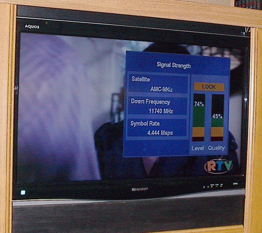

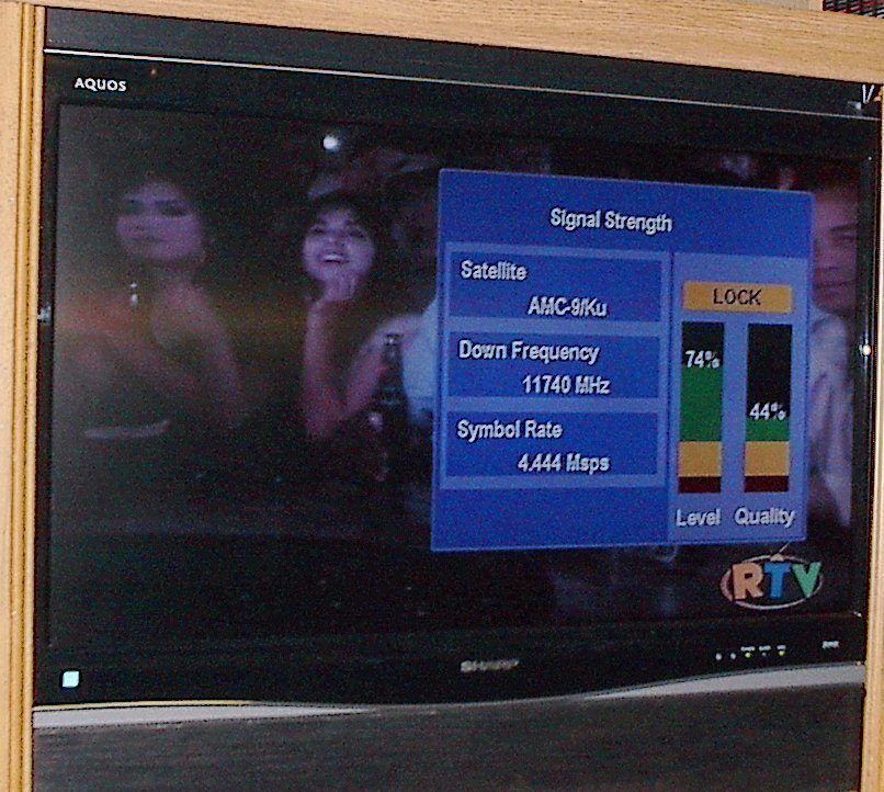

Something happened with RTN this afternoon.
The picture froze twice stayed down about 20- 30 seconds then came back and the signal is up. Peaking as high as 46, averaging 43-44 hope this lasts. It was like someone tweaked the uplink dish. Maybe someone read the posts here and did something.

That's on my 90cm Primestar. They must have done something today at the uplink. I have seen high peaks as high as 56Q. :eek: I hope it's not short lived. :(

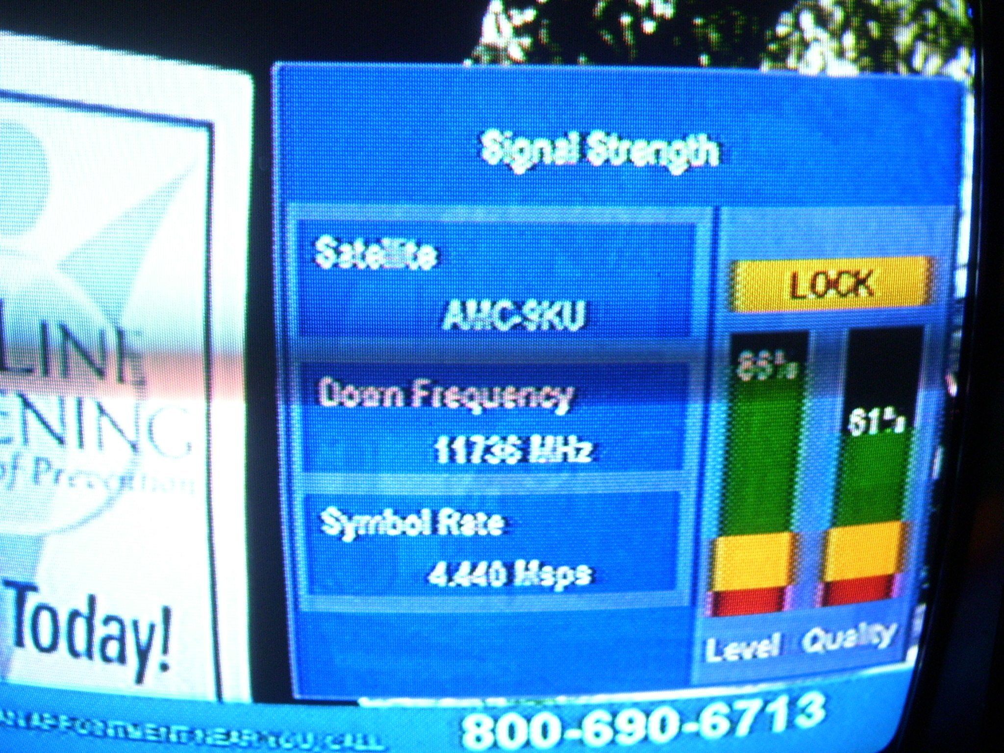

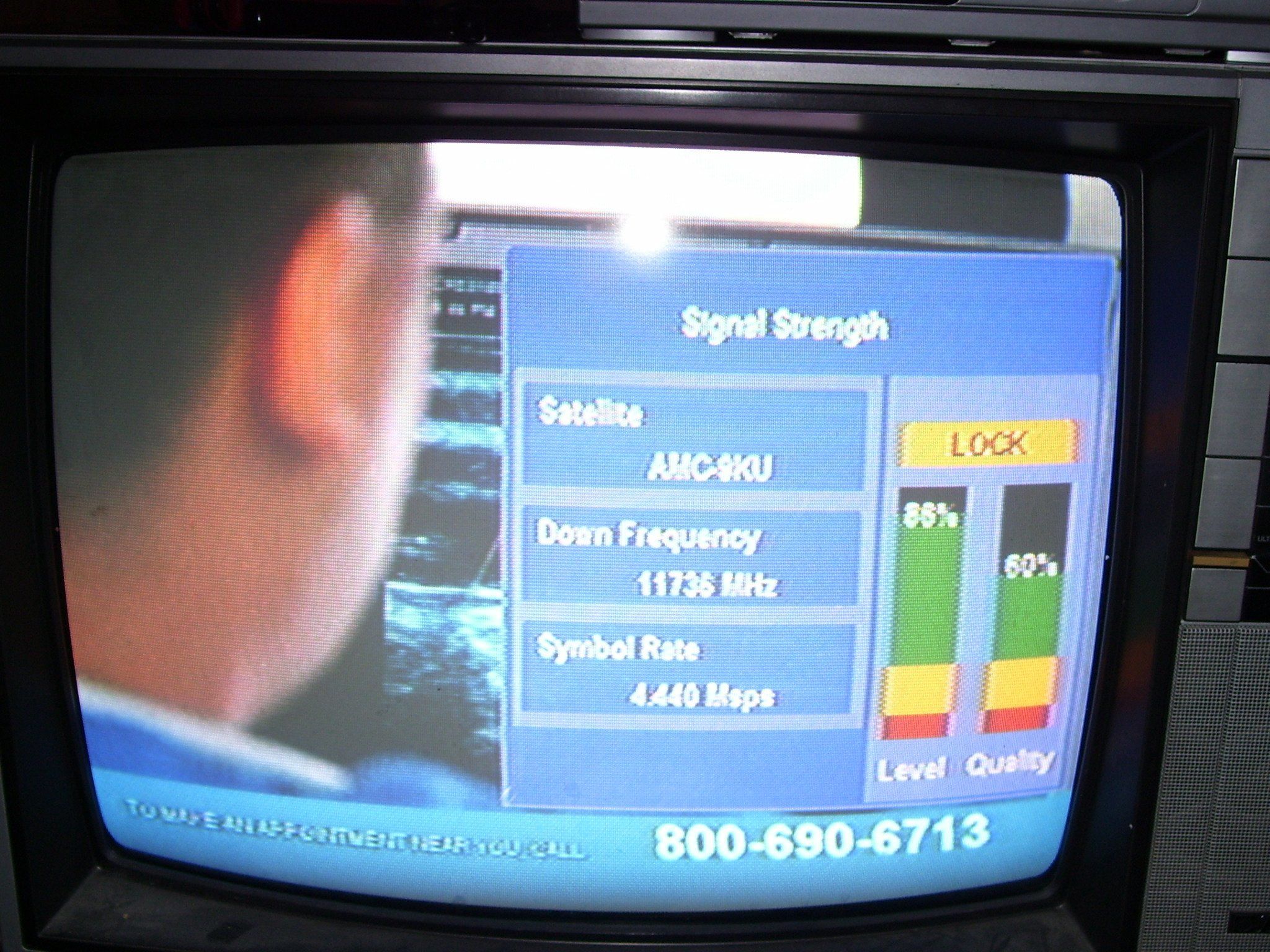

Here are pictures taken one after another of the average on the Pansat.
They changed something as i was getting rtn at about 48% and now it's at 56%.

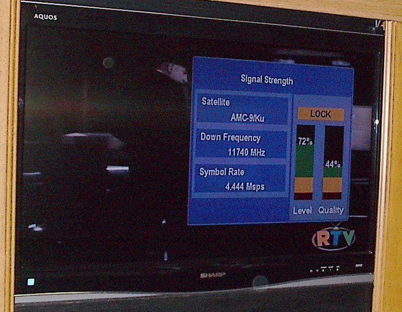

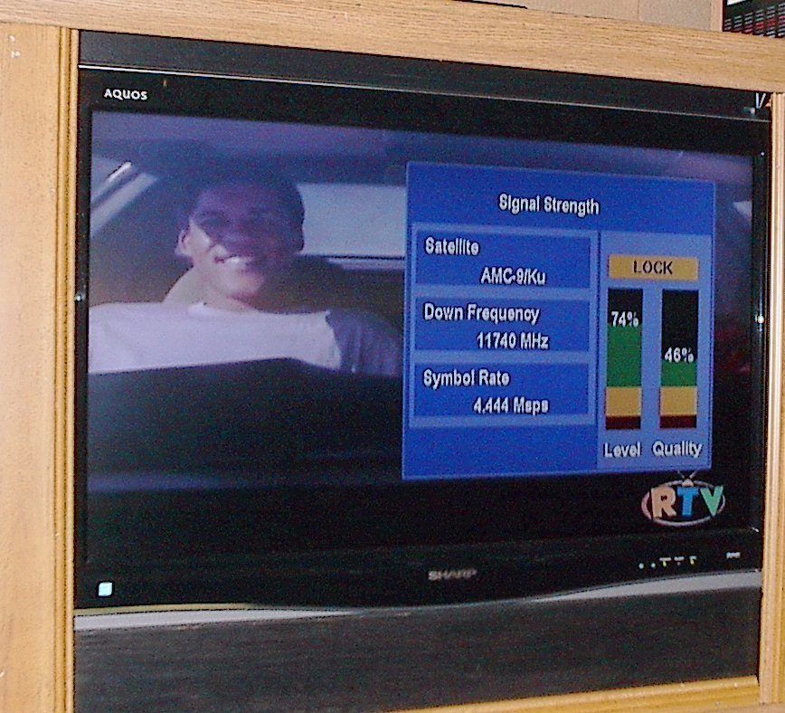

the 6 footer is giving nice results...60-61 rock solid :)
The Pansat picked it up on a blind scan with no issues

converselly on the 76cm dish....32 with spikes to 37

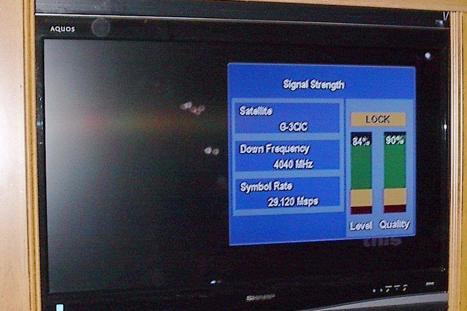

On C band the Pansat's meter ain't so tight. (see attached picture) Thats the CW, 90's are common place with the 12 foot. I need a 12 foot solid for ku :D

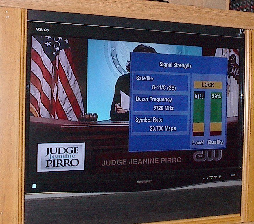

I lock CW on the 6 footer no problems at 99 quality ;)

I know it don't mean much any more but here is Equitys G3 7/8 mux. Those *Special Channels* on the CW bird give me in the high 80's. :)
