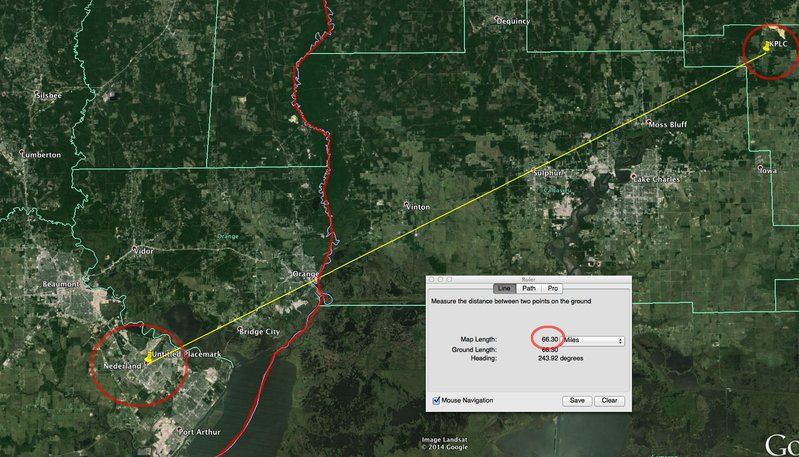

I have confirmed that when the WIFI is enabled it will not permit KPLC 7.x channels to exist. My dad's TV is in the 77627 zip code which is Nederland, Texas. KPLC is in Lake Charles, Louisiana.
Enable WIFI = NO KPLC
Disable WIFI = KPLC works great. Guide info and all.
