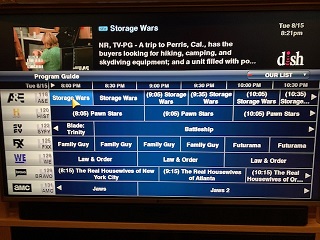

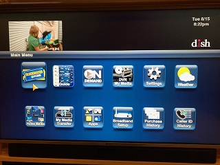

Telstar_1 there is some disagreement in the ranks of Dish experts, some say the 922 was a newer version, and some say the 722 was. Either way the 722 is a dinosaur in functional comparison to the 922. I can say this first hand as I have had both.
The 922 menu system, guide and interface is similar to the newer receivers, see for yourself:
View attachment 164310View attachment 164311
Plus the way it records into specific folders rather then just putting everything in one menu also makes it much easier to record and file your favorites.
I did read somewhere that Echostar and Dish was sued by TiVo over the interface used in the 922 and simply abandon the platform keeping the 722 as the premier DVR. Honestly after having a 922 I could never go back to the 722k. And to me its better then the Wally as it does not have all the Dish advertisement crap on it either. I imagine the Hopper is probably the same way or very similar to the wally.
Yeah, now I'm remembering more, like that GUI. But I didn't actually find the thing any more user-friendly, and now of course who knows what's not going to be supported or fixable. The 722 (also) auto-sorts same-name shows into separate "folders," and I believe you can sort further into groups but I've never done that.
