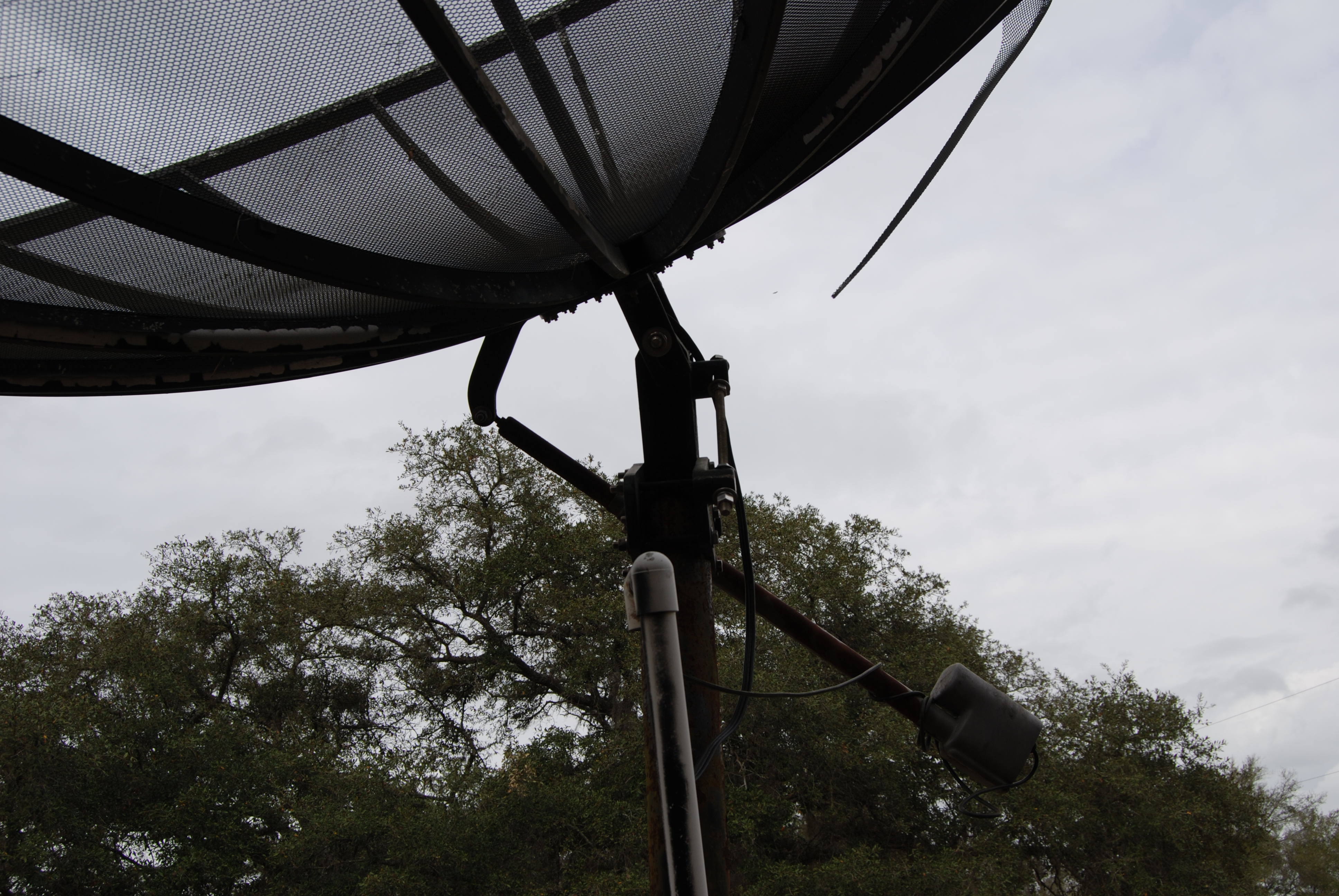

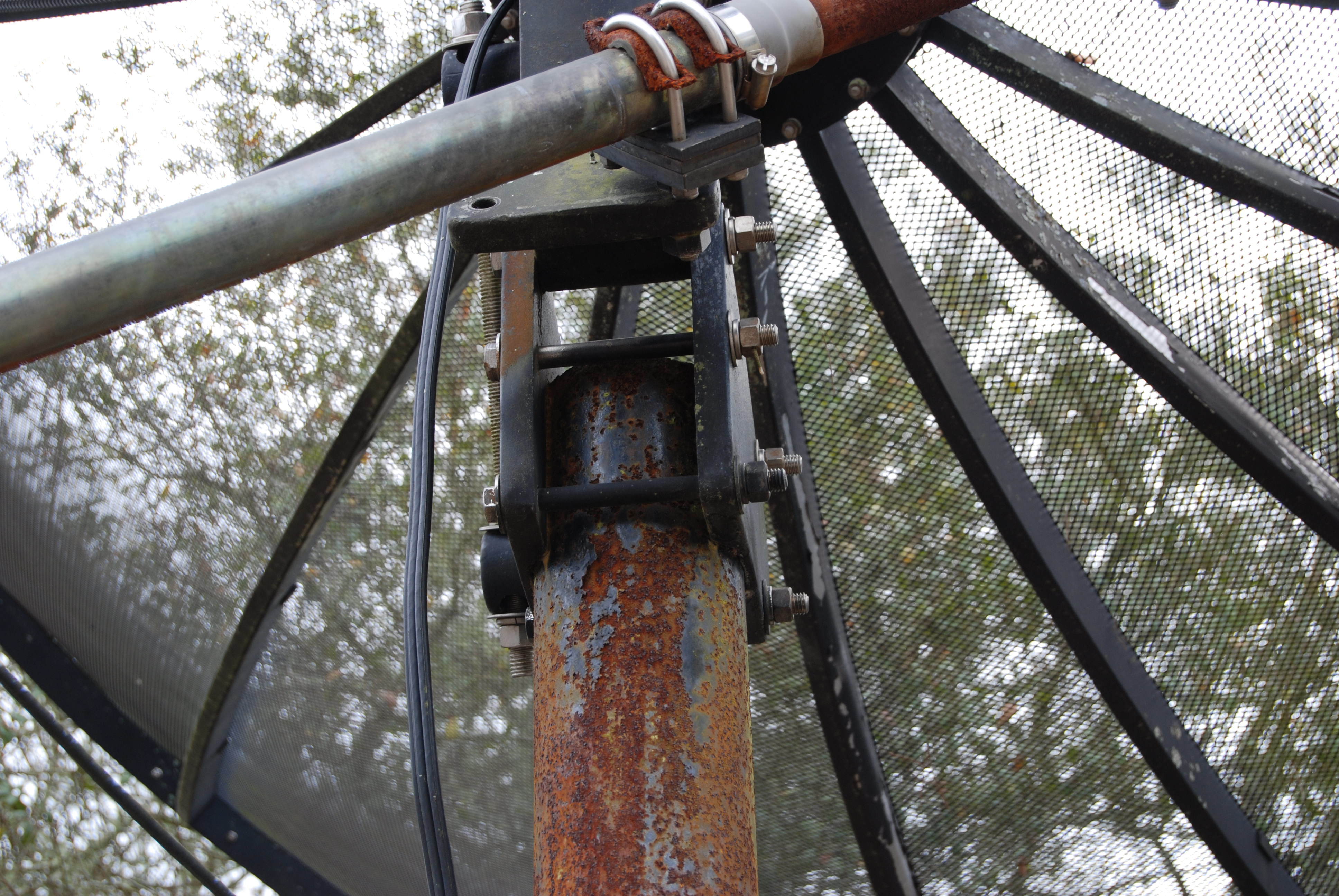

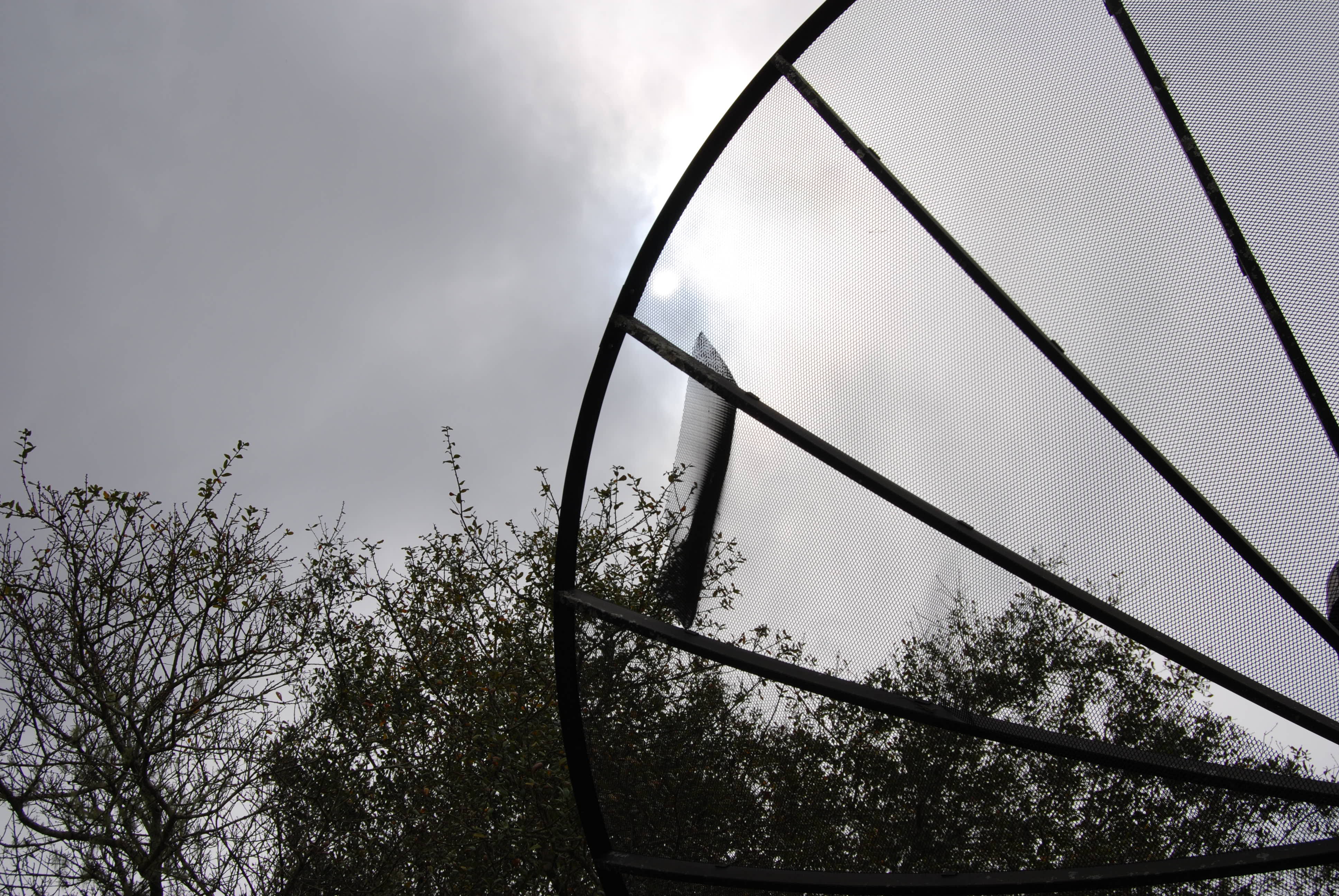

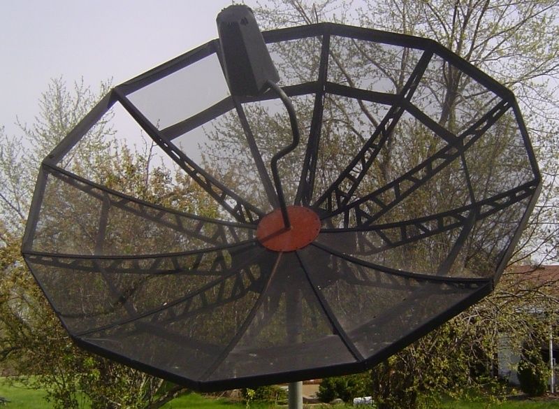

Hello everyone,
Thank you everyone who have taken the time to answer my questions. I had that feeling that the small dish dealer was giving me a line of crap! Even told me that the Satellite Dish would only work on one TV and that all the other TV's would have to watch the same channel. I would imaging that all it would take is to have an extra receiver at each TV, Right?
Anyway last night I was on the site and found a thread called:
"Adventures in dish hunting and what we find". I found that interesting. A friend of mine called me today and I had this feeling or memory that she and her husband had a Big Dish. Sure enough she did! She said I could have it if I took it out! I went over there and took some photo's of it. It's real clear that it says "Uniden UST-705" and on the arm I think it says "RADAR" which was very hard to read as it was so high. She didn't have any of the control boxes that came with it. Will have to replace or fix the one section where the screen backing is coming out.

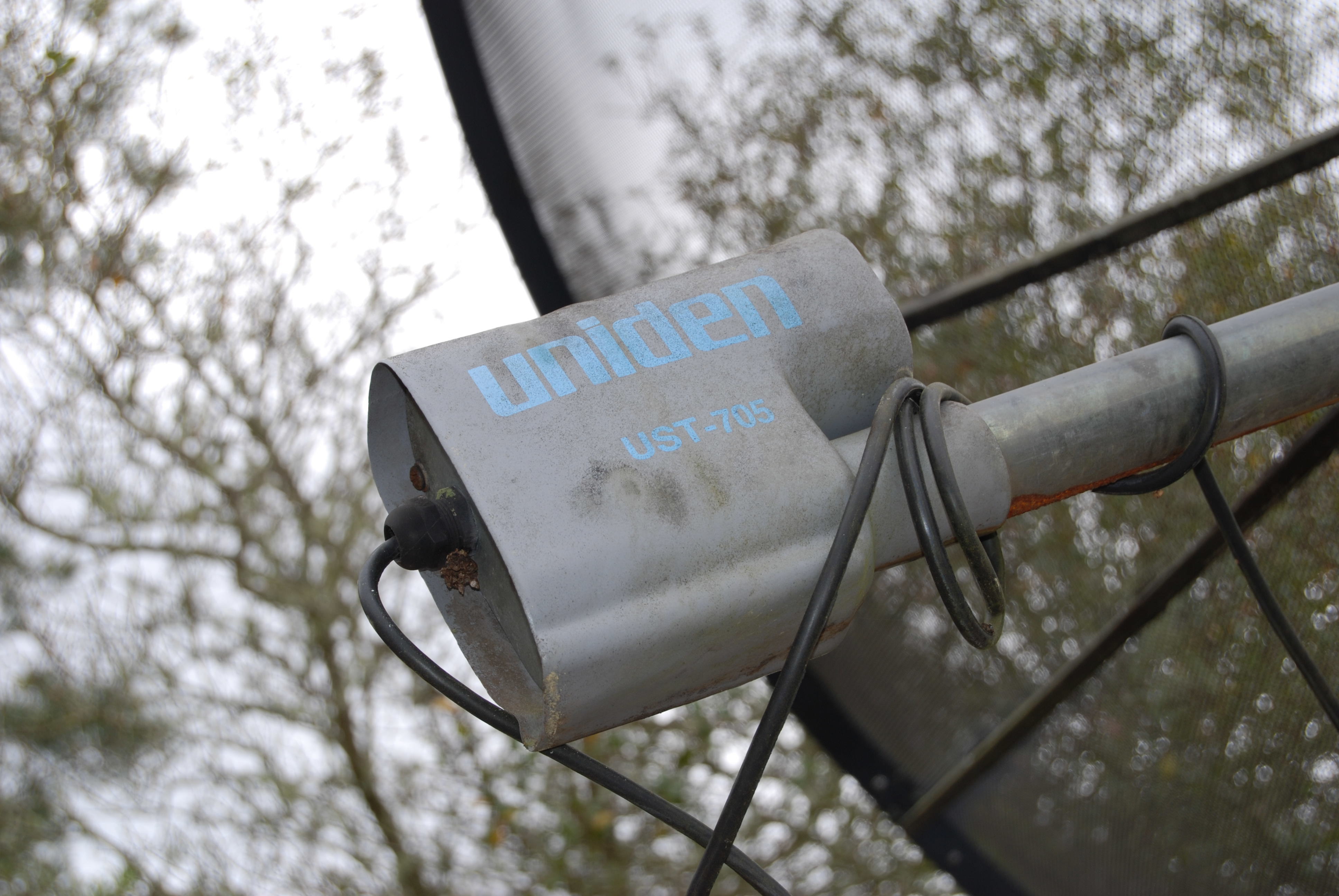

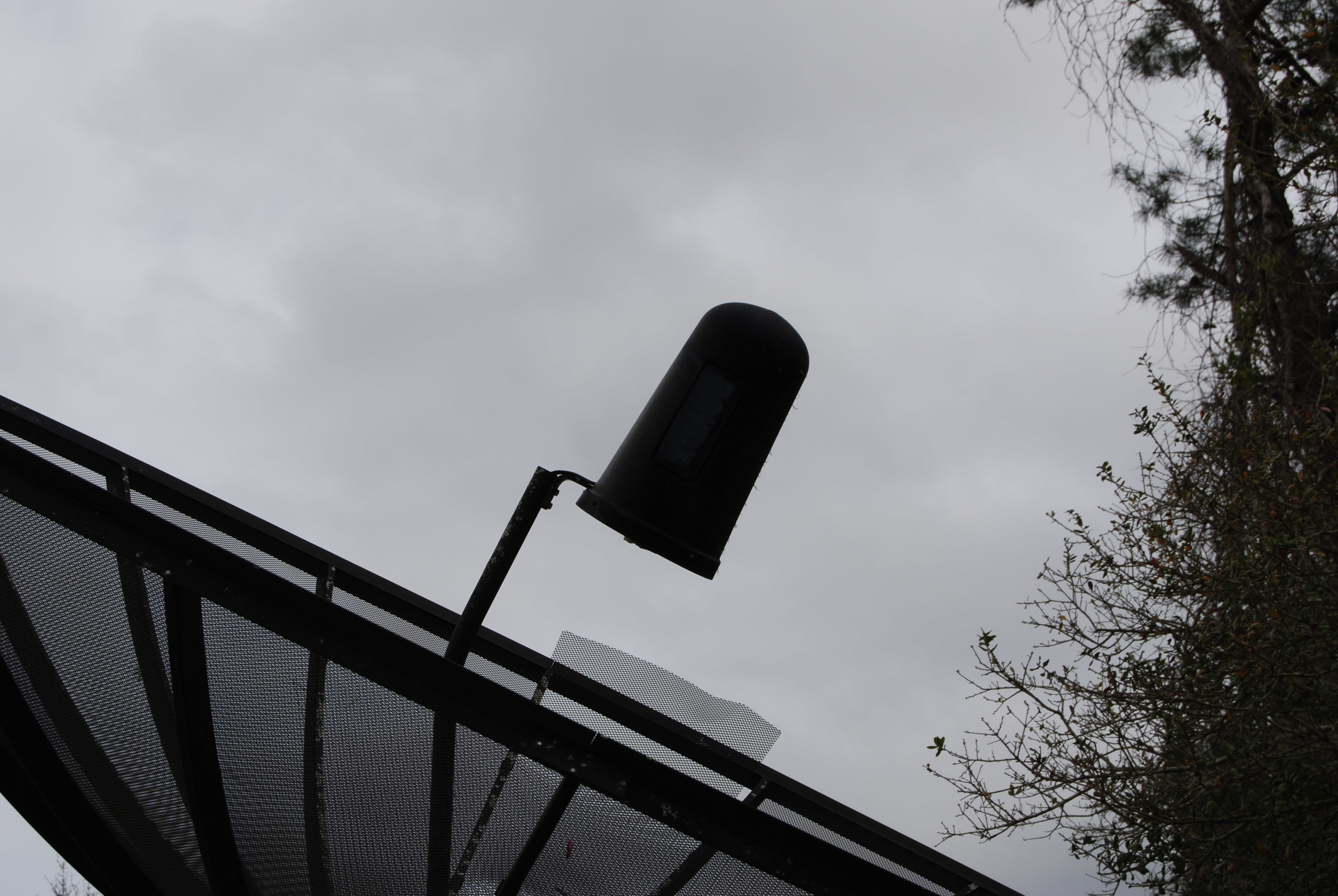

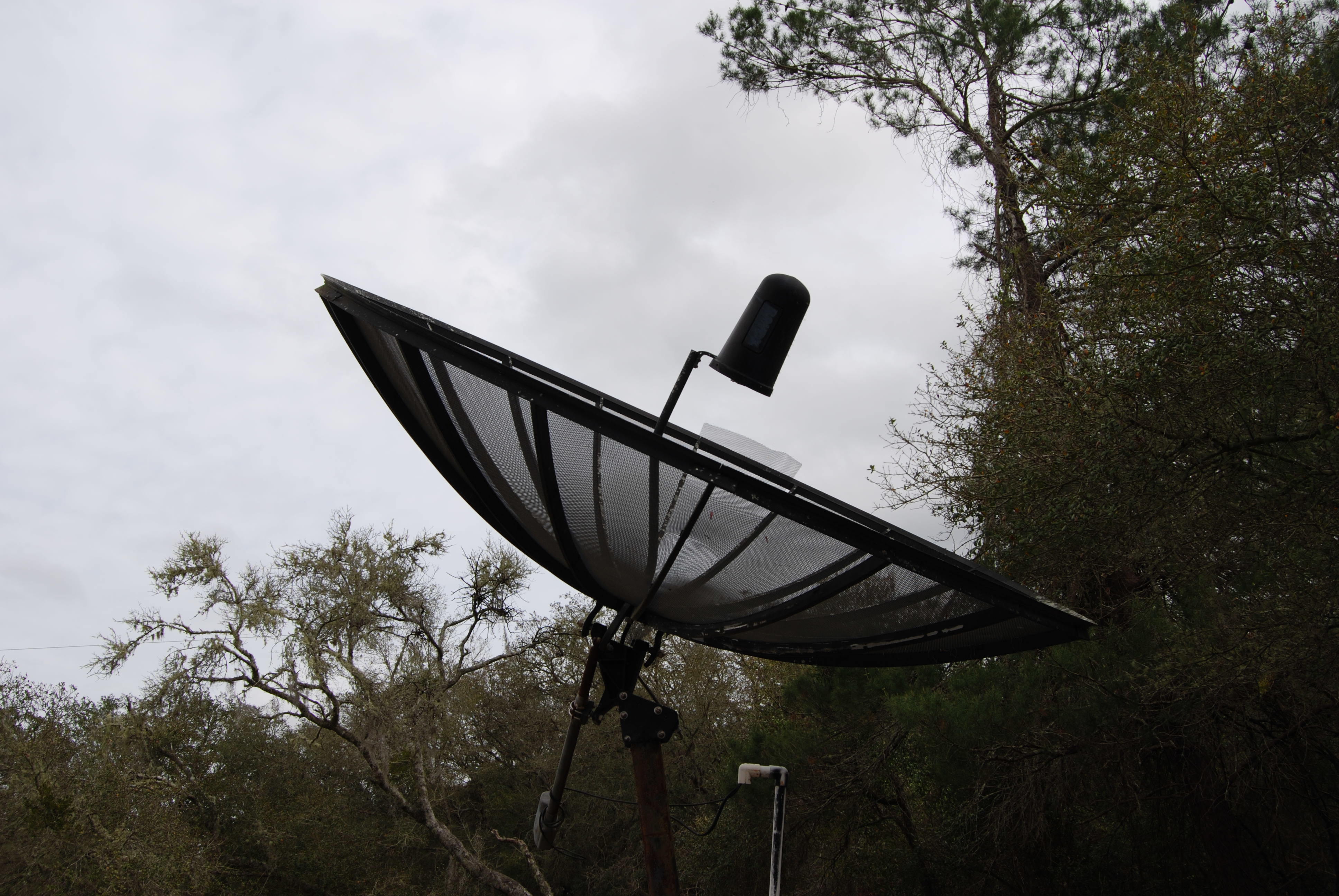

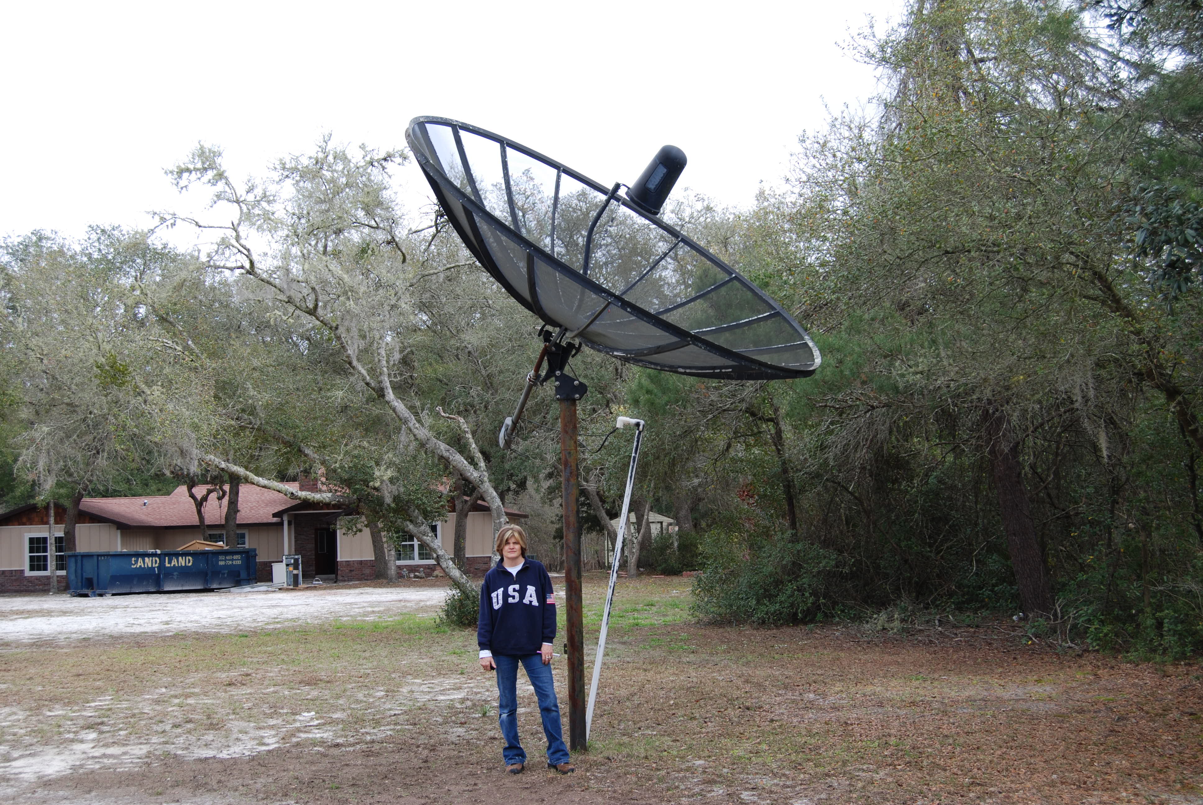

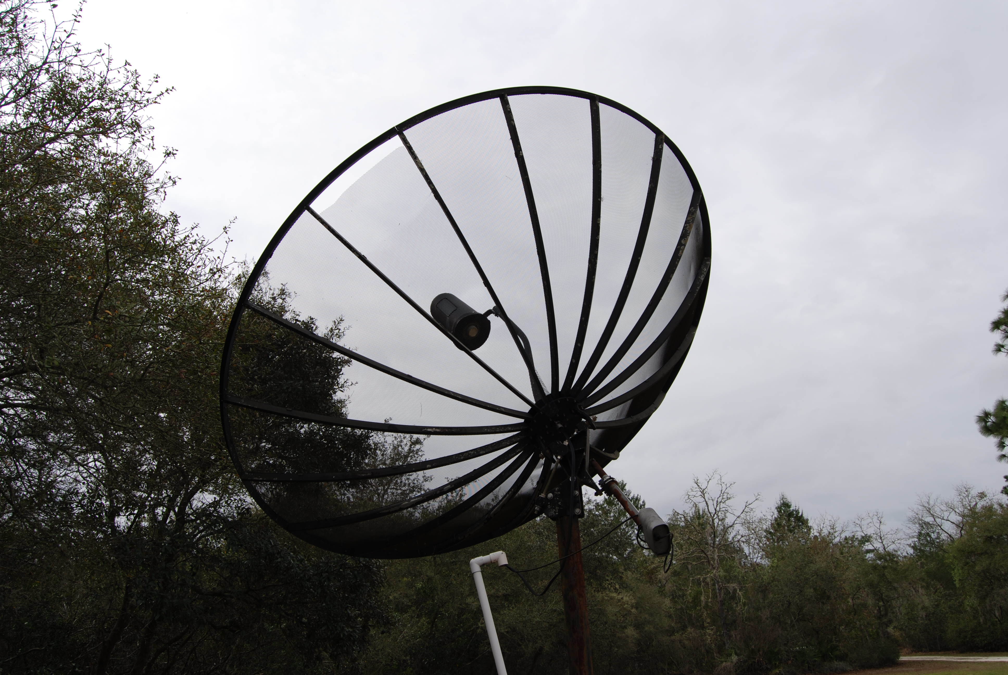

Then I found this Satellite Dealer that had closed up his shop. I asked him about the Satellite Dishes that he has at his building. I think there were four of them. He told me to give him a couple of days to think about it, if he was going to get rid of them.
Then on the way home I found two more dishes one I think by the appearance is a Janiel? It looks the same as one on the thread Called "Adventures in dish hunting and what we find", on that page they called it a Janiel. The dish wasn't round but had points around it and on the back it looked like the same type of heavy duty ribs holding it on. The other one was a 10' and had a lot of pine needles in it.
After I find which one that I will be going after, I have to figure out where to put in my backyard and be in a good and clear place! :hungry: Hungry to get a C-Band!!
Thanks again,
Thomas:)

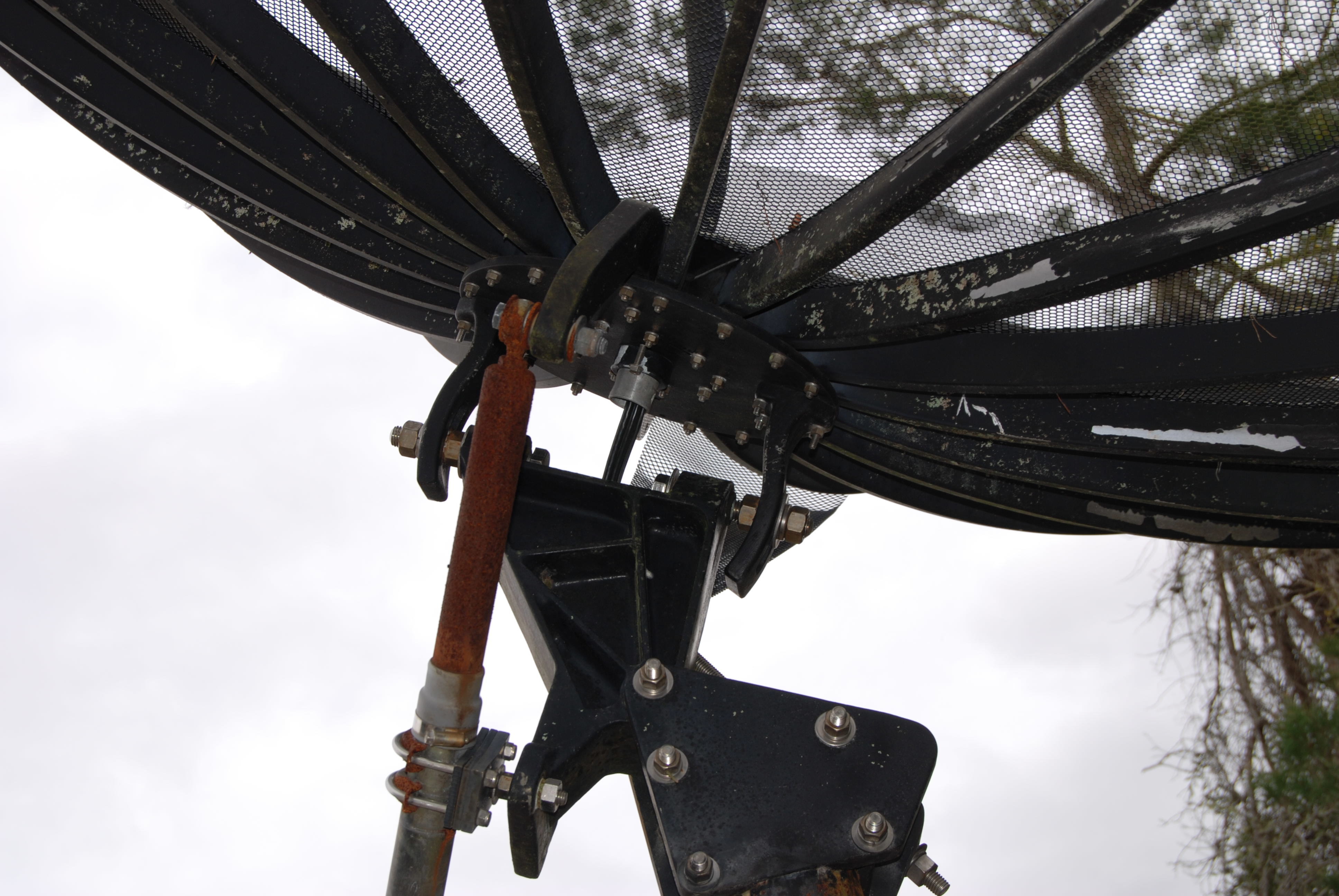

The arm on that dish looks rusted pretty bad. I'd be willing to bet $20 that it is rusted solid and won't move. If you take that dish, be prepared to get a new arm.
Well you are kind of limited to one satellite at a given time, so if you only have a 4dtv then everyone will watch the same channel but if you have a 4dtv and a dvb receiver and lets say you have a sub to the absolute digital package, then the wife or kids could be watching something on the 4dtv on G3 and you can watch the dvb feeds on G3 at the same time, as long as you are on the same polarity.
Rusted Arm & Mesh
When you speak of the arm, are you talking about the steel pipe that is cemented in the ground that the dish is connected to?
I took several photos of the dish. What would be my best way to take it off the pole? By loosening the bolts and then lowering the dish to the ground?
I'm think I should keep the dish in one piece and put it in a trailer till I get it home. I don't want it to warp or bend on me.
As far as the other pieces, (the piece in front and back of dish) do I keep those? Replace? The wire mesh, should I replace that too or reattach?
Thanks,
Tom :)

Hi Tom,
By "arm" I was referring to the motor that moves the dish across the sky to the different satellites. I have re-built that exact style of actuator motor a few times in the past, and the times I've rebuilt them, they weren't as rough looking as the actuator motor on that dish. I would simply replace the "arm".
You'll have to forgive me if I use some strange terminology.. The first C-Band system I installed was 20 years ago. I have picked up some of the slang/lingo over the years and tend to use it assuming that people know what I'm talking about. If you hear somebody talking about different "birds", they're not referring to the mammals, they're referring to the satellites out in space :)
In regards to taking the dish down off of the pole - they can be pretty heavy. The last dish I took down, I removed the actuator "arm" so that the dish was pointing directly at the horizon instead of up in the sky. Then with some assistance I was able to lift the dish up and off of the pole. That dish looks to be pretty high up in the sky though, be sure to get lots of help to take it down. The mount is probably rusted to the pole too. It would probably be a good idea to give it a good blast of WD40 penetrating oil a day or two before taking it down to try free it up from the pole.
actuator motor arm
Hi Tom,
Hello Davage,
I now think I understand as to what you were saying, Looking at it again it doe's look (photo's 5 & 6 from Left) pretty rusted. Yes at this time I may not know all the slang, however like I said before, it's a learning experience!
I do plan on going over there and giving it a good going over with WD-40. So I should also plan on taking off the actuator "arm". Which would be what is behind and it front of the dish.
You said that you then lifted yours up off the pole with help. While the one I'll be working on (photo 8 from Left) is real tall, so I was planning on loosening the bolts that hold it on the support pole. Then pointing the dish towards the horizon. It's a big pole and may take more then a few people to lift it up, and also I'm having the thought of somebody accidentally dropping it ruing the dish. After loosening the bolts that hold it on the support pole I was going to lower the dish to a comfortable height so everybody could get a good grip on it and place it in the trailer.
Does this sound like a good plan to you before I actually do it?
Going back to photo 8 where my friend is standing under the dish you can really see the size of the pole. Or as lease part of the pole! I was told by her that when the people who put the dish up cemented the steel pole in a 55 gallon drum and buried it including the drum into the Florida sand that we have here so it wouldn't shift.
It looks like I will be doing a lot of this work myself except for the lifting of course! I know that I have to look in my backyard for a place that isn't obstructed with tree's.
What direction am' I looking for in pointing the satellite dish?
How far is "TOO FAR" from the house and still maintain a Clear Signal?
I'm planning on doing this weekend, weather permitting. I was going to get the heavy support pole at a well & pump store here. Just got to figure where to put it in!
Thanks for all of your help, :hatsoff:
Tom

After I get the dish home and clean it up, Repaint it then replace what needs to be replaced like the arm that Davage spoke of. I will get a HD DVD receiver for each TV. There are 4 in the house but only 2 playing at the same time. If that is of any help?
Sinceit's a Uniden UST-705, should I pay special attention to certain makes and models? :)

Looking at the photos, it appears that the mesh on the Uniden is pretty large...
Guys, do you think that will be an issue?
Tom, how big are the openings in the mesh? If they are 1/4" or more, that dish may not work for you (or the mesh will have to be totally replaced).

Well he called last night, and right now I have it! It says on feedhorn (very faded too) Unidish and on the arm it says Von Weise Linear Actuators. I saw somewhere on this site where a person had two dishes so that if another person in another room could watch TV from a different satellite.
So now it looks like I will have two. There both wire mesh dishes and are not solid. I can't find any solids so far. I still have a few questions and if anybody has the answers to them I would really appreciate it.
