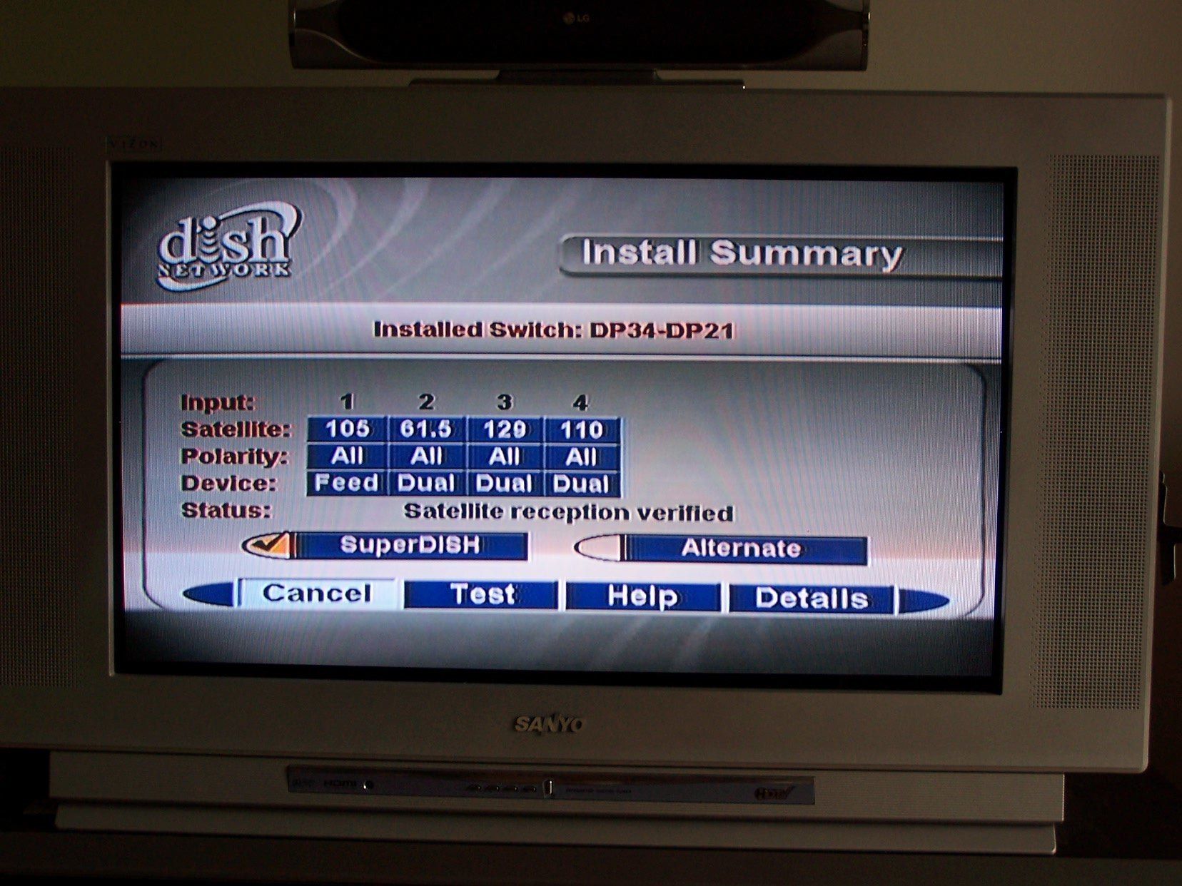

Did you need to change any of your settings on the 942? Or did it automatically detect 129?
You can bet I will be playing this weekend. Let's hope I can get it here in the North East.
I took it off of super in the point dish screen and unchecked super in the switch matrix sence i wasnt running fss anymore. other than that everything was plug and play. Anyone know what those tp freaqs are im trying to point im FTA that way and im not picking up those tps when i scan 129... I dont think im on it exactly

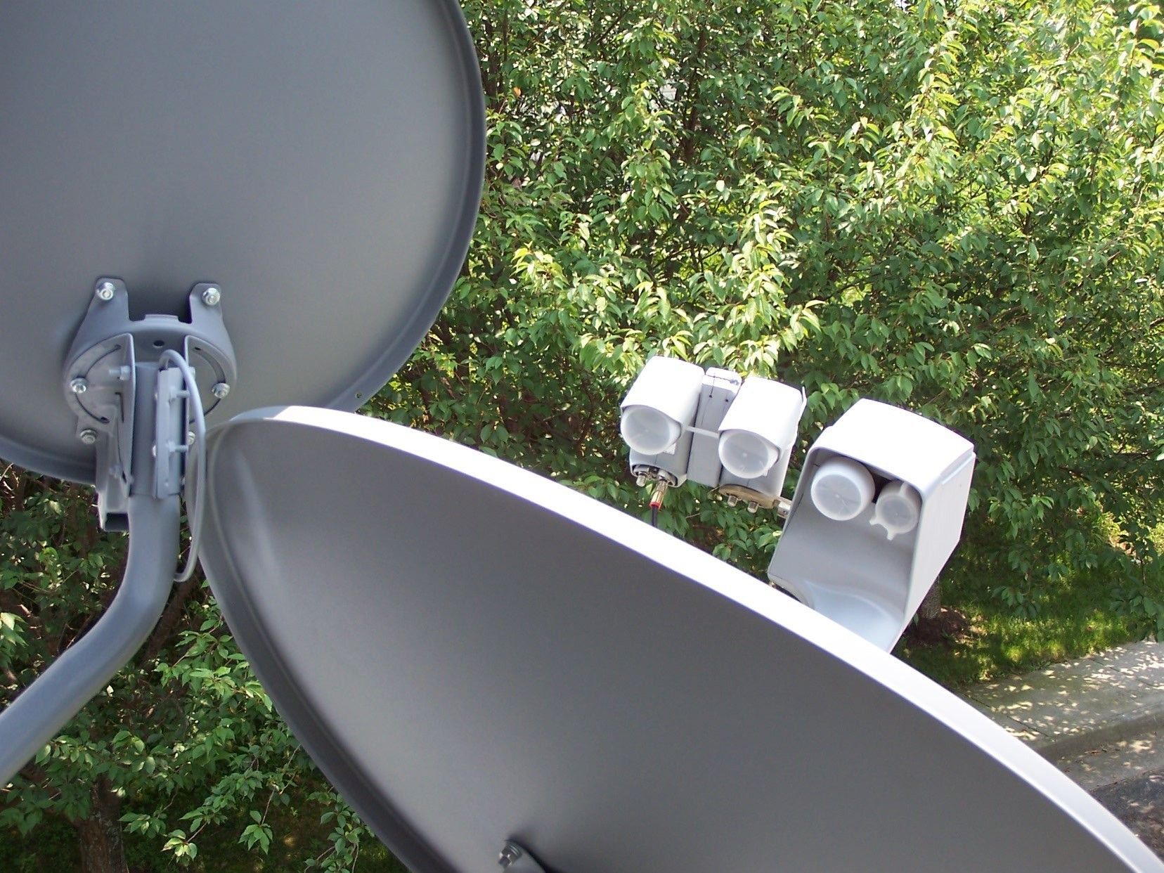

I made a few attempts with my SuperDish105. I'm calling it a SuperDish1105. :D
I wasn't able to get 129 to lock up on this arrangement on my first trys and the mosquitos are too thick to keep trying tonight. But I was able to keep 119 via the twin LNB and got a 50 on 129 while hand holding the dual LNB to the right of the bracket. I may try again some day.
I've settled for installing my old D500 and pointing it at 129-119. It is a lot easier than mounting another LNB as an outrigger on the outrigger. And the new D500 location has a better LOS to 129 than my SD105 location.

how would you point a dish 500, with a single lnbf, I tried connecting the dish straight to the 301 receiver, that didn't work, so I connected the dish 500 to a dp34 switch with 119 and 105, ran check switch, got conn in satellite, x in polarity and sgl in device. I used an elevation of 48.6 and azimuth of 186.0 , no skew, my zip is 91739. On the dish pointing menu I select satellite 129 trans 15, I move the dish 500 a little, but the signal strenght says I'm on the wrong satellite 119, which the superdish is, what I'm I doing wrong. HELP
your azmuth is 199 elevation is 48.5... Nice hit out there in cali.. move that dish 500 / aka 300 more west... and you should hit it with no problems.. are you using a sat meter? It beats using the point dish screen.. also if your hitting 119 your mast maybe unlevel. you might have to raise that elevation a bit to conpensate. make sure that the skew on the sd is set to 0.. as your not hitting two sats. only one. if your using it to hit 119 and 129 then your on your own becase i have no idea what type of skew you would need to accompish that.

The setup I'm using is the 105 superdish with only 119 no 110 and a dish 300 for 61.5 into a dp34 switch, I removed the 61.5 and connected the dish 500, fitted for a single lnbf, to the dp34 switch, then run the check switch test and got the above thread result. Don't I have to subtract 14 from 199 azimuth, for magnetic declination at my location? No I don't have a satellite meter, I was using just the point dish screen. Do I need to rerun the check switch test each time I adjust the dish 500, or do I just keep adjusting the dish 500, a little at a time, until I'm on 129? Thank for the help.

Got it running.. 129 lnb needs to be about 5.5 inches center to center from 119 .. just stick a 2x2 (which is really 1.5 x 1.5) in between the two duals and its good to go with some tweaking.
