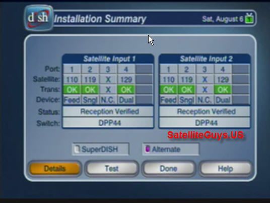

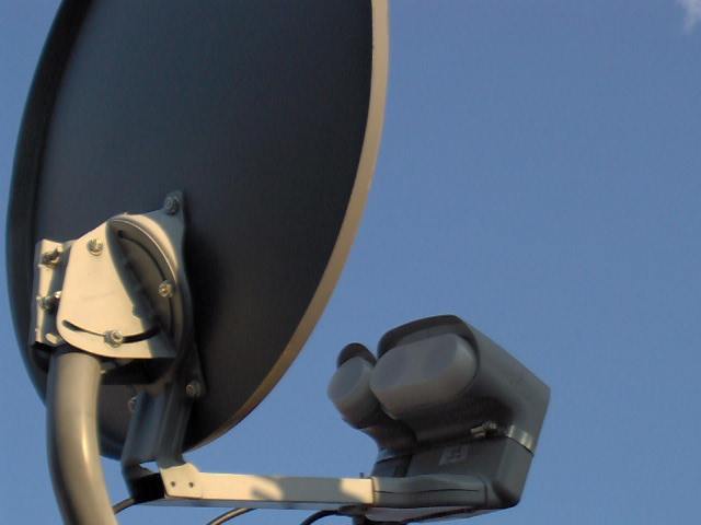

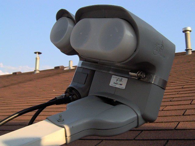

I tried this tonight with my 105 SuperDish and was surprised to get a 75 signal just by holding my LNB about an inch to the right of the 119 LNB pointed to the center of the dish.
I BELIEVE that this is 129. I was using a FTA receiver outside with the frequencies programmed in. Until I can get the LNB tied down I can't be 100% sure but I am fairly certain that it is. :)
But that was all I was able to do as we were hit by a major storm which kicked down a few trees and branches.
Next step is to try it on the Dish 1000. :) (But first I got to clean up some things around the yard from the storm) (They really need to make weekends longer) :D :D :D
I got it!
I hooked up a free to air receiver of it and found a bunch of locals from 61.5 and 148 in the listings however none were tuneable (not even 9001)
John H said at DBSTalk he is seeing some possible HD activity up there as well.
On my 942 I am seeing the satellite but am not seeing anything off of it yet.
This was a fun project. :)

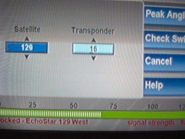

Now on the 942 through the point dish screen here are the transponders for which I can tune to currently
15
16
17
No other transponders are available yet on the 942.

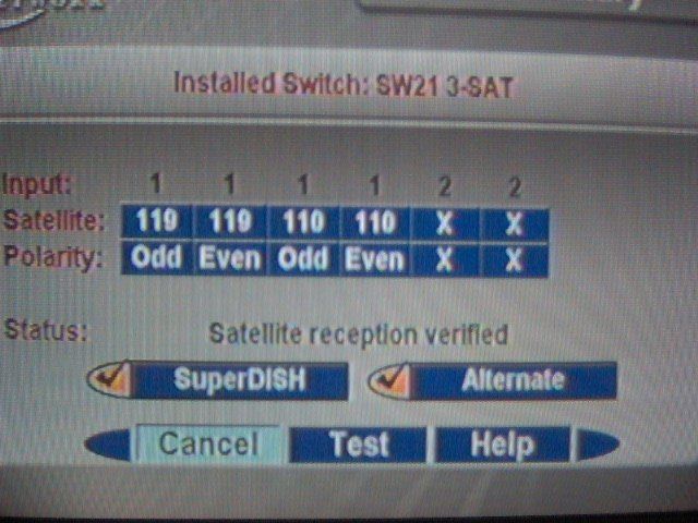

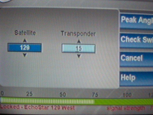

got it on a Dish500 :) m (Legacy too) :D
Only a 75 signal on TP15 (my only options are 15,16,17) but it worked.....only issue is right now it looks like it acknowledges Legacy (because with the SW21 up, I can tune the TP on the screen), but it shows "X" in the spot
