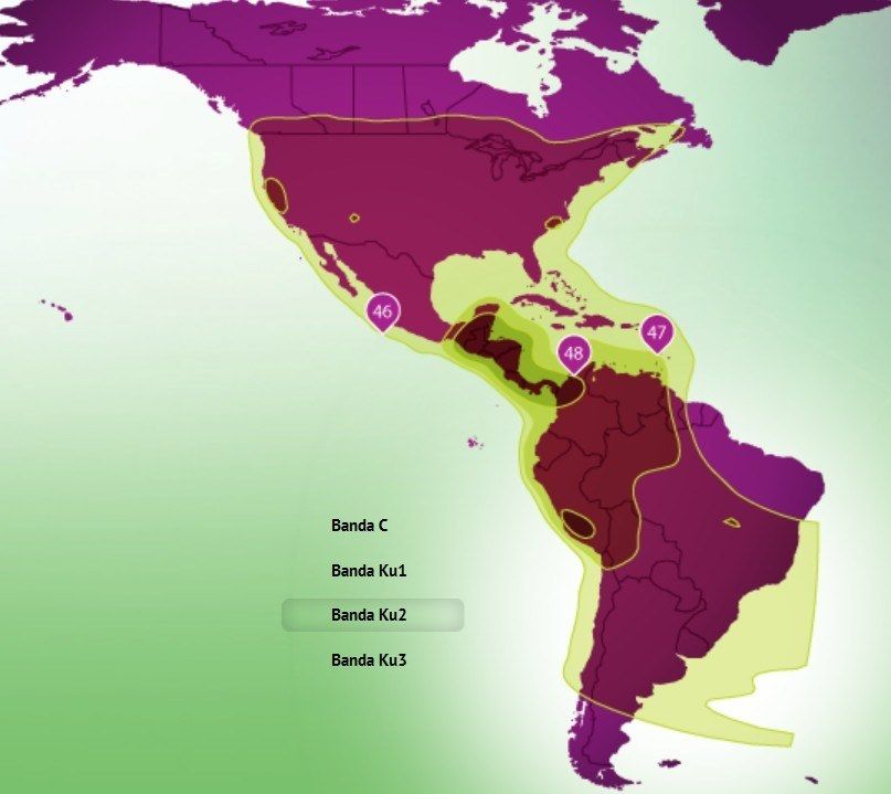

Satmex8 Footprint
Nothing more received other than ESNE. I guess I'm on the edge of the footprint. The footprint boundary runs through my area.

I sure did. I found I can receive ESNE from 116.2W through 116.9W. Note that the centre is about 116.5W or so. Its SQ is only about 10% when centred but picture only has minor tearing. But nothing from the other tps on a 1-metre dish. This is the value of the PLL LNB. There isn't a need to finely aim the dish anymore like pre-PLL days. It's like AFC on a domestic FM radio: plant the dish approximately correctly and the PLL LNB grabs the signal. I used to use diseqc to aim at the weaker satellites, but now I use USALS for the whole arc. Worst case, I touch up the orbital position of satellites at the ends of the arc if USALS doesn't catch their signals.
ESNE is probably the strongest signal on that one. When I try to move it back to the correct 116.8 position, that's the only one I get, even with my PLL :)
