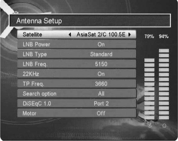

screen shot
Here is a pic of what that signal screen looks like.

OK...that whole thing is whack
satellite needs to be Nimiq1
LNB Power is on
LNB type is standard
LNB Freq is 11250
22k is OFF
TP freq should be 12224, 12239, or something like that
search option should be "FTA" or "Free"
Diseqc should be OFF
motor off

I know that, this was just a pic I took off of the manual Iceberg. I know its set somewhere else. I just tried to find you a pic of the menu. Sorry I should have specified.
