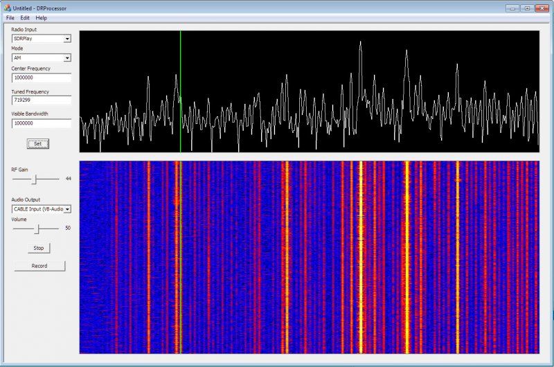

I'm making progress on my first SDR Program, tentatively named "DR Processor" which stands for Digital Radio Processor. I am open to suggestions for the final program name.
So far the program has just some of the core functionality. The controls on the left will be completely redesigned for the released version. I just wanted to put something there quickly for testing and development. Those numeric entry fields will be large clickable digits for easier control.
Also, of course, I need to add numeric labels and lines for the signal graph on the top and a LOT of other things.
Anyway, the basic framework is there. The hard part so far was creating multiple processing threads for the input, conversion to baseband, filtering, decimation, demodulation, and audio output. This was needed to spread out the workload among the four cores. And then there was the challenge of getting them to communicate with each other in real time, and fast enough to process up to 10 million incoming raw IQ samples per second. I had to resort to using SIMD instructions (single instruction multiple data) for the time-critical portions.
Now that the hard work is done, I look forward to giving this a decent interface and implementing some features I have not seen in other SDR programs.
