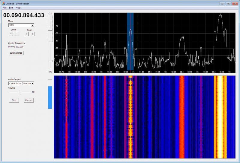

Looking forward to seeing this. Got any early screen shots? or are you just going to wait for the first public beta?
Reactions: N6BY
... Got any early screen shots? or are you just going to wait for the first public beta?
I have attached a screen shot of what I have now. Compared to the previous one I posted -- the signal graph is labeled, there is a frequency digit control, some slider controls for adjusting the range of the signal graph, and a signal level display.
Almost everything on the left side of the screen is a work in progress and very likely to change before the first release.
Today I got the volume control working and started on the signal bar.
The screen shot below was reduced in size and the lines in the signal graph seem to have been lost.
