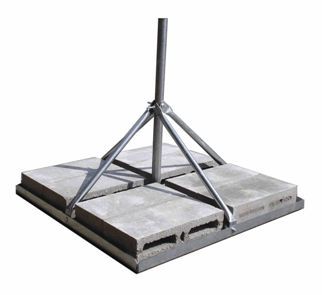

In this case a bucket wouldn't cut it . You need something like this. Others with active C-band can chime in about Disney.

Actually, a 6' dish in a 15mph wind has more horsepower than you. So you would need a bucket of concrete bigger than you can move. So, bad idea. If you want a fixed dish that you can move at times, go for that. Instead of a pole they use an adjustable frame. The frame could be easily secured to the deck, or weight it down with a bunch of sand bags.
The link isn't working.
The link works for me. Anyway, I have attached a picture below. I see FAT Air has provided a different, link but similar product.

That can hold a 6' dish? My wife probably wouldn't like that on our deck. How wide is it? Perhaps I could plant a garden in that square shape to make it look nice.

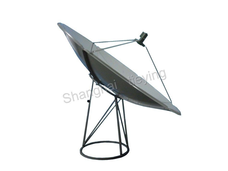

I'm considering a dish with a mount like this. I'm not sure, but is this specific mount called a "ground mount"? Sadoun's website isn't clear on that, and if I ordered a dish, I would be interested in one like this.
Iceberg, I saw some pictures of your various dishes you posted on your deck, and this type of dish was shown. You used sandbags to hold the mount down. I was considering that and wondering if it works well.

Andrew, yes that is what we call a "ground mount". That is how the Fortec 6' dish used to be.
