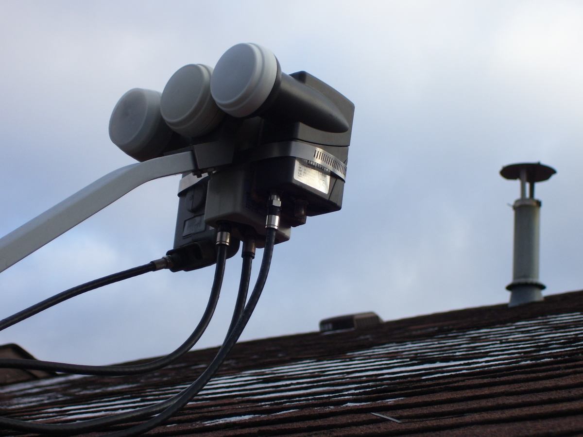

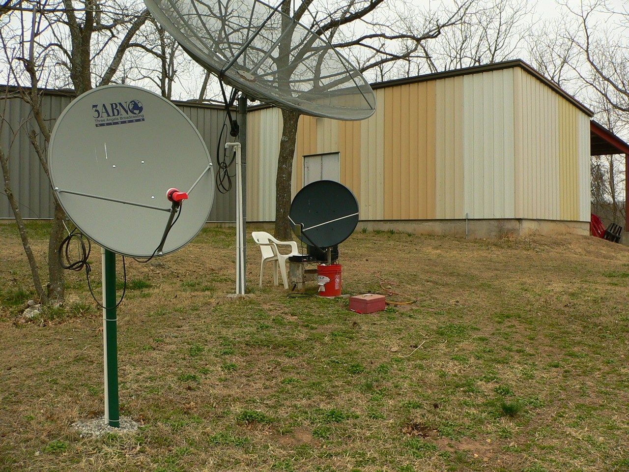

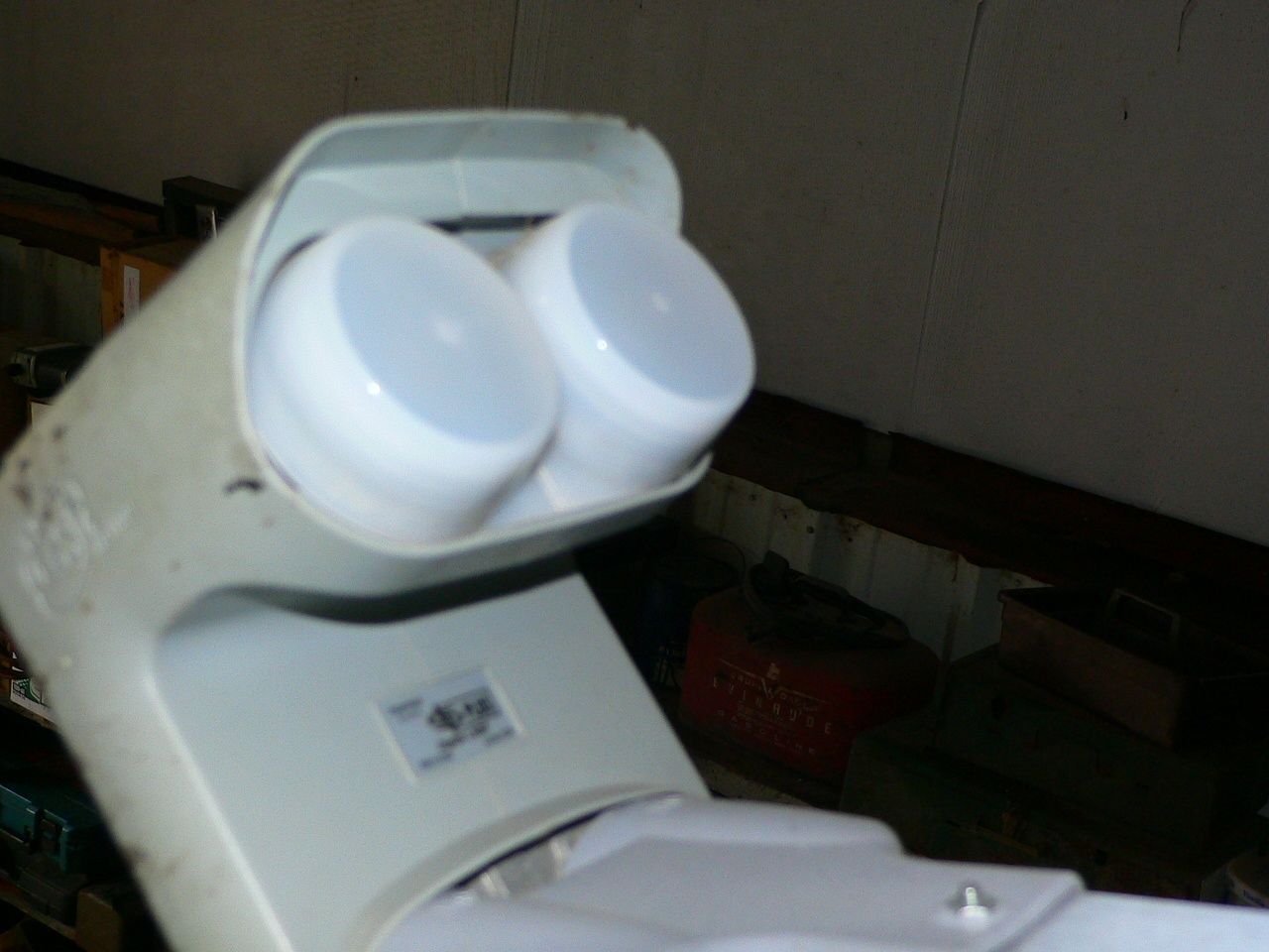

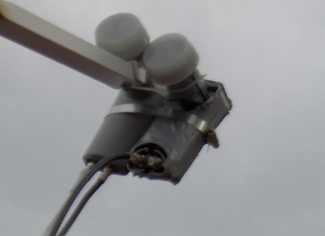

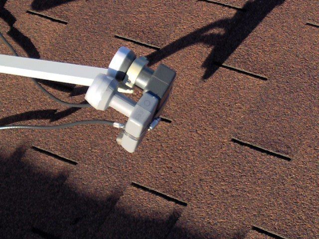

various pics of a DBS & KU LNB on one setup (some still have some don't) ;)

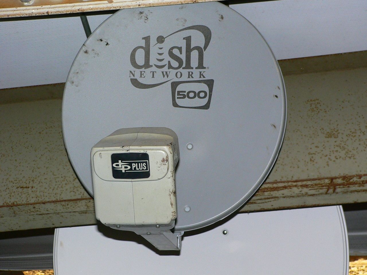

If that doesn't work might try investigating the Dish 500 caper, here a pic of the LNBF I have:

See if there is any dish 300 junk around your area, and put the DP single with the straight plastic piece on that dish 500 instead of the "y adapter" and dual lnb.
Lots of them around that were used as wing dishes for 148, and for 61.5. Aiming it with a meter is a breeze.
It's so small that with a couple of u-bolts to hold the mast on the tower you're done in 30 minutes. It'll take longer to blindscan...LOL
See if there is any dish 300 junk around your area, and put the DP single with the straight plastic piece on that dish 500 instead of the "y adapter" and dual lnb.....

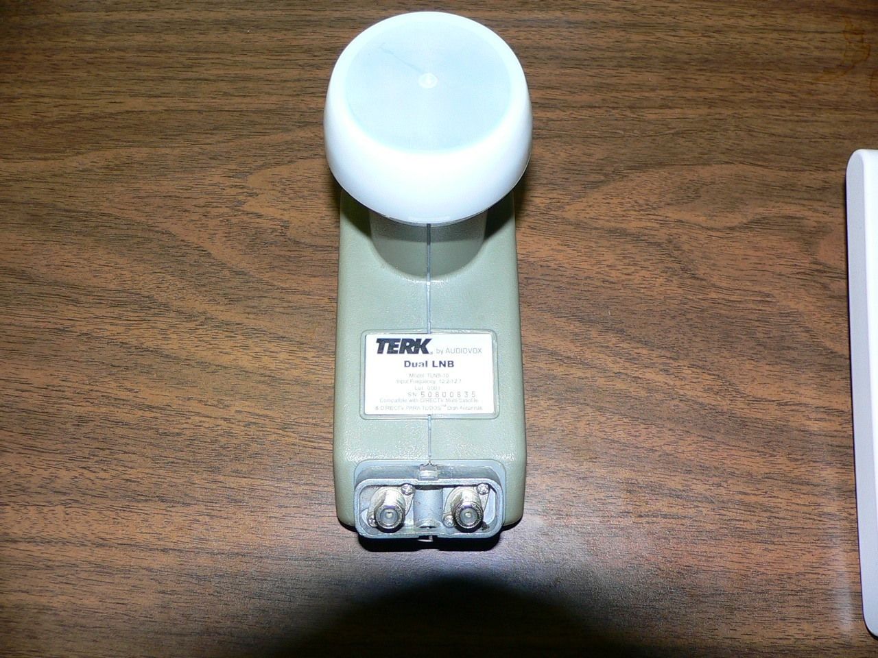

If I got the wing dish pointed to 148W, could I use that 4th input for the Dish 500/Terk unit, run a check switch routine, and view the FTA signals through the 811 receiver?

The Terk LNB is Legacy not DishPro (voltage controlled, not bandstacked).
So, it won't plug into the 1000.x
Your 811 won't recognize un-authorized programming.
So, you're out of luck twice, on that approach. - :cool:
Best bet would be to put the Terk on a small dish, connect it to your FTA receiver (with a diseqc switch, or whatever suits your situation), and be done with it.
If you have other small DBS dishes, post a model or picture, and maybe we can offer some alternatives.
Is the center LNB in the last picture the one from Bell Express Vu? Got one just like it from Ebay and thought the seller made a mistake and sent a circular LNB because I did not know that BEV also use linear. Sat in the pile for a while until I read your message about your own BEV LNB.

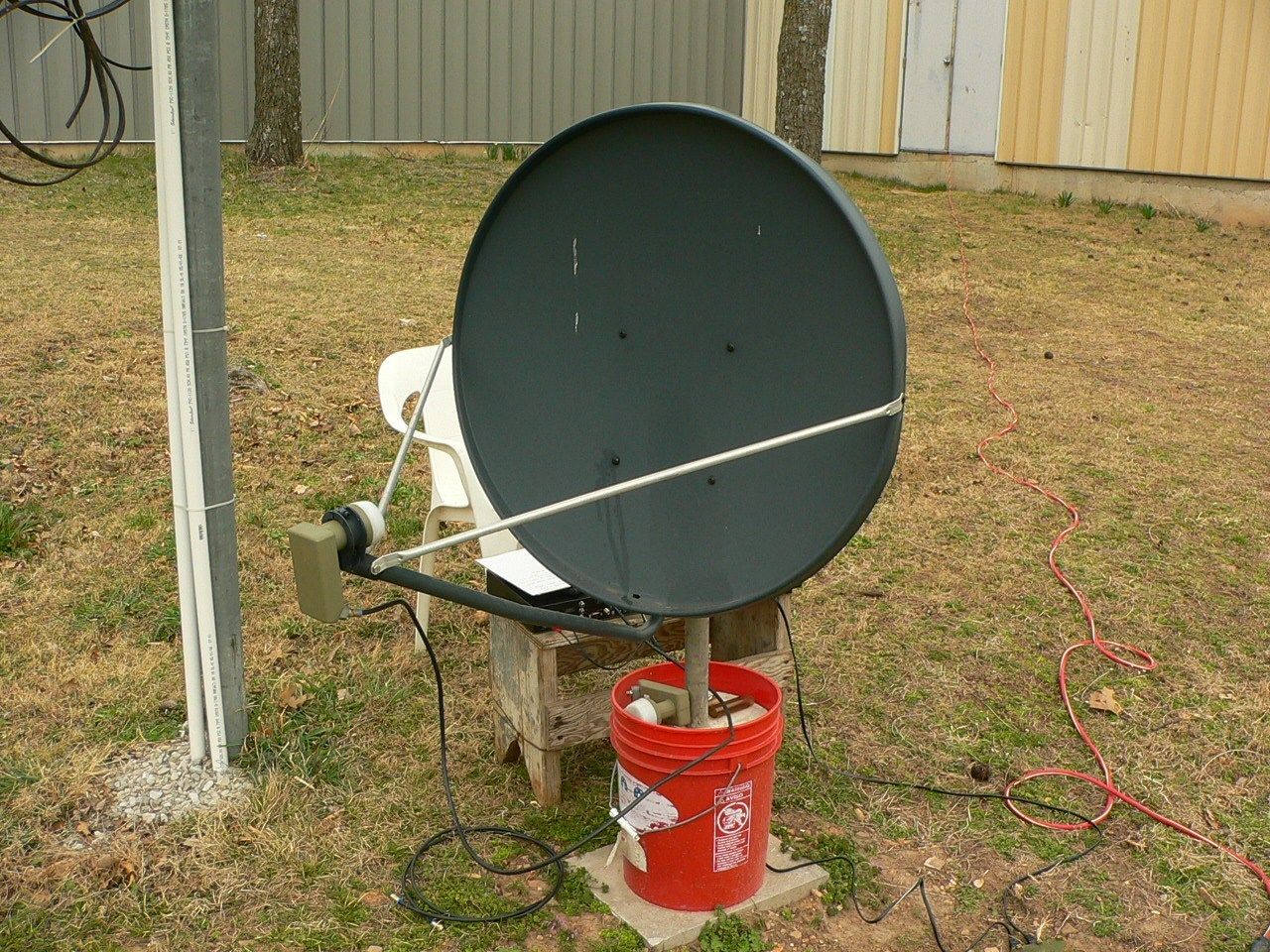

Decided to put the Terk LNBF on my BJU 90 cm....with a little help from dishpointer I had my Coolsat 6000 locked on to the strong transponder from The List (12224 V 20000) in about 2 minutes. :cool:
Sure, it's scrambled, but it taught me that I could get to 148W (19.5 degrees elevation) and was a fun experiment.
Thanks to all for the help and encouragement. :)
