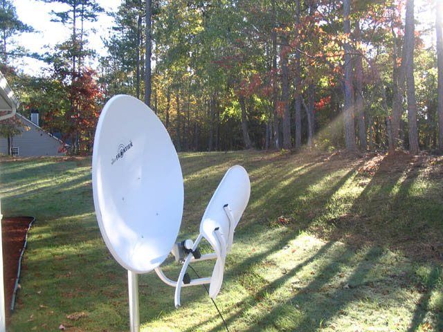

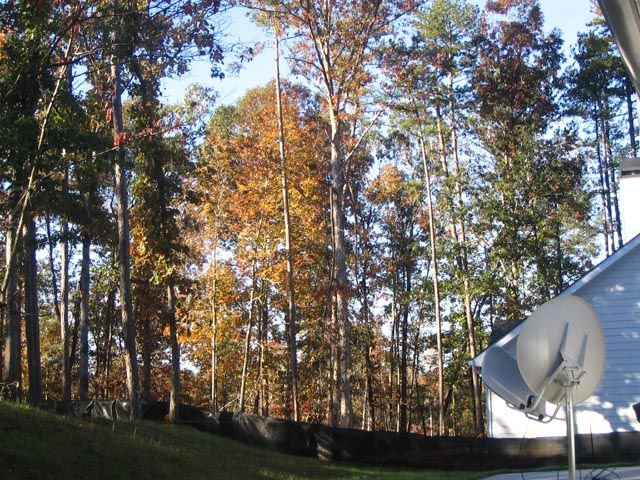

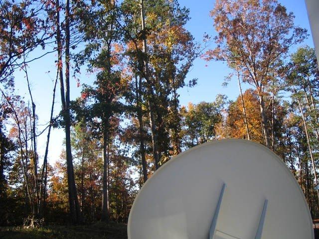

Ok here are mine.
Notice how i have several trees... they aren't that thick, mostly pine trees but i believe they can play a factor. When i was prepping my spot i was just figuring out 0 degrees was parralel to the ground 90 was straight up... so in between with my arm pointing at the sky, i thought i had enough clearance... Now that i look at the dish and how it's poiting right at the trees, i'm getting worried.
Note that most of the trees located to the left of the antenna will be cut in a very near future. Leaving only those to the right (which belong to the neighbor).
On the picture i took from far behind, you can actually see the irrigation blanket that seperates my lot to my neighbor's. All trees located on the left of this blanket are mine and will be taken down.
So what are your thoughts? Is it a viable location for the dish? With and without the trees?

Distance from a object is your most important factor to consider. Can you install that dish farther from the trees? (Other side of your lot?)
All in all, looks like a very bad LOS location to me. Satellite signal don't go through trees. You need to do a very detail LOS survey(using a scope). The effort spent in determining what location will work would save you a lot of head aches.
I believe i'd have as much trouble setting it up on the other side of the lot. The other thing to consider is how far i can go from my electrical box where i actually connect my cable to send it to the proper outlet inside.
I've heard that over 100 feet of coaxial cable can be bad for the signal quality.
I guess the other thing that kinda made me thought i could put it there was the fact that i was getting such a strong signal from 110. I guess it's really peeking between 2 trees or something.
