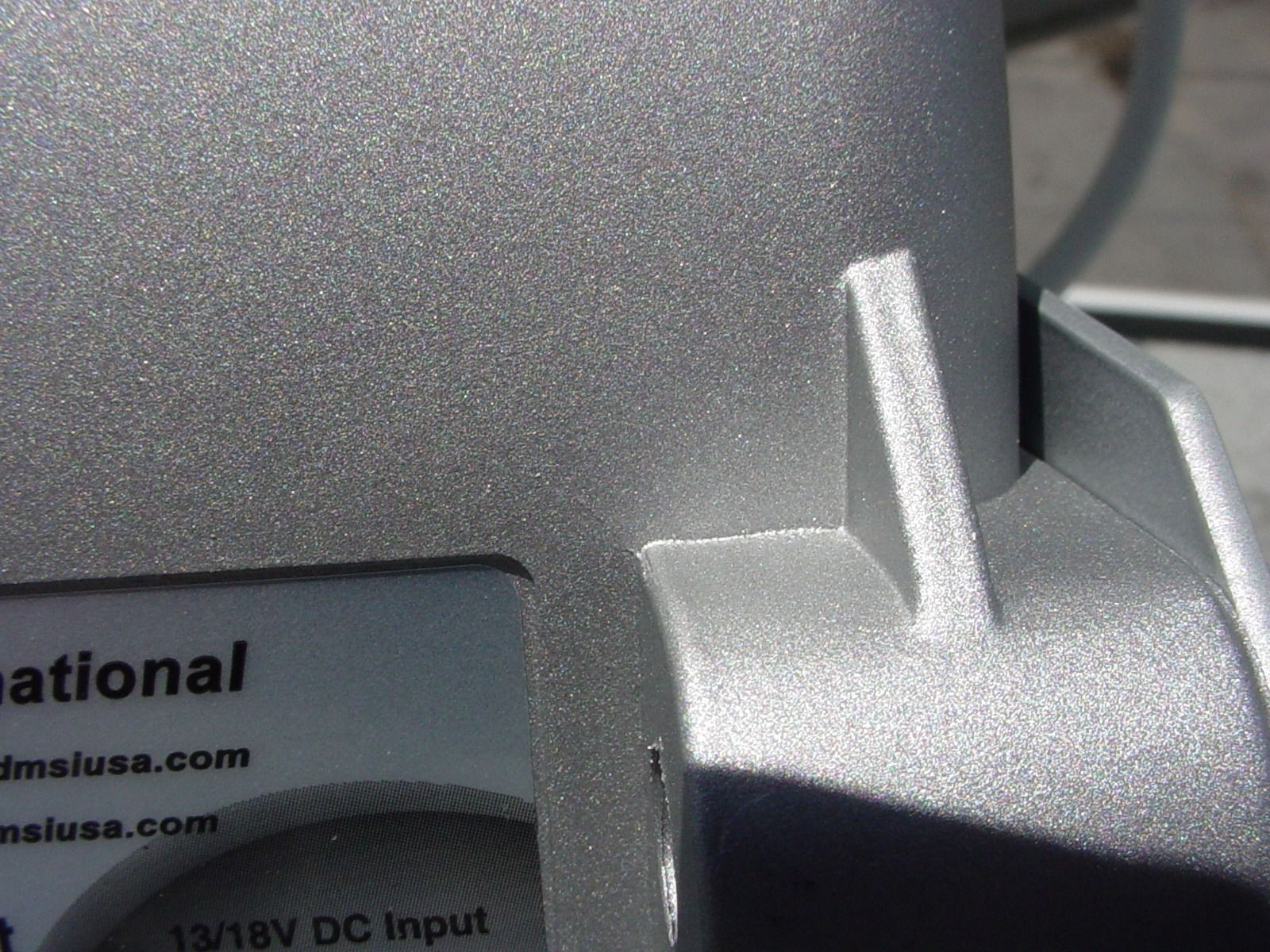

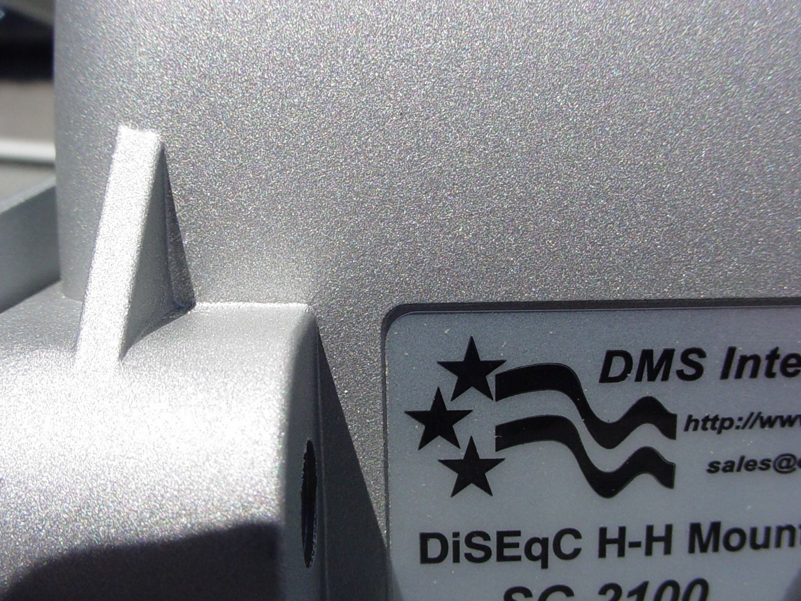

Did you get any pics of the setup (in particular, the offending mark on the SG-2100 motor ;) ) :D :D

Cool... looking forward to them. I'm pretty sure with all the feedback that the mark is just casting, but I just want proof :)

Great! Thanks, now I should be able to put my fears about a cracked casing to rest :)

I just snapped the photos.. about to pull them off the camera..
its hard to see (its too sunny today) but its definately there.. if you look very carefully, you can make it out

Thanks Ultatryon! I can see it well in pic 1... Looks just like my motor...
