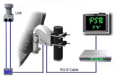

See the below diagram for the correct way to install a switch in a motorized set up!
That's how I setup my FTA.
