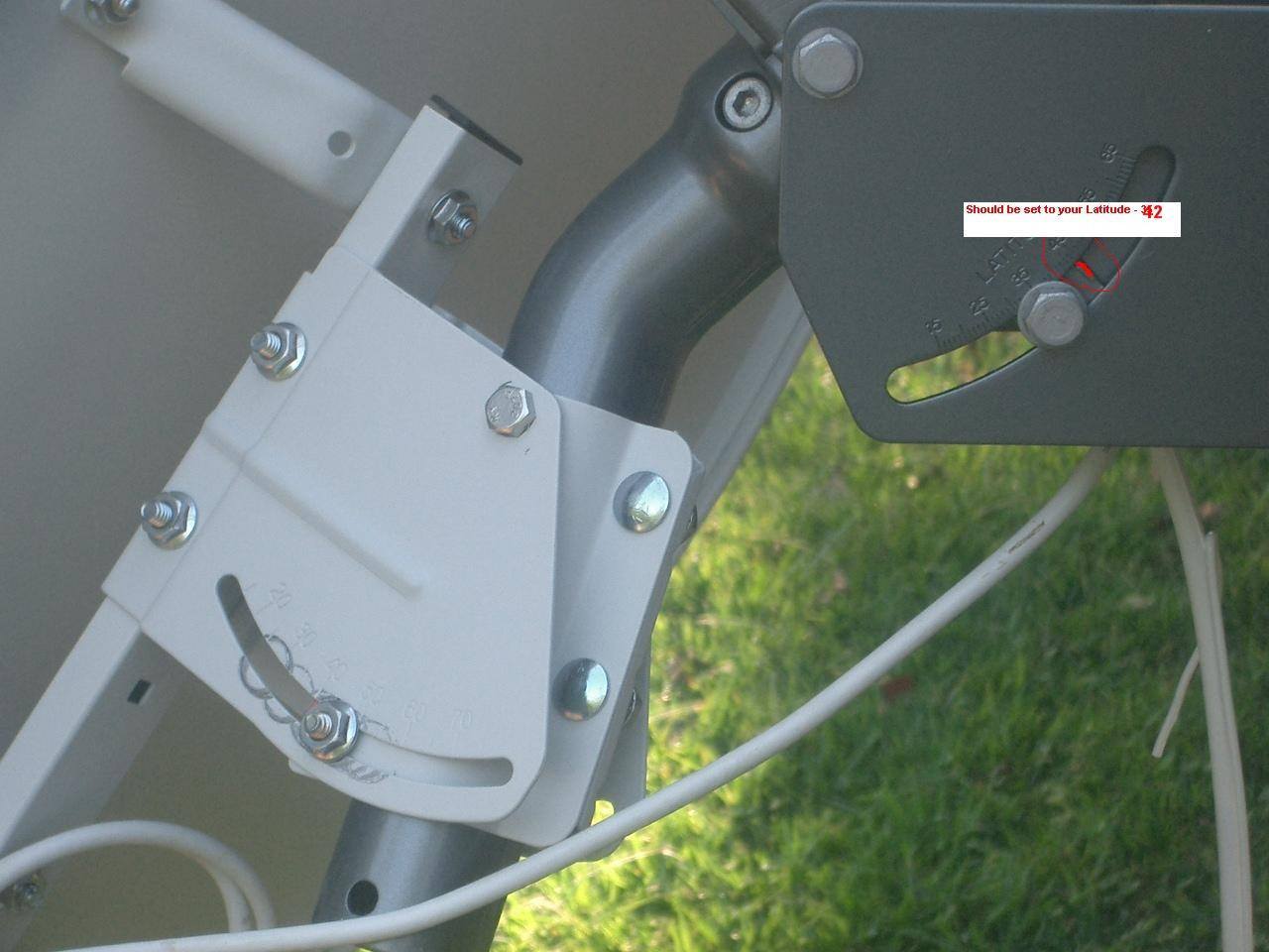

motor latitude is the same as YOUR latitude (42) and dont touch that after setting it

Motor Latitude: 42.3°, same as Your Lat. Use the Lat scale on the motor
Dish Elevation: 23°
Azimuth (mag.): 164.2° using Compass
Make sure you know where the guages / angles should be set, they usually are Not the Bolts.
