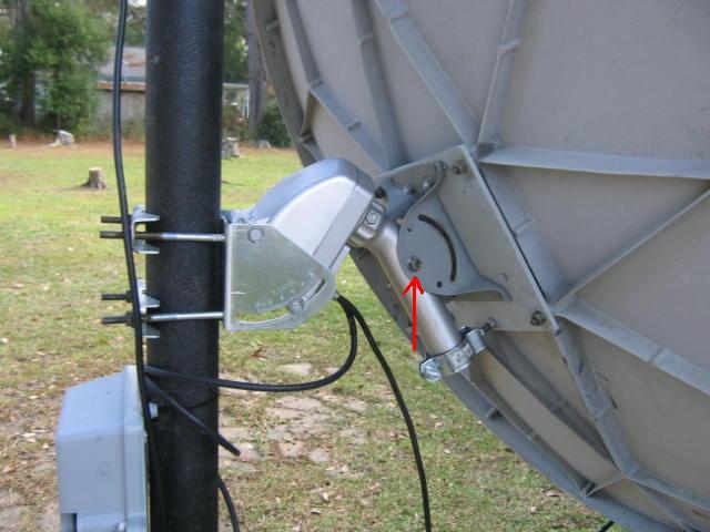

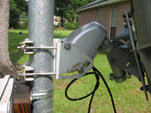

Is there any play in your pivot bolt that attaches your dish to the motor tube? (see red arrow in your picture) Is centre line of the motor tube lined up exactly with the centre line of the dish? When the motor is set to the zero position, the dish should be square to the motor and mounting pole. If you loosen this bolt, will the dish move a few degrees in either direction?

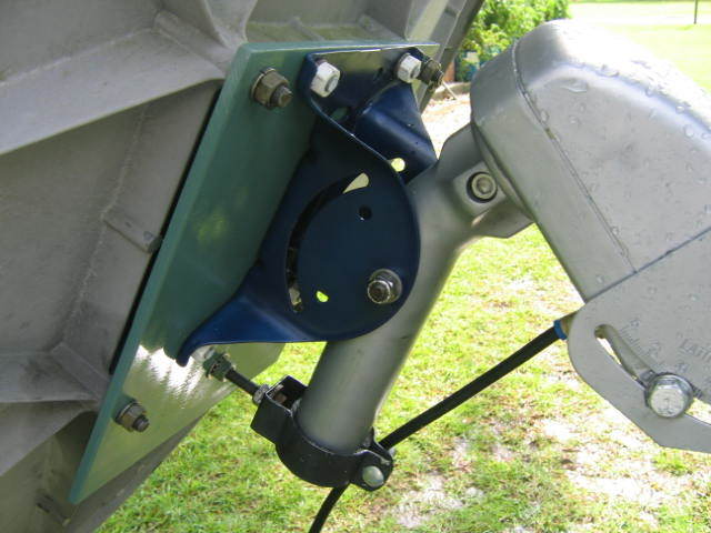

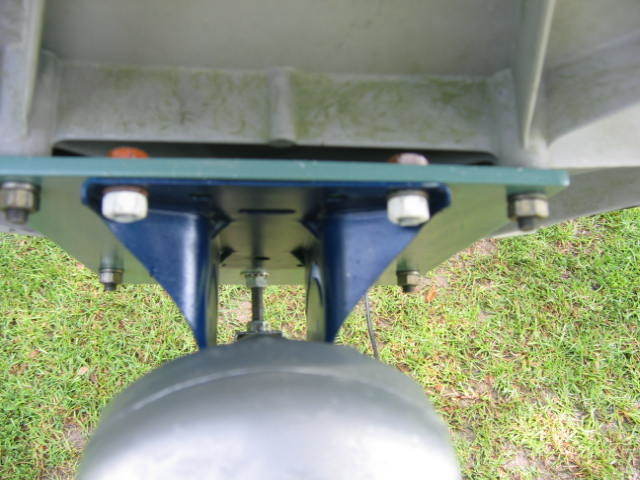

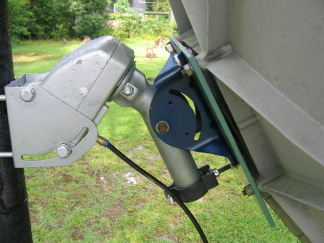

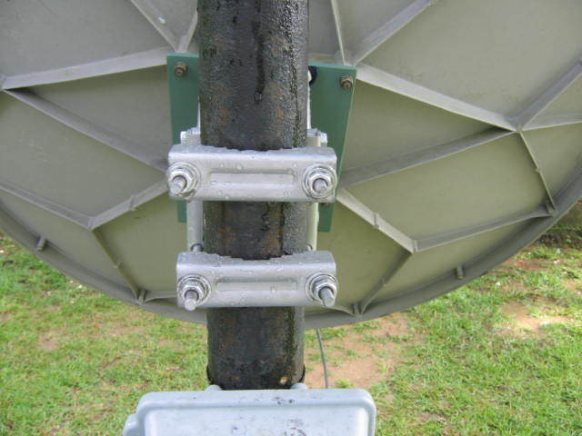

I figured I'd dredge this back up, because I am having the EXACT same problem again. I have been fooling with this setup for about 30 hours total the last week or so, it isn't my main dish so its not a priority. I STILL cannot get it to track properly. Thinking it might be my homebrew dish adaptor plate, I made another whole setup, bolted it to the dish, and gave that a go.
Checked the plumb of the pole, perfect. I can zero on my TS satellite (G11), with 97% quality (pegged out) on the CS5000, but move it to G18 and its junk. Its not on the satellite, and the elevation is screwed, I cant even nudge it in.
I tried moving the elevation of the motor one degree at a time up and down, then re-tweaking my TS satellite, tried again, no difference.
I have had trouble with this pole since I put it up. I took my other dish down the other day to re-position it, and I had it tracking the arc in five minutes. So i know my technique is sound, there is SOMETHING in my other setup that is throwing things out of whack.
I even tried another motor setup, one of the 10.00 motors, I changed out every last nut and bolt, brackets and everything. Same thing.
I am at the end of my rope. I was concentrating so hard I smoked my cigar until it burned my lip...:D
Lay ya thoughts on me, fellas. I'll have some pics for you, Brother Anole, as soon as the rain stops.:up

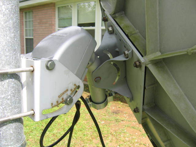

And here is the OTHER setup that works perfectly.

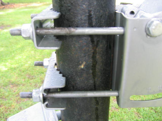

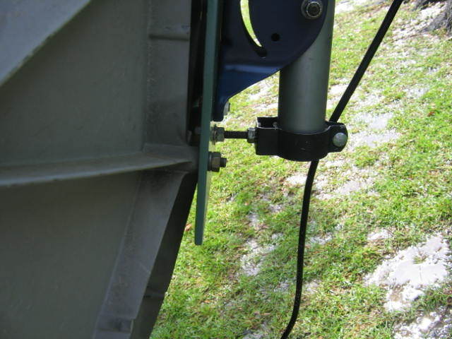

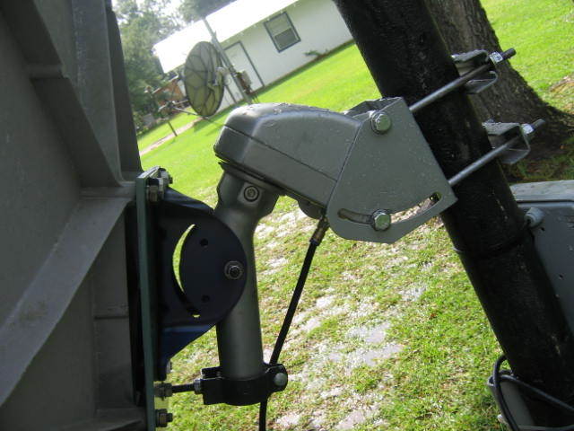

Well, it looks to me that your bracket is twisted, the u-bolts are not even, one is to the right/left of the other(looking at the picture from the rear of the dish). Also, there are more threads showing beyond the nut on the bottom u-bolt.....bracket is closer to the pole on the bottom than the top. Have you put a level on top of the motor, at the back on top of the mounting bolts? Its hard to tell from the pictures, just a few things I noticed off the bat. Light another cigar and pour a tall one, it will jump out at ya eventually:D
