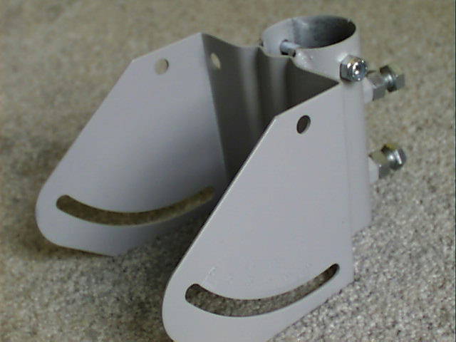

SG2100 Bracket
I found that the crimps put in the back of the bracket to form a nest for the mounting pole were not made right and this caused one arm to be higher then the other. Before I install I set the bracket on a glass top table to check for wobble.
