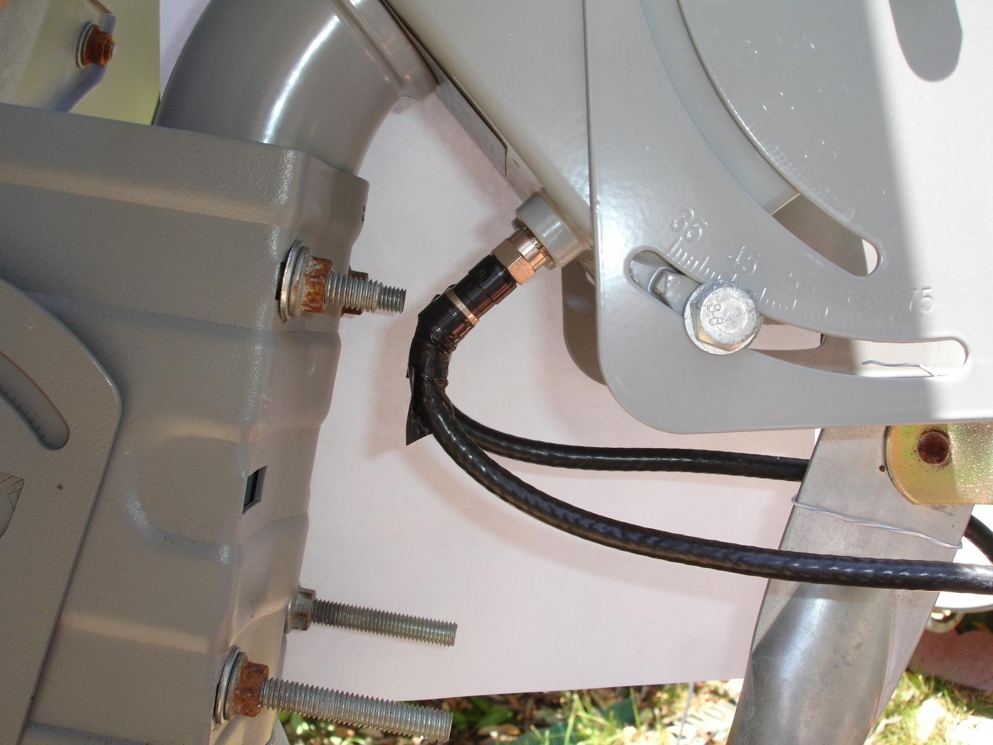

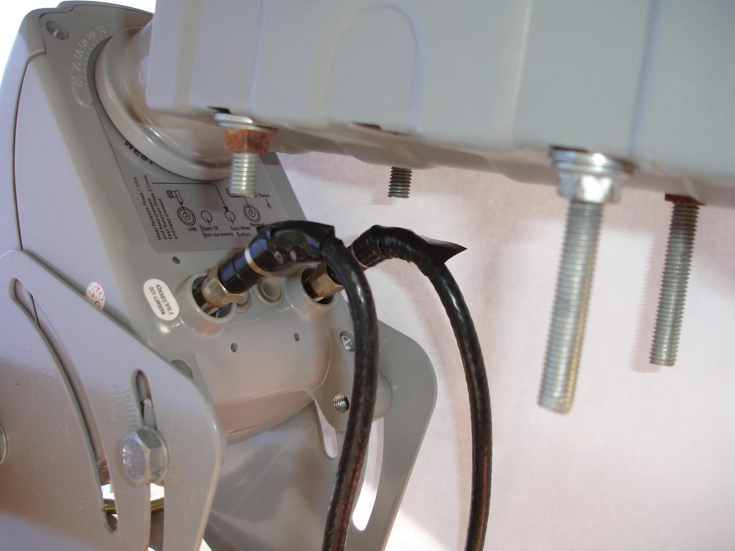

I had the same issue with the SG2100 so I cut the dishes mounting bolts and used tie wraps to hold the wires back. I am using the same setup with the SG9120.

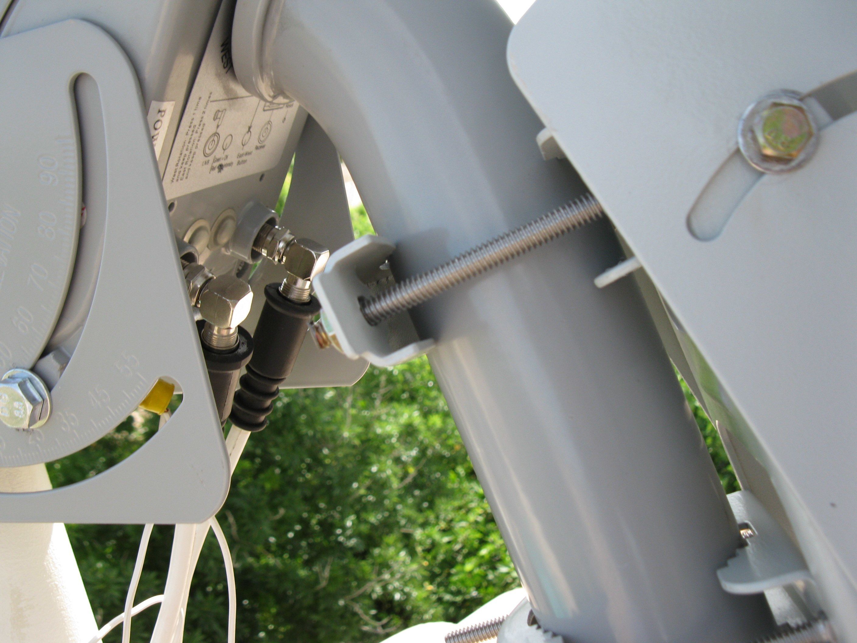

Yeah, that's an issue. I used 90 degree fittings plus I cut those bolts back.

thanks for the pics.....seems like a poor design to me.....i guess i will go with the 90 degree adapters.....
