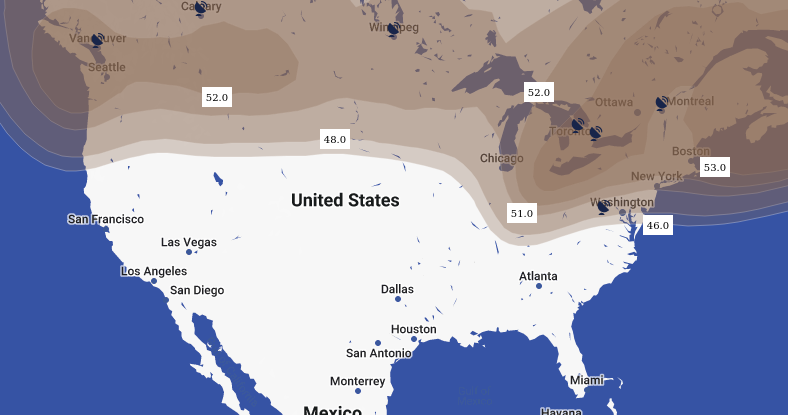

Also, during the brief time that I had my previous channel listing, I noticed that some channels, such as KTLA, which have moved to G1, were showing a signal of 0, but with a strength between -2 and -3 dB, with occasional drops to -10 dB. Does this suggest that I might get the new signal at my location if I had the new receiver? Telesat's extended ku-band footprint map shows me maybe a couple of hundred miles south of the "46" line, much closer than folks in Arizona. It's probably hopeless, but maybe someone more knowledgeable has some thoughts...

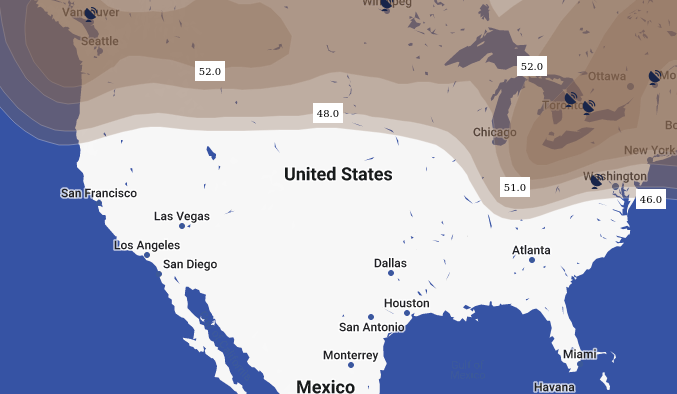

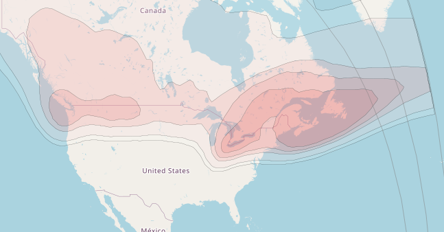

You're giving us conflicting stories: Are you in the Southeast of the US or are you in the Southeast corner of Canada? It has been established that G1 is effectively invisible from the Southern half of the US.
I'd specifically referenced the numbered Telesat footprint map in an earlier, detailed post.
Is it this map you obliquely referenced?
This isn't any more optimistic than the Satbeams map. The calculator shows that an 80cm dish is required for an EIRP of 46 (i.e. Bowling Green, KY) and you're well outside of that contour -- perhaps in meter+ dish land. Consider yourself very fortunate that you can get a signal at all.
