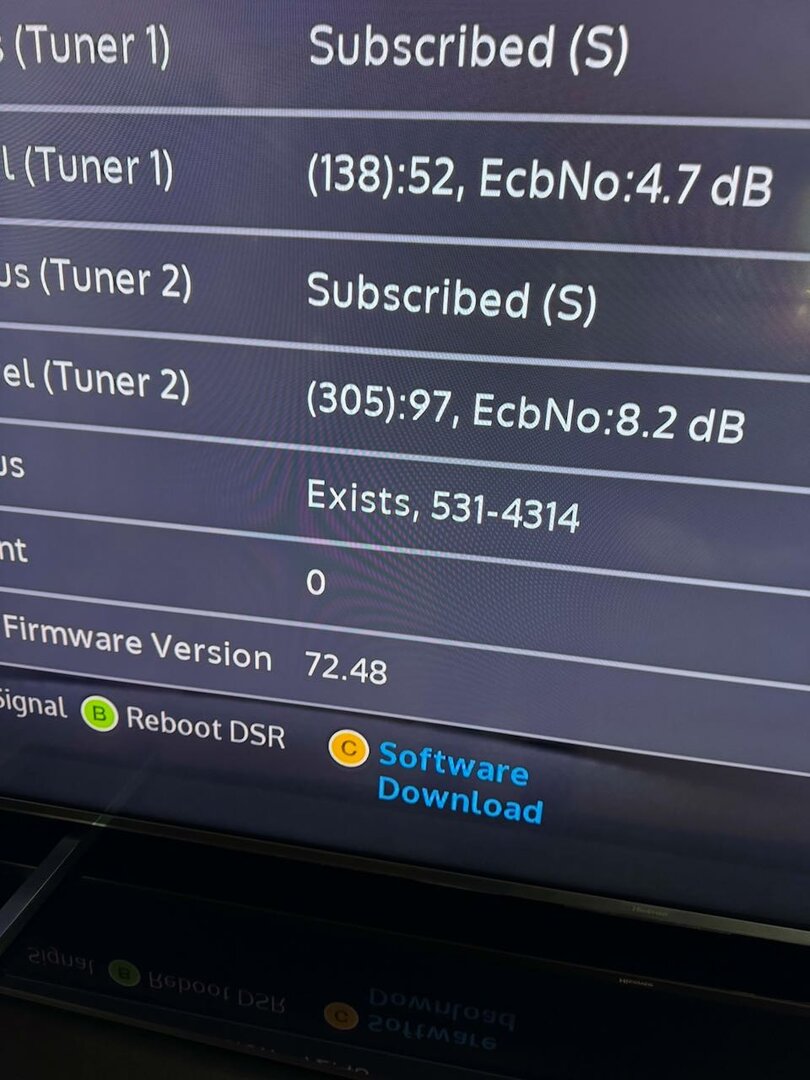

I am east of Sacramento near Folsom Lake and found a GeoSatPro 1.2m dish awhile back so I ordered the F1X LNB from KuSat to play around. I am about 200 miles from the Oregon border and estimate about 250-275 miles from the lowest contour. I am getting signals in the low to mid 50's on some transponders, with occasional jumps to 60 where I briefly get video. Other transponders can't get a lock and and jump around in-between 0-50 range. This is using the receivers signal meter so with a professional meter I may be able to fine tune a bit, but doubt that would be enough to make it work. Was wondering if I can find a 1.8m dish, any idea how much it would help and at least get the signal to the 60's for some of the transponders?

Does that help all that much with Ku?
yes. In his case, he appears to be right on the edge of the receiver's signal/noise ratio for reception.
Once you are above the C/N magic number the receiver needs for stable signal reception, reception should be decent excepting when weather conditions degrade reception.
