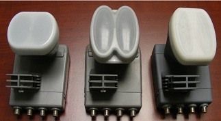

From the picture above, you will notice three lnbs. From left to right: The first on the left is the existing and now discontinue Quad LNB. The middle one is the x Ku Raven LNBF used for 60cm dishes. and the one in the far right, is the new XKu lnbf used for 75cm dishes.

By the looks of the pictures, Triple LNBF might be a misname as I wouldn't be surprised if both sides have equivalent hardware to allow X Ku reception at 111.1. It doesn't make manufacturing $ sense to have 2 part designs when 1 would suffice.
