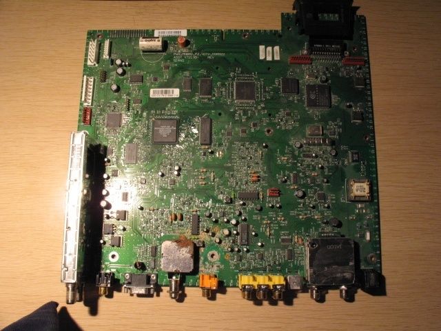

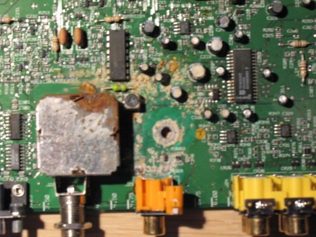

I have a 922 mainboard here from another member for some of the spare parts. It was ruined by a leaking VCII module battery, destroying the functionality of the 922.
Get out your #2 Phillips & remove that module today. Its only 4 little screws & 2 levers to pull it.

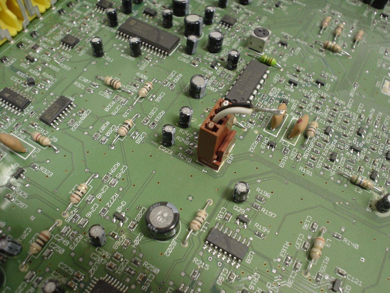

We weren't sure what the connections did. They appeared to loop back to the board. As I recall, the wires were connected together and the plug put back-in, if the attached picture is what you are referring-to. Not sure we had-to, but better safe than sorry.

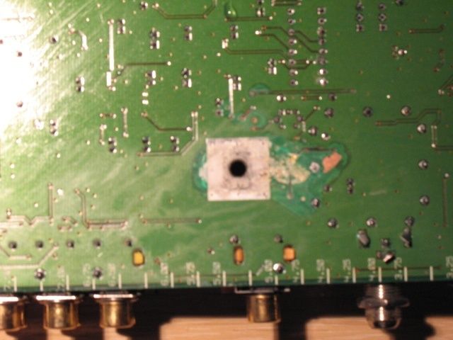

VCII removal?
This is your DSR-922 mainboard.
This is your 922 mainboard on lithium battery leakage.
Any questions?:eek:

I am referring to the cage that is holding the VCII from watching the video on the link on changing the battery, I think it would be the connection that would also connect the VCII when it was in the cage. The video shows the guy lifting up the cage and I can see wire attached but it ended soon after that.

I have removed the VCII module from three 922 receivers. I also removed the cage and the three wiring plugs off the mother board. The 922 runs much cooler with no side effects. Hope this helps.
