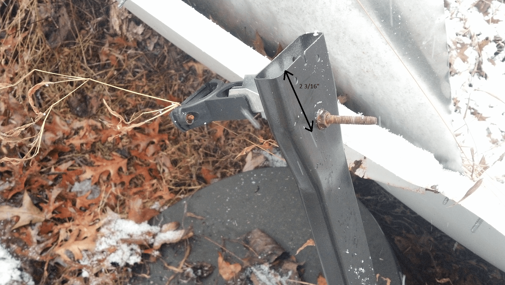

Where did you place your bracket? Attached it a photo of one I done, you can see where I found the sweet spot to drill the hole to mount the bracket.
Yes that is snow in the background it has been spiting it all day.
Glad to hear you got it going!
Thanks !!
Actually, I just used the hole that was already there for the DTV SWiM LNB on the left side.
Think I told you I had the rectangular arm without the flared end. WRONG. haha. Same one you have.

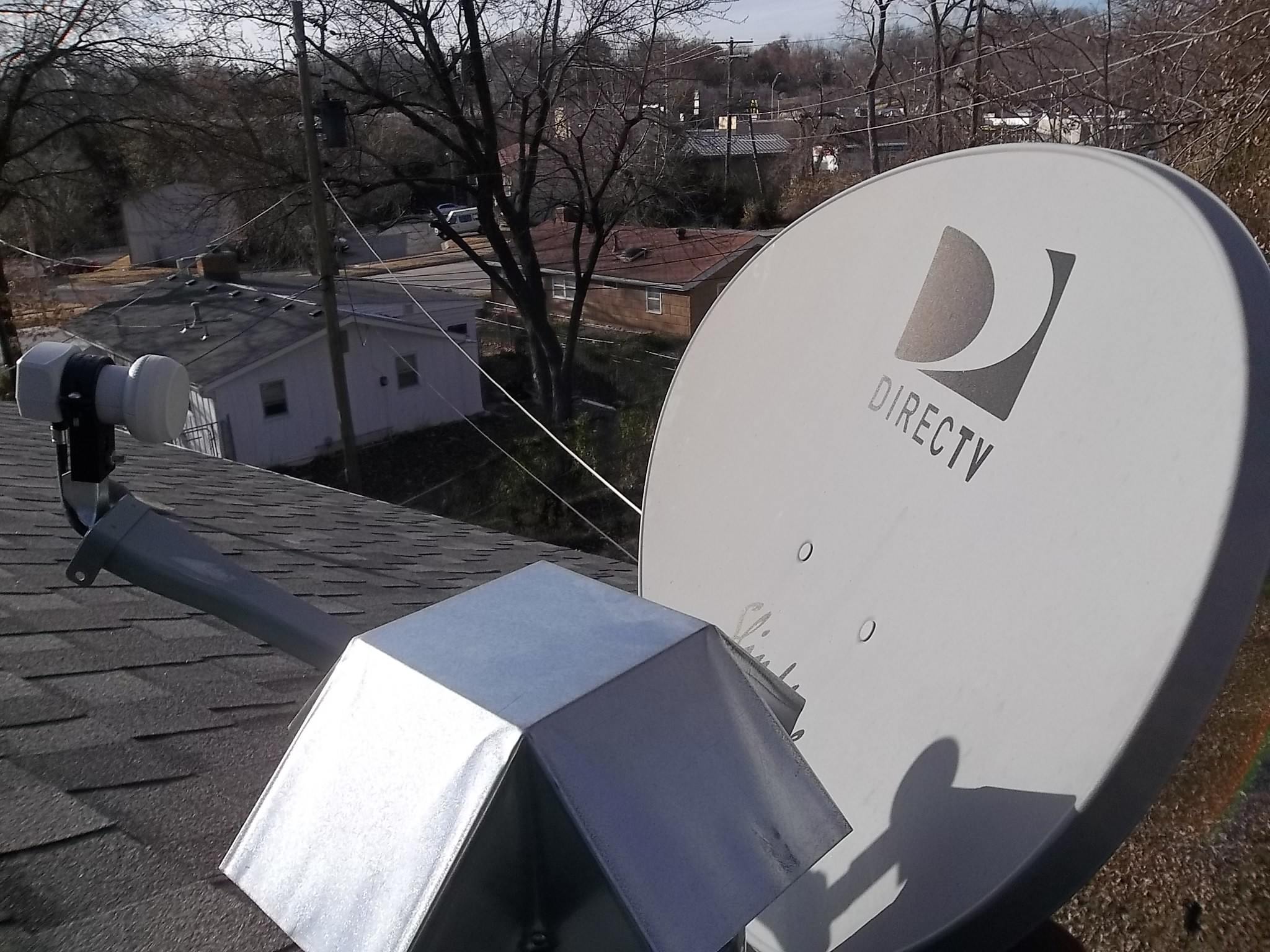

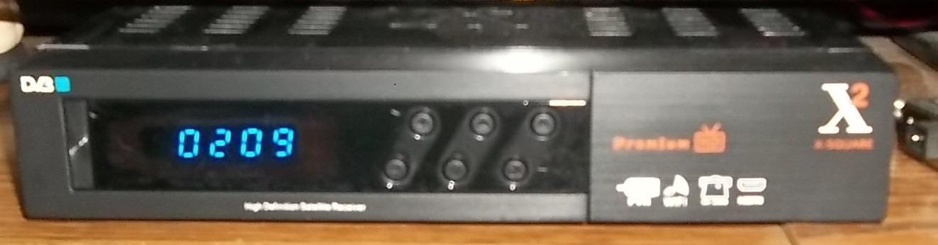

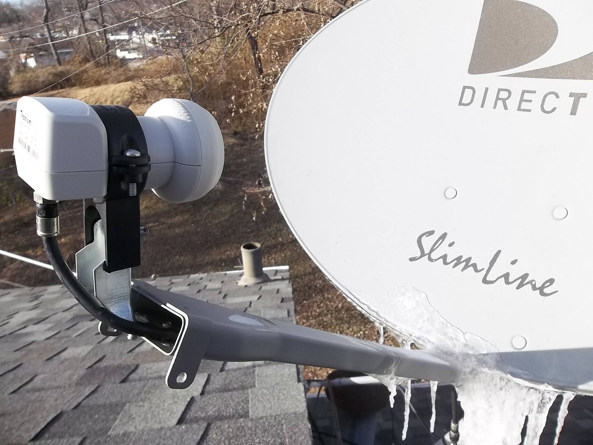

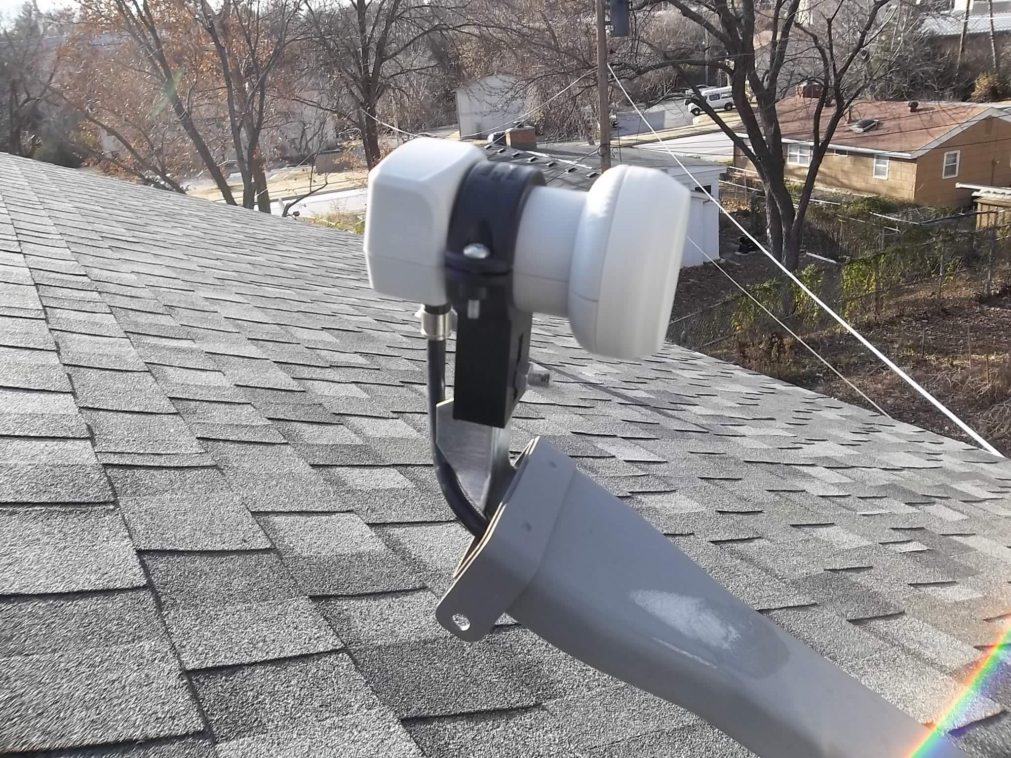

Ok everybody,
I said I was going to get some pic's of my Slimline KU Conversion last weekend, but got busy and kinda forgot :rolleyes:.
Anyway, here they are. (See Below )
Just for a reminder, this is a list of the equipment:
DTV Slimline Dish.
X-Squared X2 Premium II HD Satellite receiver.
Titanium Standard PLL KU LNBF. Single Feed.
LNBF Bracket
Radio Shack Satellite finder.
Again, I would like to thank all those who helped me out with this experiment.
The dish is currently pointed at Galaxy19 97W. I am receiving over 200 channels, not including radio.
Enjoy the weekend !

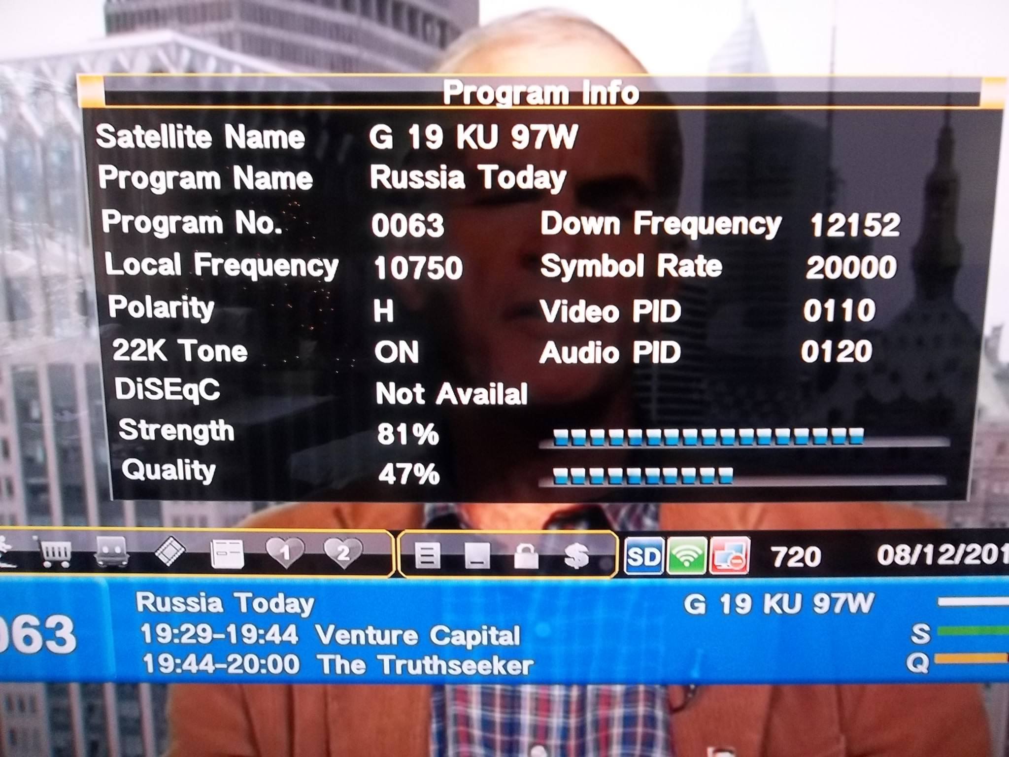

Can you post pics of your signal quality like to see what your levels are? What I use is the 12152 Russia today transponder to test signal quality. If you need just ask me on slimline questions I can help. Talk to you later bud.

Hi Dan !
Below is a pic of the signal info on Russia Today.
It is a little low today. We got some snow. Most of my signal readings are 80%+ and quality averages about 50-53% across all received channels.
Think it might need just a little tweaking, but will wait till it is nicer out :)
