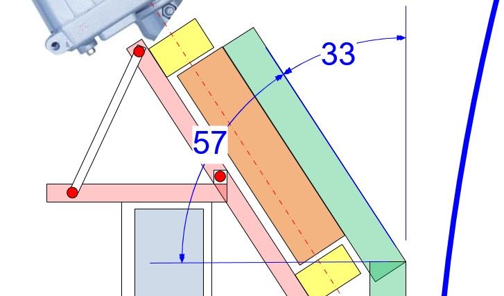

No, it is exactly 33°. If you measure from the horizon then angle will be 57° which is the latitude of my location. View attachment 146320

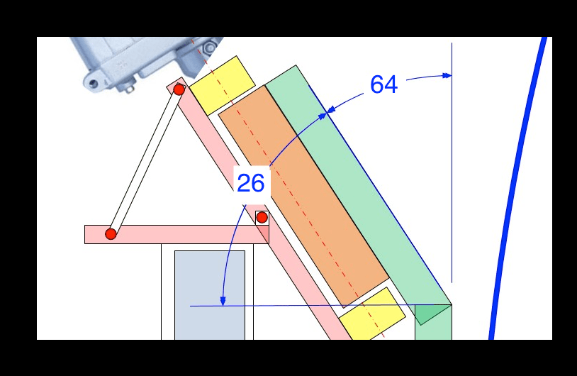

Sorry, analysis paralysis strikes me again!! The diagram makes it much clearer for me. My latitude is 26°, so my '33°' would be ~64°. Correct?

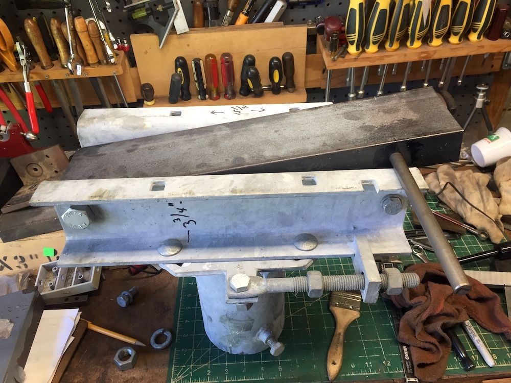

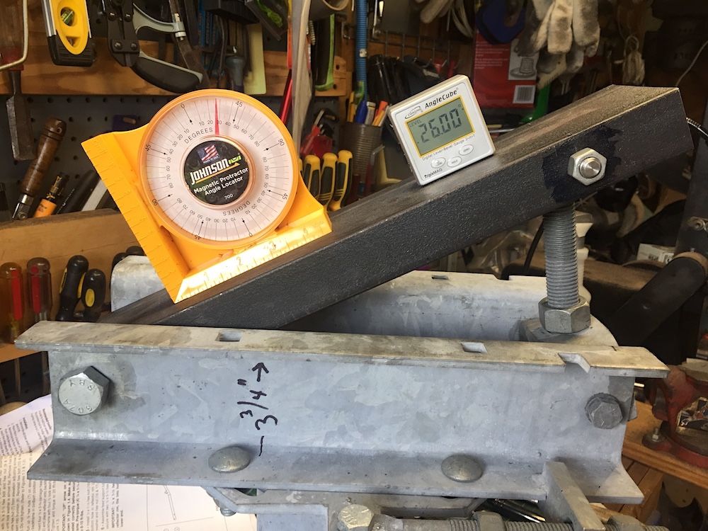

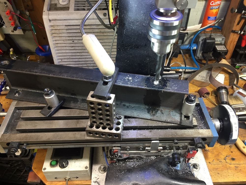

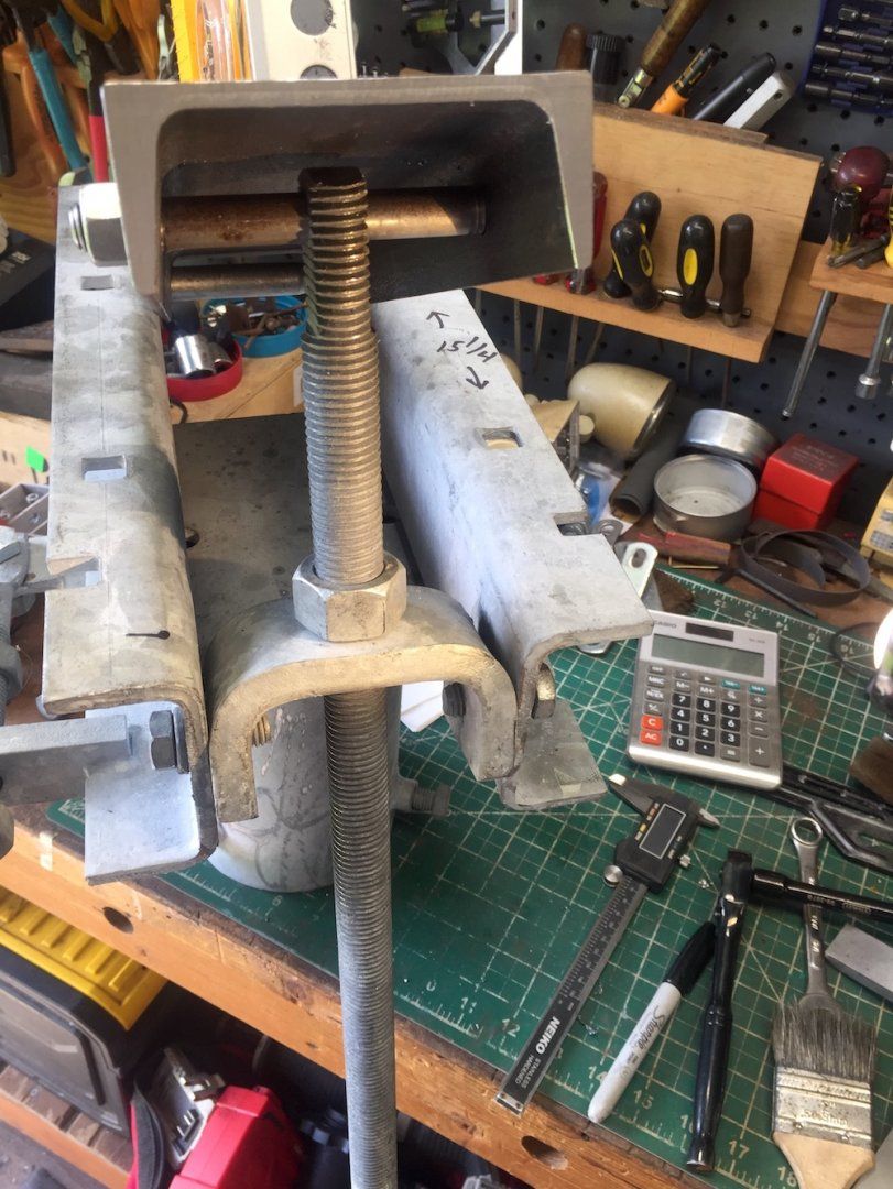

Using some ideas of RimaNTSS and a youtube video I got some work done on the mount for the 1.8 dish. I'm taking my time and trying to minimize wasting any time or metal. I'll post as I go along.
