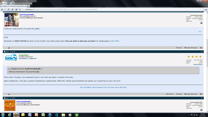

I think you need around 2 for good HD quality.
That's what I thought. I am supposed to get 2, but never get above 1 anytime of the day.
Damn RoadRunner. They give us decent download but upload stinks. With FiOs I will get good download and upload, but I would have to pay a lot more.
