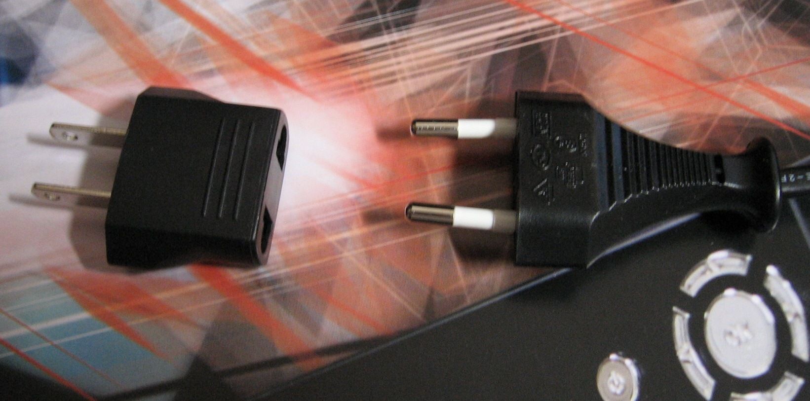

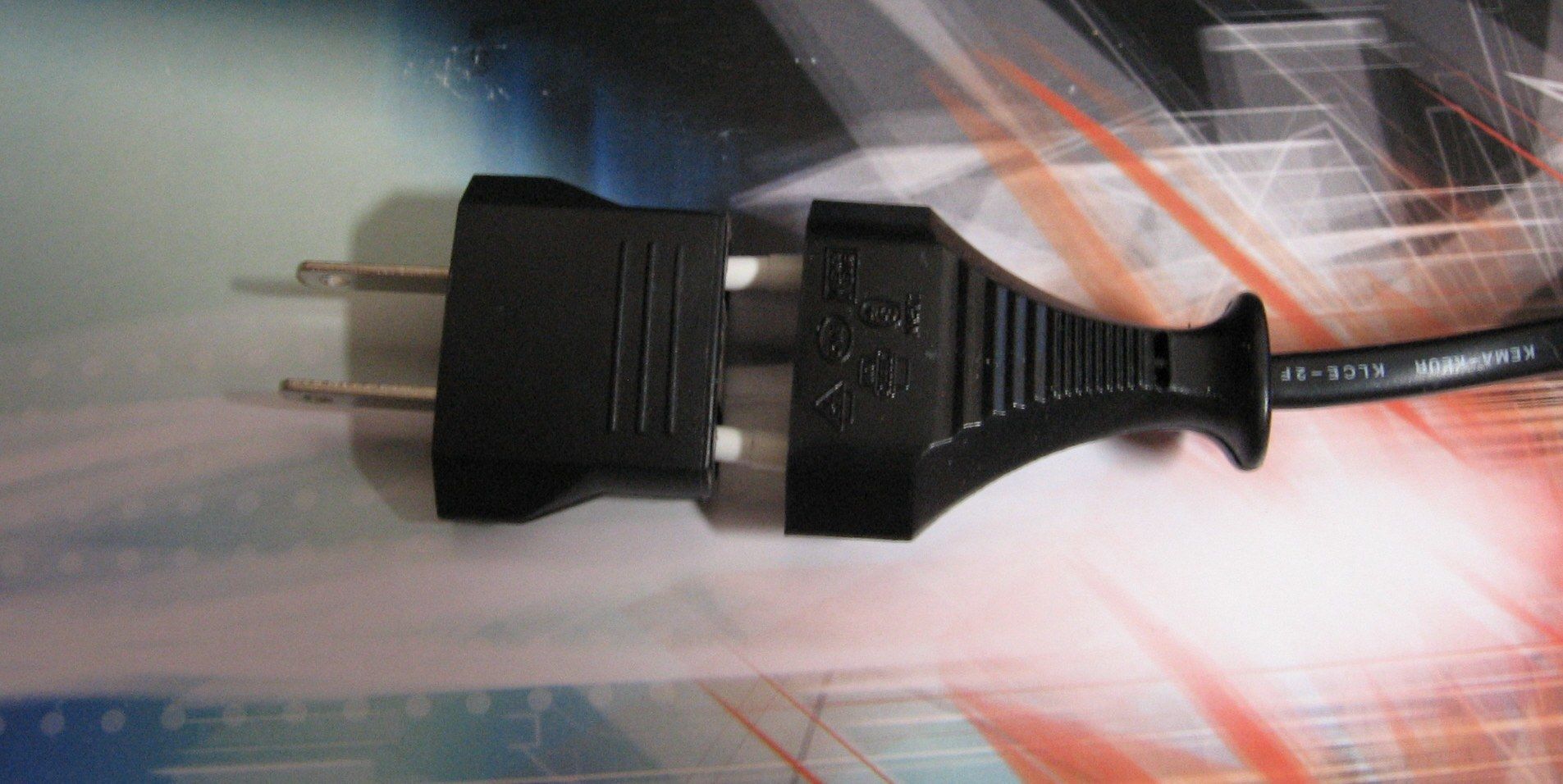

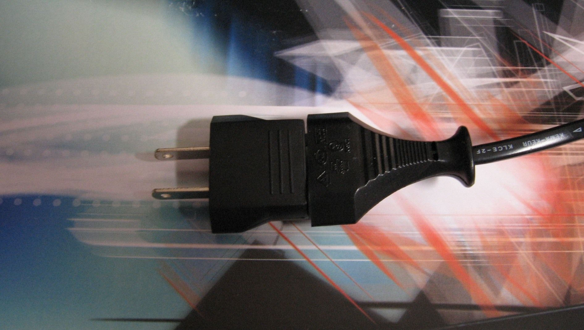

On my Azbox, the euro adapter and power cord would not cooperate without a little adjustment.
When fully inserted, metal on the power cord contacts do not connect with the adapter contacts. Power cord plug contacts are only present on the tip, not along the entire probe.
What I did was to pull the plug out a little until contact was made.
Holly molly !!!!!!!!
Quapoharry that did the trick Thanks a millon
Glad that helped.
Have fun with the Azbox.
My Azbox adapter did the same.
I scavenged a cord from my old Norelco. No adapter needed!
