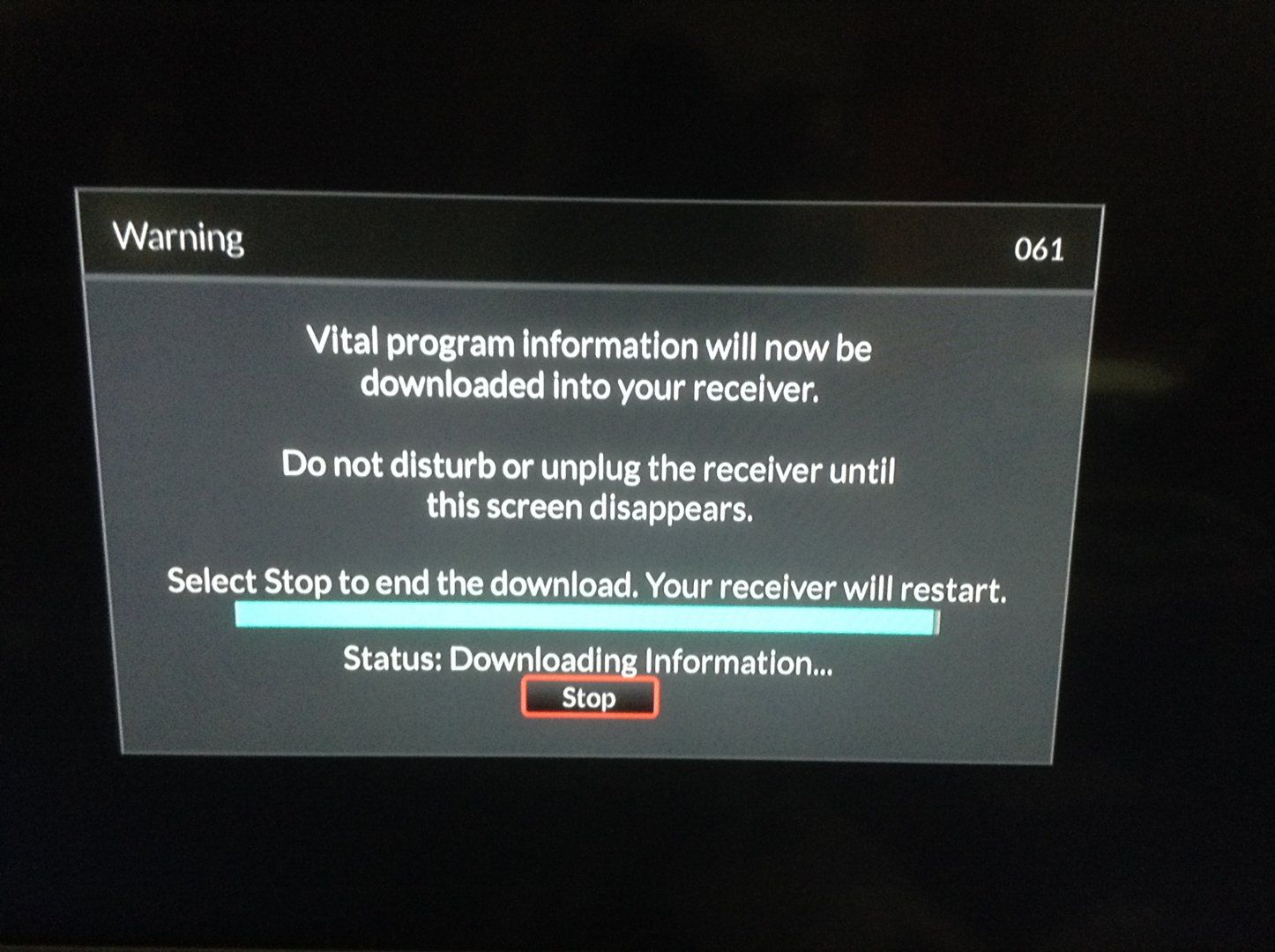

I tried downloading 547 today, but no go.
