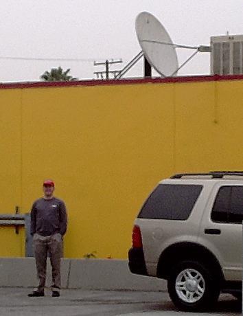

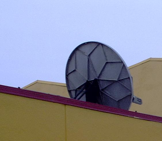

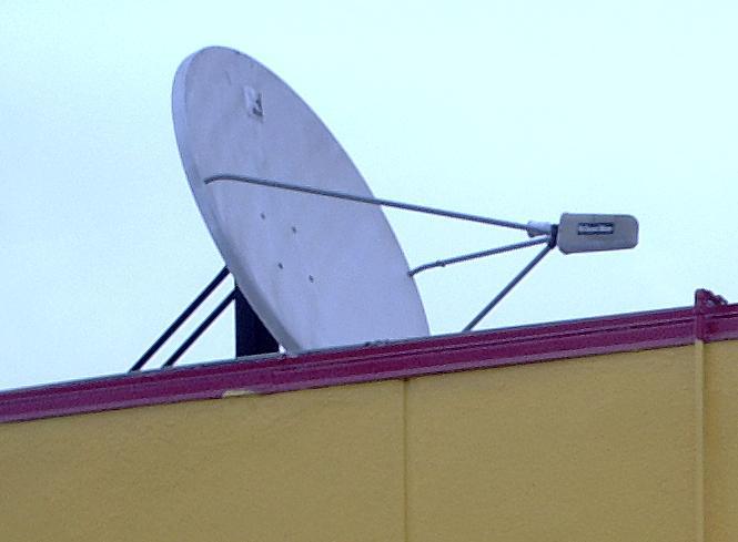

And now as to the #1 most cost effective solution:
The ONLY cost effective way, for the casual user, is a bigger dish. ((I love my CM 1.2's))
He's saying he got a (free) Channel Master / Andrew / Primestar 1.2m dish and no doubt, original feed 'n LNB!
See picture below, and salivate! - :up
