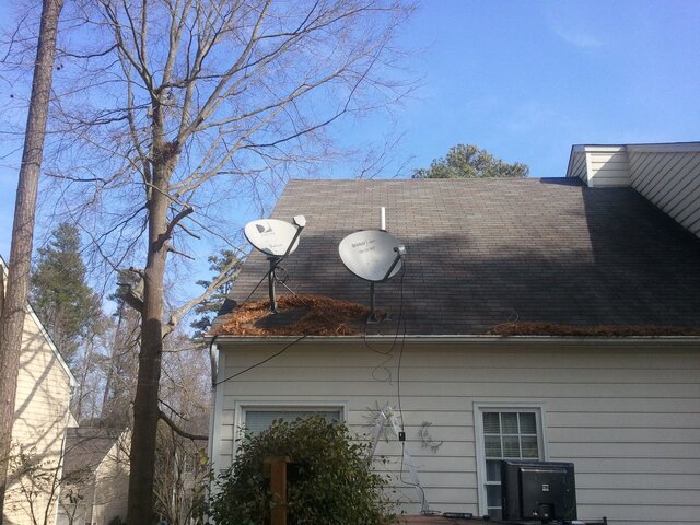

OK it is finally nice here so I am trying to get my Shaw HD channels here in Raleigh, NC I get a 97 signal on channel 252 but 0 on 700 or 300. I have been fooling around with this for 3 hours :(
1. According to dishpointer my skew for Directv should be 62 for my 5 LNB dish and for Shaw it should be 119 if you look in the pics shaw at 119 looks at almost the same angel as my DTV dish ? I have tried moving the skew to what says 160 and slowly moving it back to 120 and still nothing on 300 or 700 just a bunch of red bars at some spots.
Also when I cover SAT A I lose all signal on channel 252 is this is correct ?

OK here is all my info :
1. Receiver is a brand new 600
2. 75CM dish - LNB is a xKu LNBF for use with a 75E dish only
3. Map Status - 551-4323:Complete
4. SignalT1(252):97, (Ecb/No:8.9dB)
5. I covered SAT A and lost signal on channel 252 after pointing the dish
6. I change the channel to 700 signal is 0 same as 350, 300 etc
7. I have messed with the skew, elevation and azmith [even after having a signal strength of 97 on channel 252] trying to get something on any of those channels no joy.
8. I had a guy come out today he charged me 25.00 and did basically nothing saying his signal meter cost 400 and it was not picking up either ANIK sat I told him 107 and 111.

I have done the manual tune thing on a HD channel for hours this is after I get a signal of 97 on a SD channel like 252 or 299! What is the "22khz box should move to "on"" where do I see that?
OK it must be aiming because the winds in Raleigh today were gusting pretty high, I switched over to channel 700 and the signal was all of a sudden coming in between 30-60 and when I tuned to the channel it was coming in and going out, so I need to adjust yet again, thanks for all the help/tips guys.
Yes, just a small tweak either left/right or up /down should yield positive results.
