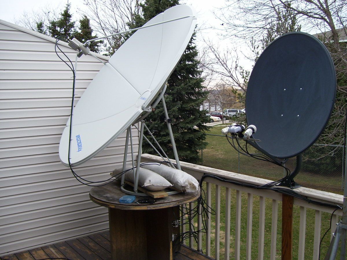

I'm surprised how low on the horizon that the dish is pointed. I even cut a few trees that appeared to be in the way a few hundred yards away (dead anyway), and could cut a couple more (live), but if that's not the problem, I'd rather not.
Its already been noted the KU dishes are offset but here is a good visual difference
(the pic is old but it gets the point across)
The 6 foot dish is aimed at 99W. Here in Minneapolis 99W is at 38 elevation (93 is my true south). The dish is prime focus so 38 degrees elevation is a look of 38 (no offset in it)...The grey dish next to it is aimed at 97W which is also at 38 elevation. Look how "pointed down" it looks compared to the 6 footer
Both are at the same elevation

I love the 6ft C-Band dish mount, it even has attachments for Diseqc switches! Where do I get one??? ;)
where do I get one?
You'll have to contract with the supplier directly: Iceberg Inc.
Those dandy elevators (tables), hold downs (sandbags), and switch arrays are a custom build! - :cool:
Give him your specs and I'm sure he can get you a quote! - :D
Don't forget to specify a desired finish.
all those switches and cabling was rerun and now the switches are indoors :)
But the dish and 140 pounds of sand are still there :)
that dish is fixed on 99W
The other dish (the one that gets wheeled out of the garage) is ghetto moved by hand. The elevation bar get changed by hand :) I have a mark for true south (93W), the far west sats (137/139) and 121. The rest I can visualize where the elevation should be
