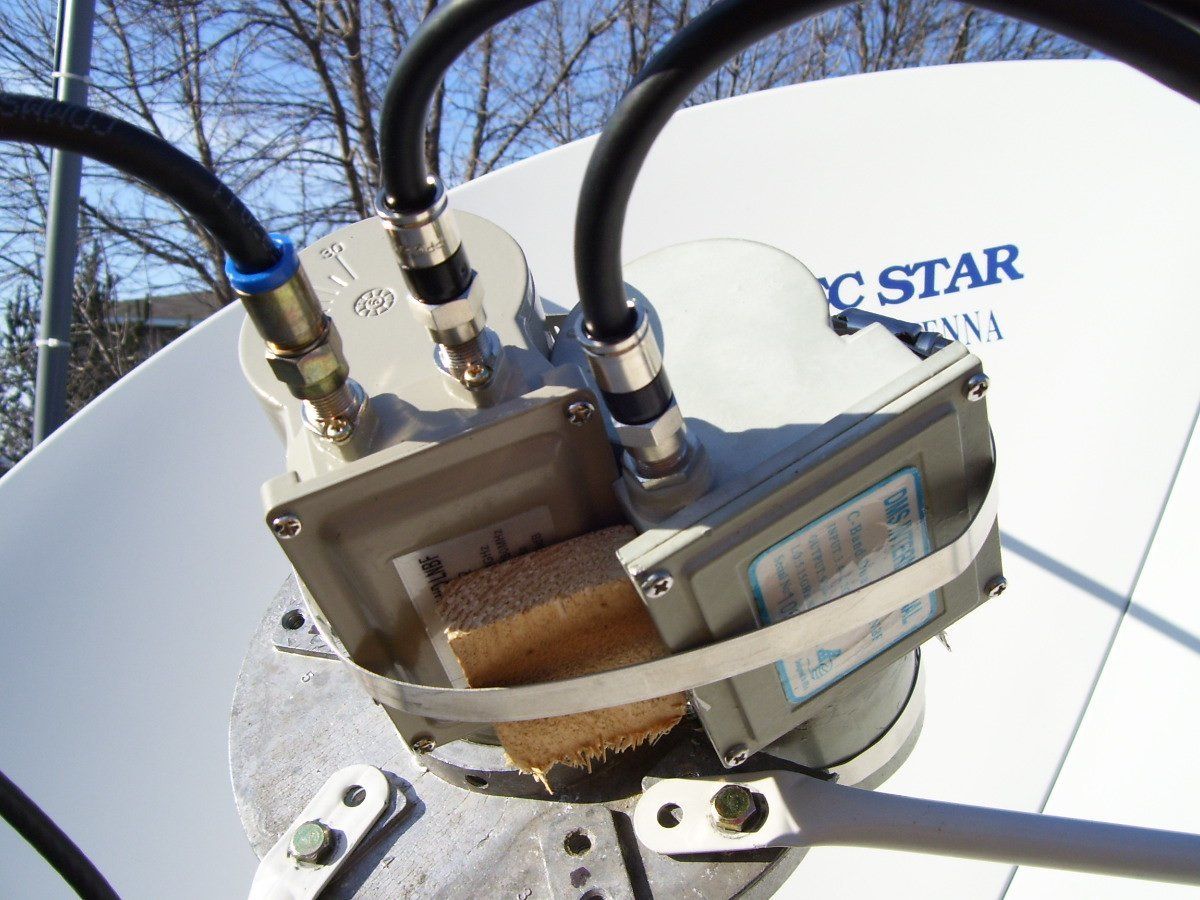

which side do i strap my ku band lnb to my cband prime focus lnb.I am getting some channels but which side will give me better performance. thanks
well then it depends on which side you put it on. If standing in front facing it left side you'd subtract the offset (5-6 degrees) and if on the right you add that
as example in the below pic the LNB on the left is 99, right is 103

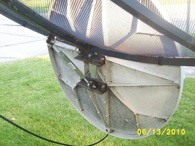

My favorite mod was somebody mounted their ku dish to the bottom of the bud and it magically was correct across the arc
