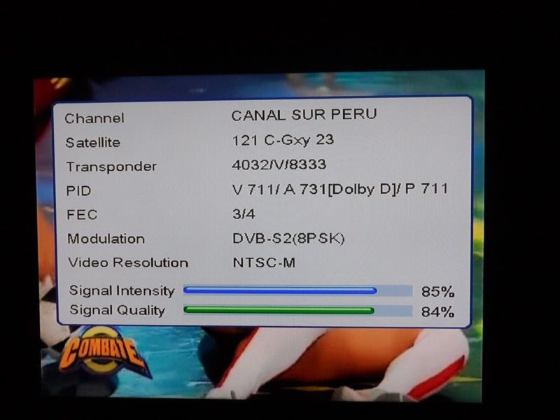

Is anyone receiving Sur Peru and the other 4 channels in the Mux @:
121W 4032 / V / 8333 ???
This Mux was problematic for me on the 7.5 dish,but has been stable on the 10 ft'er until recently.I now see not even a blip there.Maybe it has moved? Things will be a lot more peaceful here at the hacienda if I find it. ;)
Ok,the transponder is still there because I can now get a pixellated mess occasionally.They must have reduced the transmit level for whatever reason.I hope it pumps back up soon. :whip

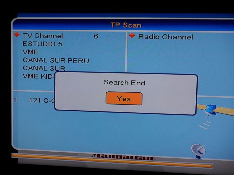

Rescanned with transponder information from above. Hope this helps.
4032 V 8333 :

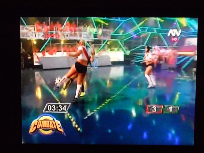

Currently a soccer game...

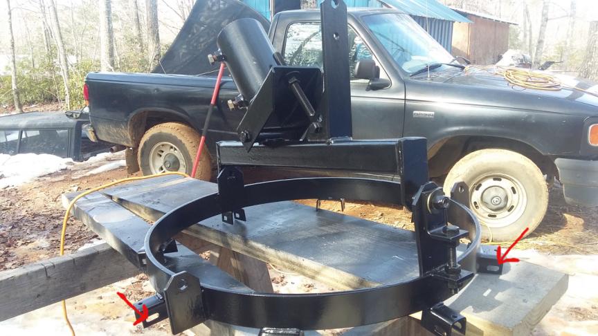

EDIT: Almost forgot...one thing I noticed today.The bolts that hold the parabolic to the mounting ring are slightly smaller than the holes they go thru.(I used identical sized new bolts,but maybe they were not original)There is just enough play to let the parabolic drop down and reduce the signal,especially on the far sides of the arc.I plan to try some slightly larger bolts or wedge something in there to keep it from slipping.
Reactions: Jason S and FTA4PA
Just for clarity: You can see how large the holes are in the photo above.(Red arrows on two) The holes on the parabolic are slightly larger than the bolts as well.It's only like 1/8 inch play at the bolt holes...but that translates out to 3 or 4 INCHES of play at the dish.Makes fine-tuning a challenge.
I had previously used USAL to move my motor and encounter this problem. Although this is quick and easy, I discovered going back to Diseqc 1.2 would fix the problem of fine tunining.
