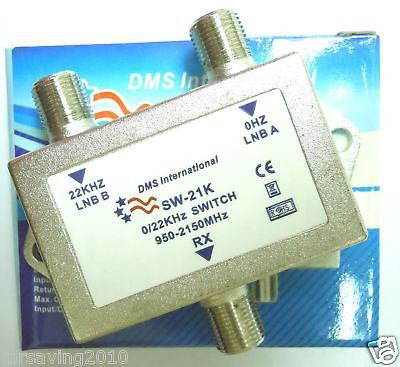

I have 2 geosat 90 I am trying to put together to my microhd. I ordered
thinking this would do it. I get good signal separately with either dish. Only one side let's signal through when I install the sw-21k. I trade sides and still only the one side let's signal through. Is this the wrong kind of switch? If so what do I need?
Are going into your menu and turning on 22K for the lnbf hooked to the B side?
Bring up menu and then go to the install Icon(picture of a dish). Then go to antenna setup. In that menu first at top select the satellite that you have hooked up to the 22k side(b side) of switch. Then go down below that and turn 22k on.
And a big thank you for that. I have been able to turn on a light switch most of my life but this was above my pay grade. Working great. I love satelliteguys for the help people give.
Reactions: KE4EST
Glad I could help! Enjoy!! ;)
